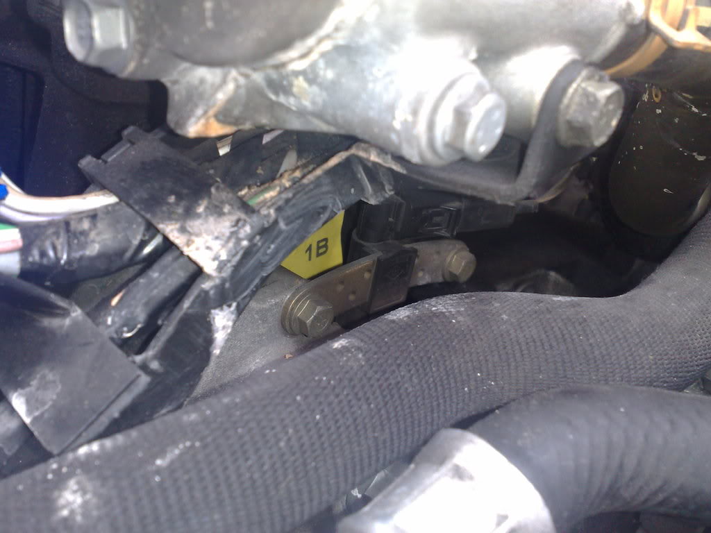

Oh Jonff.... or wizard, where is the crank angle sensor ? could this just be dirty and just requires a clean ? ive being looking and looking for it , no joy ?
If you remove the airbox and look where the flywheel is, it's there just above the flywheel and yeah if it's dirty and gunked up it could cause starting problems.

^^^ crank sensor
  172 SPORT PH2
right, i bloody tried removing that damn thing aswell, i could get off the plastic pipe that leades into the actual airbox, after i took the top lid off etc and removed the filter... any ideas????
and when i do get to it, how would i go across cleaning it ? just a case of getting a cloth and just wipeing it down ??? cause on that pic i cant work out where abouts the sensor is ?
When I removed mine I just used a long 10mm socket and an extension bar, it's fiddley but it shouldn't be to difficult and i cleaned mine with a rag and WD40

hopefully it will be this, if i disconnect this, it wont cause the car to not function right will it , do you recon i should just get a garage to sort it ?
