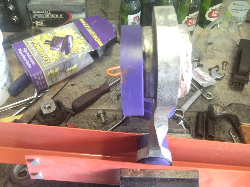

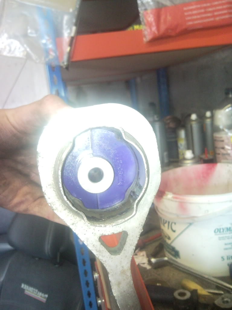

Do these look right to you guys who have poly bushes in your dogbone?
i didnt leave them like that as that was a trial fit, but seem they should be on the straight type mounts hmm,
that collar / lip bit thats shown in the pic between the new bush and the mount needs to come out. i got that far about 6 month ago and got confused. stopped to ask on here and never got any further.
without the collar the new bush should go through that hole in think and "become one" with the new bush from the other side.
Ahh should of asked here before doing it, would have made removing the old one much easier lol,
whats the best way to get rid ov it? hacksaw ye?
no probs, everyone helped me when i got stuck.
only wish i had time to get another go at it! post back up in here when you get it done, let me know how easy it was.
ye will do,
iv allready done the small one, pieve ov piss tbh, just hacksaw the rubber on the small part then wack it out with a hammer :)
