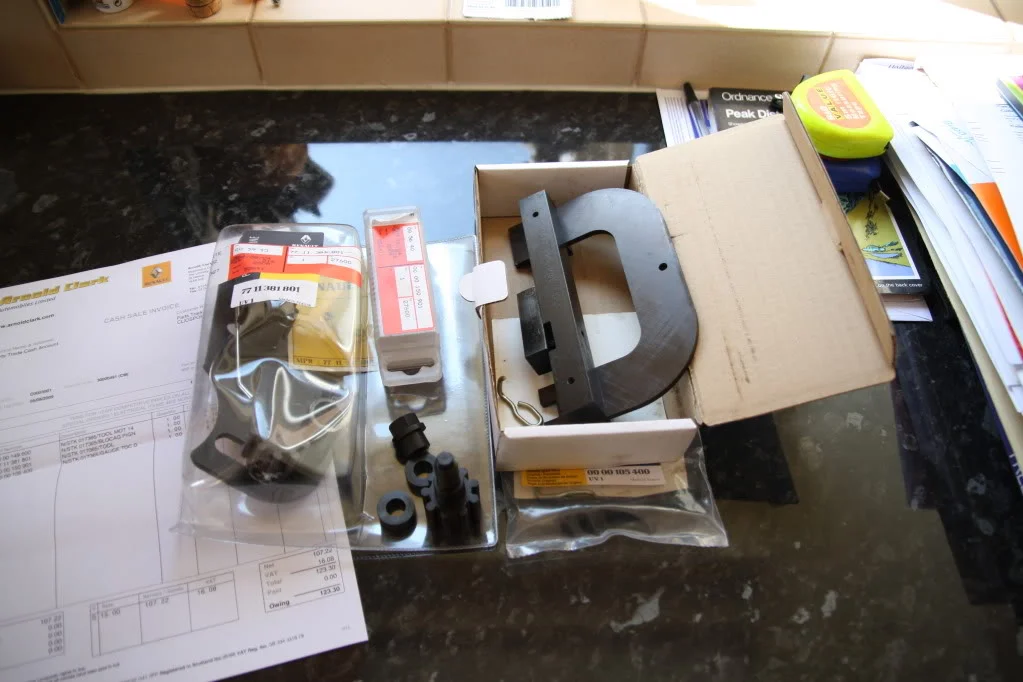

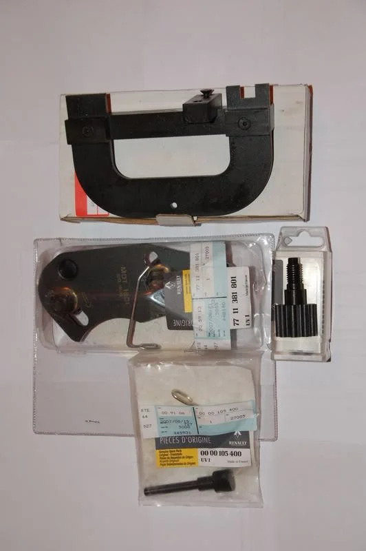

For reference...
TDC/Crank Pin - 0000105400 - £8.98
Extra Longer Cog + Spacers + Nut - 0000150901 - £16.56
Camshaft Locking Tool - 0000149600 - £40.50
Pulley Locking Tool - 7711381801 - £40.50

Yup defo the right one, same as the one I lent off fred a while back...
Picked them up today, used it on my engine earlier, worked spot on :)
