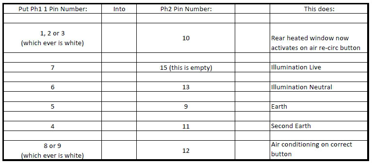

I've done mine with that heater control and it works fine, there is a guide to do this in the guides section, probably worth taking a look at that as it explains how to wire it all up
Allright perfect :D
But the rear window heating problem must still be adressed as the guide only covers how to rewire them so the unlocking/locking function works with the heater button.
As i never use the lock/unlock button anyway id rather keep the rear window heating button to do what its for ;)
