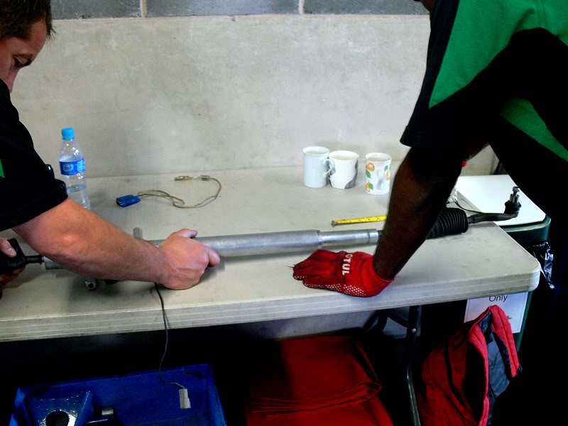

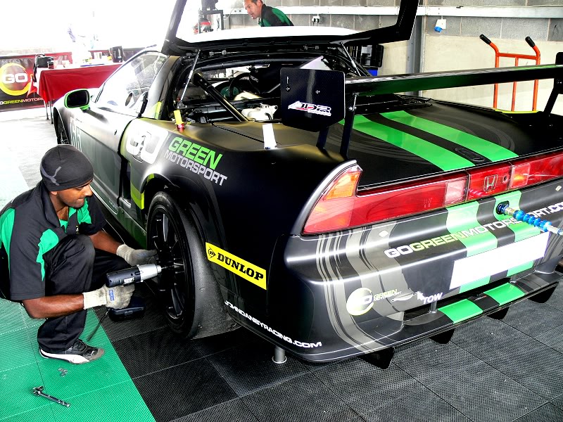

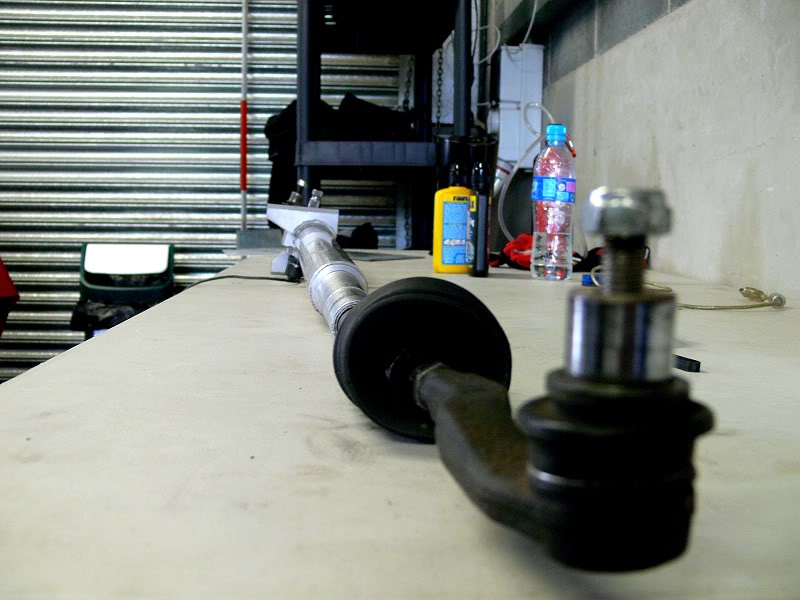

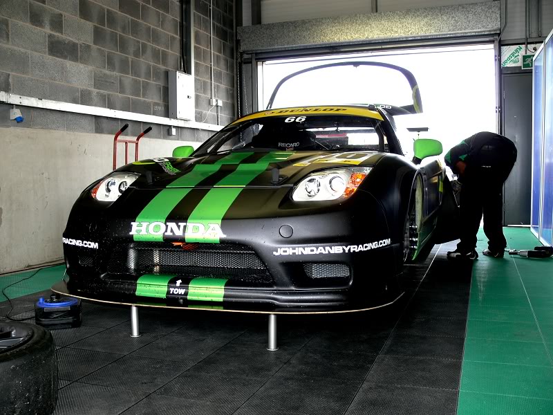

After letting the other Rob go out in the first session, there were issues with steering. Despite having 'race' power steering, it was providing next to no assistance and also the steering wheel was about a quarter turn to the right instead of dead-ahead. In my session, i found it was a very physical car to drive. I was getting tired after a few laps! However, it was nice to have a bit of extra poke after the Elise, and the seating position was ace!

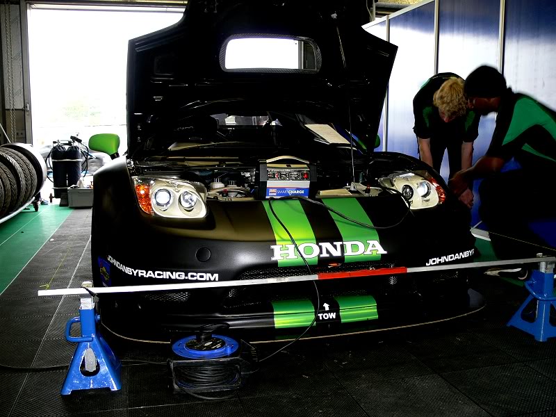

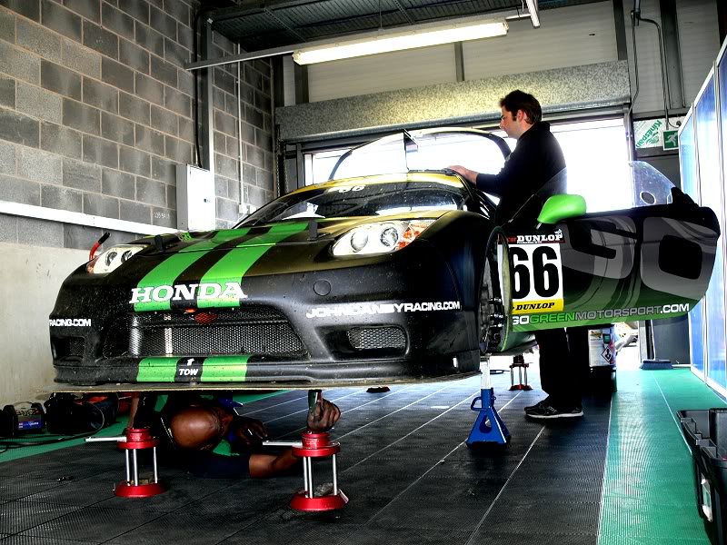

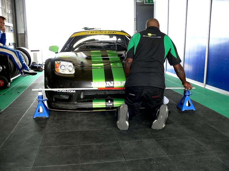

The car got stringed up, to see if the geometry was out to cause the steering issue.
In the meantime, i checked out what else was on track.
Forgot Donny was right next to an airport too!
Strangely, the toe angle was way out on the front wheels. You can't exactly just take the steering rack out, so the guys had a look around but couldn't see anything obvious. So we finished the day with dodgy steering, albeit with the power steering much improved thanks to some mapping work. We also ran without the airbox, as the car seemed a bit slow.

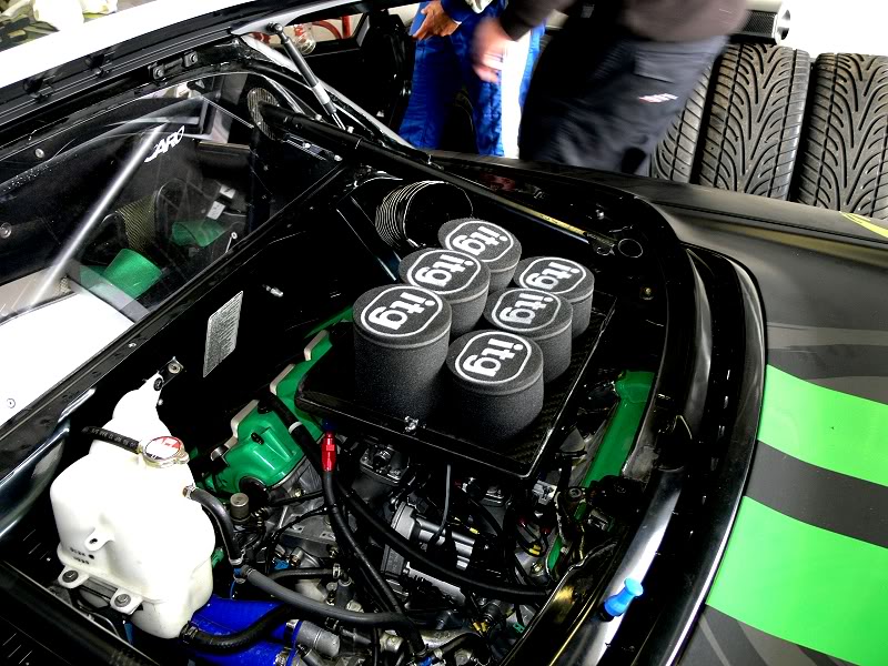

In the morning, we found out the butterflies were only opening about 80%, which is why the car felt slow! This was then fixed, and the boys also took out the steering rack to find it was falling apart.

Overnight, the boys rebuilt and reinforced the rack for the race.

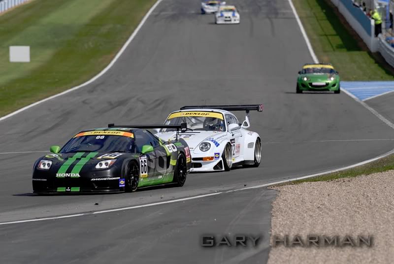

The marshalls, god bless them, cocked up and i was in the wrong grid position. On the green flag lap, i cheekily overtook a couple of people to get to the right place!
I got a great start. A crash up front caused people to be a bit nervous, so i grabbed a couple of positions.
I also found some killer lines...
This was my first race of the season in slicks, and it took me a few laps to accept they needed warming up! Fortunately, being quite a long wheel base, slides were easy to manage.

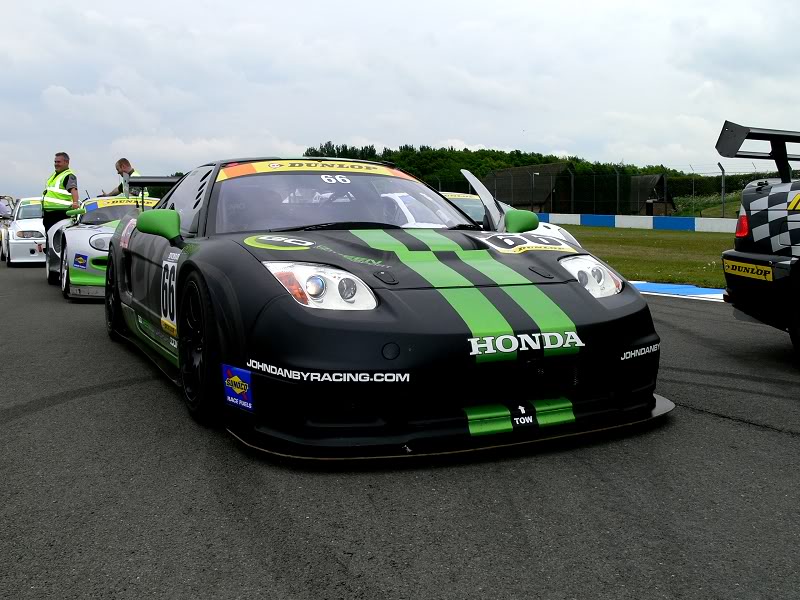

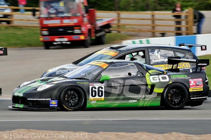

20 minutes in, i was getting pretty knackered. The power steering didn't seem to be doing its job and now the steering was pointing left. I had found a consistent pace though, so was OK. That is until suddenly the car made a massive clunking noise...and i lost drive. It sounded exactly like when the driveshaft fell out of the Elise at Silverstone. I crawled back to the pits, jumping out when i saw smoke.
The diagnosis? A little alu spacer on the driveshaft got hot, releasing the driveshaft out, through the exhaust (hot grease got set alight in the process). It was actually minimal damage really, but of course there's not much you can do with one-wheel drive!

Love how the boys just rebuilt the rack overnight!
I can't even get some suppliers to do that for me!

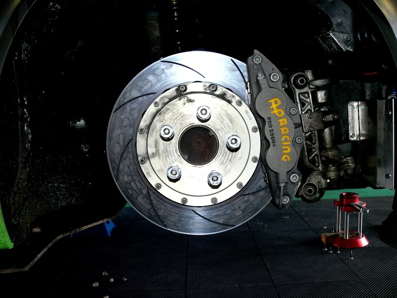

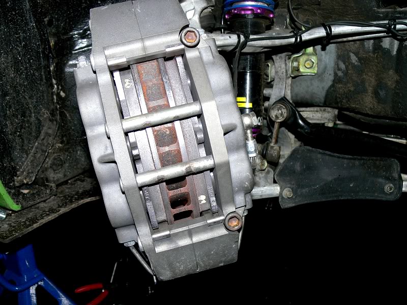

discs look abused too lol!
