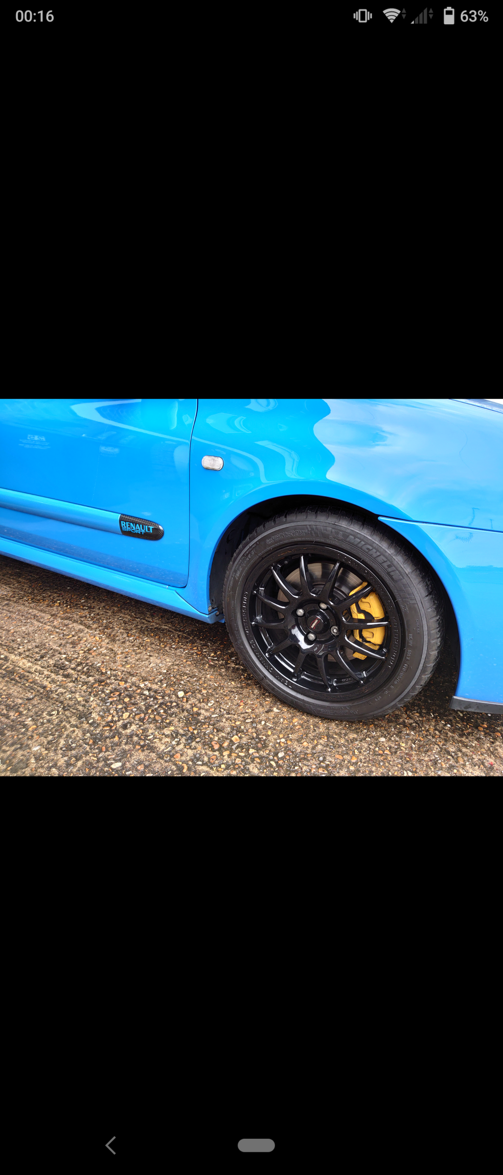

Door bullet mod
Simon1975
  Clio 182 Cup/Meg R26

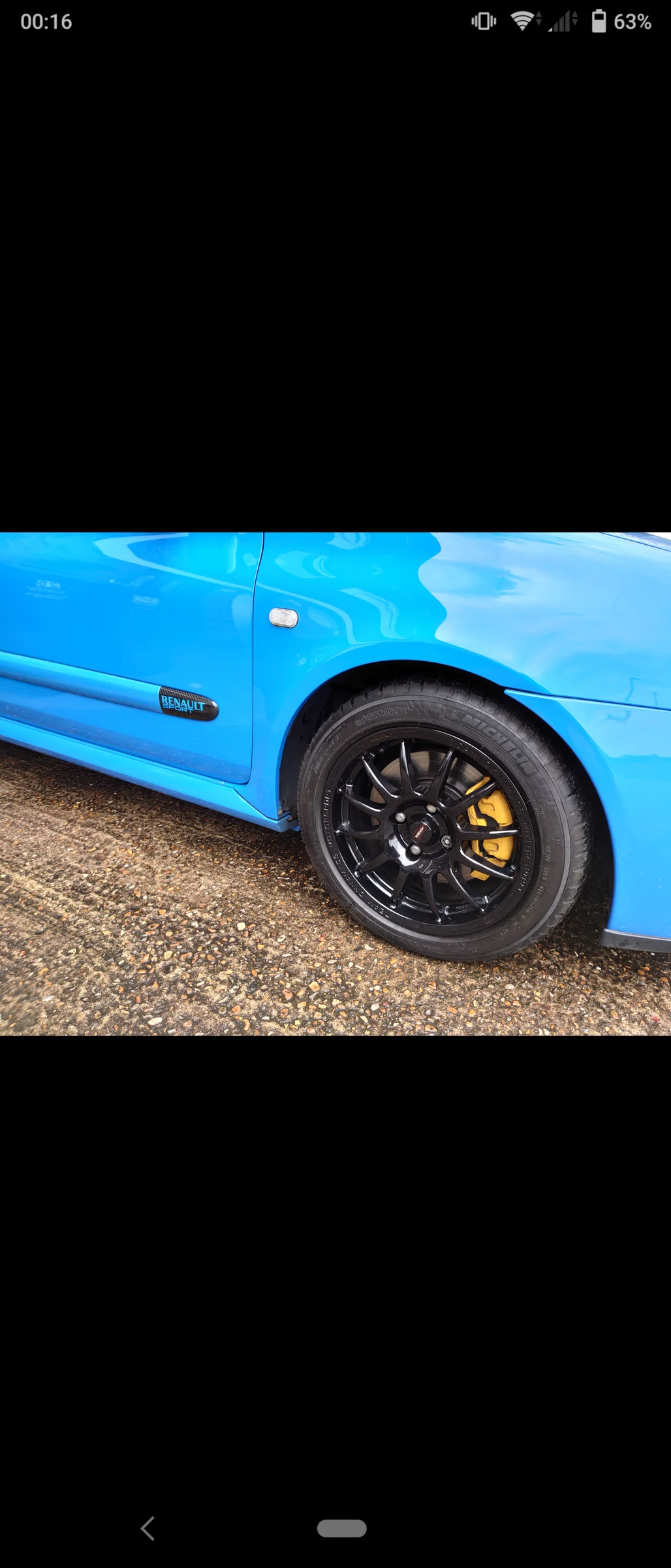

Got mine from Carbon Skins on Facebook

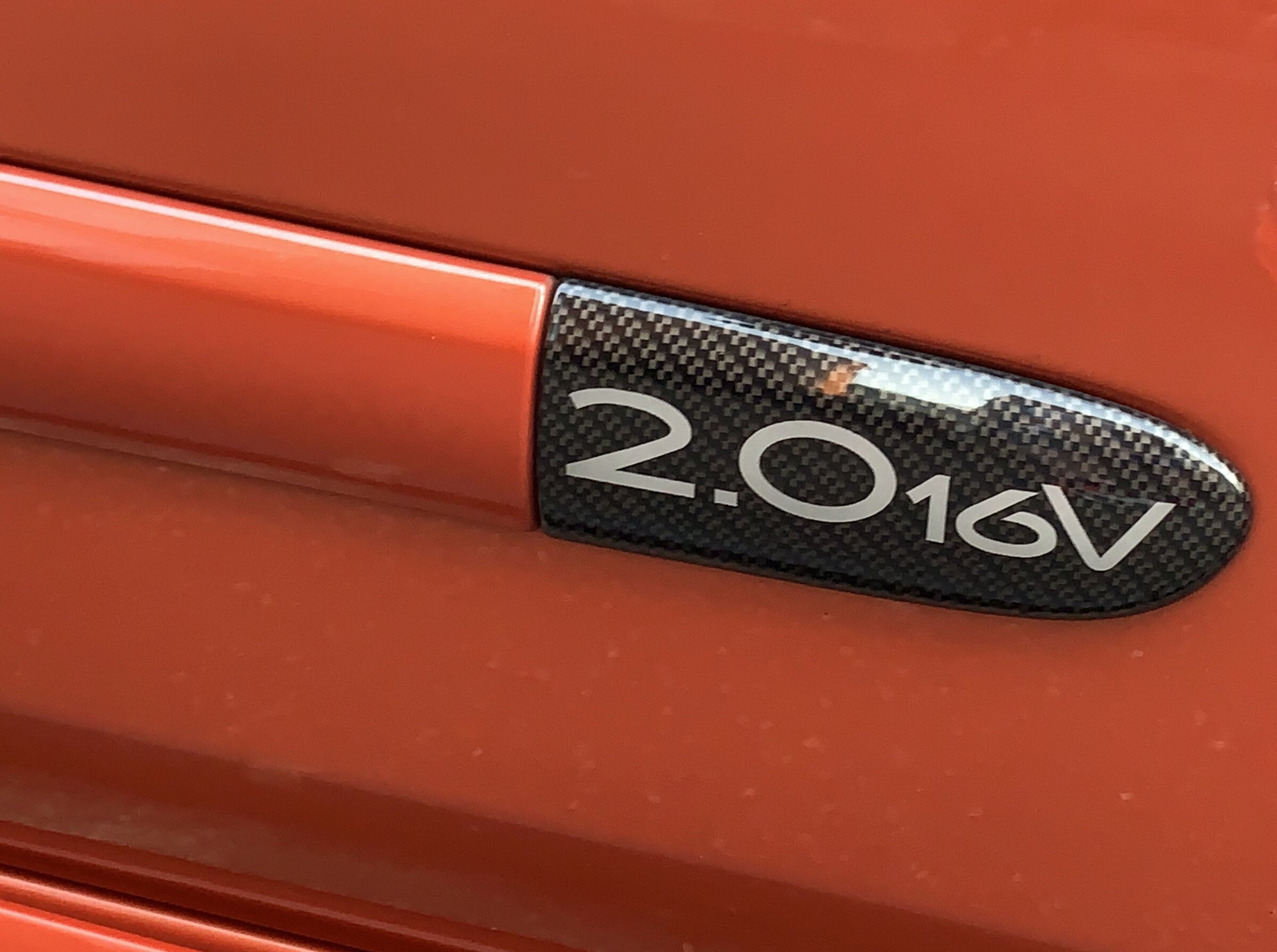

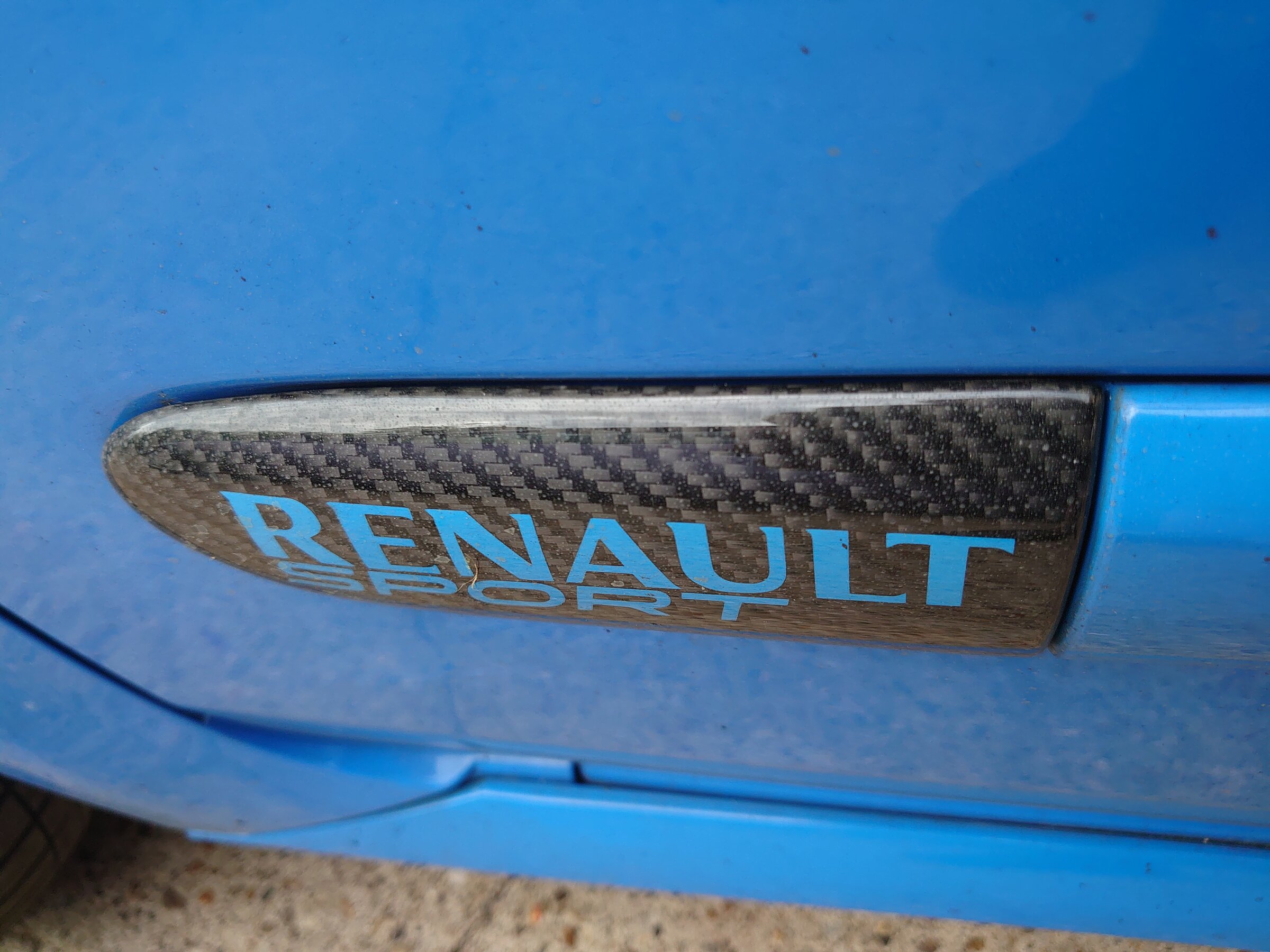

Close up pic. I'm not sure how he does them they fit spot on

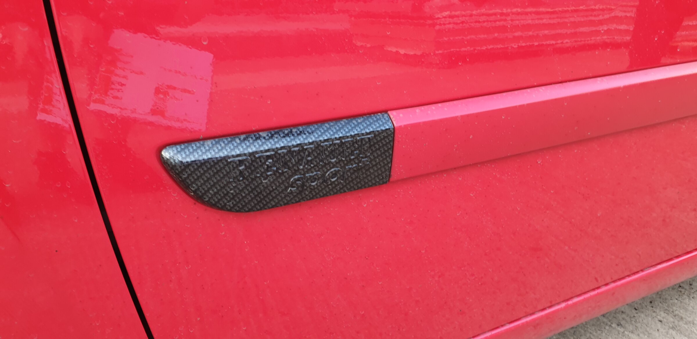

Krarl
I have genuine carbon skinned ones on my megane, they're tiger sealed on because they're about £100 a pop if you can get your hands on some 😂
Excuse the water drips and marks, its no show car
Krarl
Yeah I'm sure they take a standard bullet, make a mould of sorts and then skin the carbon fibre into it
The lettering on these is way too "standard looking" to look as though they've laid carbon over an original, unless they're using very thin carbon on the face and then bulk the back out to reinforce it. No they're not dipped either, the back of them is raw carbon and resin like my washer blanks

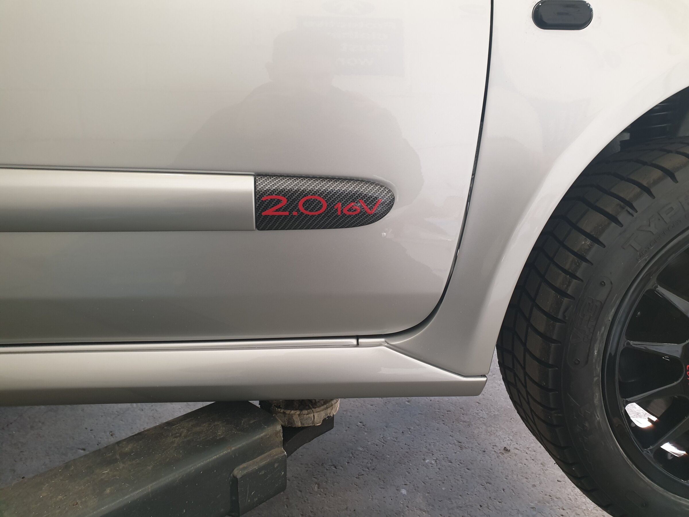

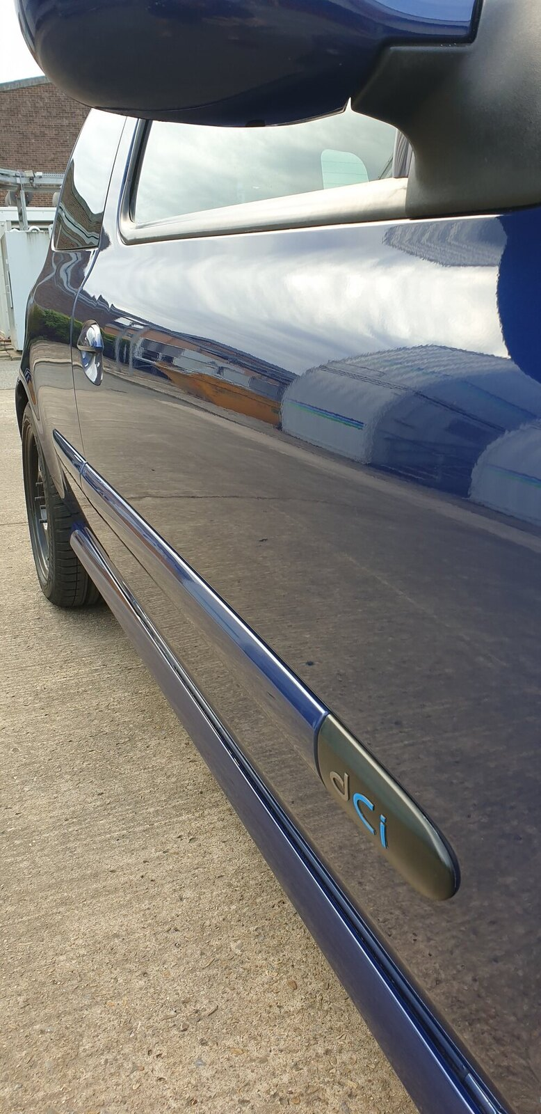

Thought I should actually take some pictures with them on the car!

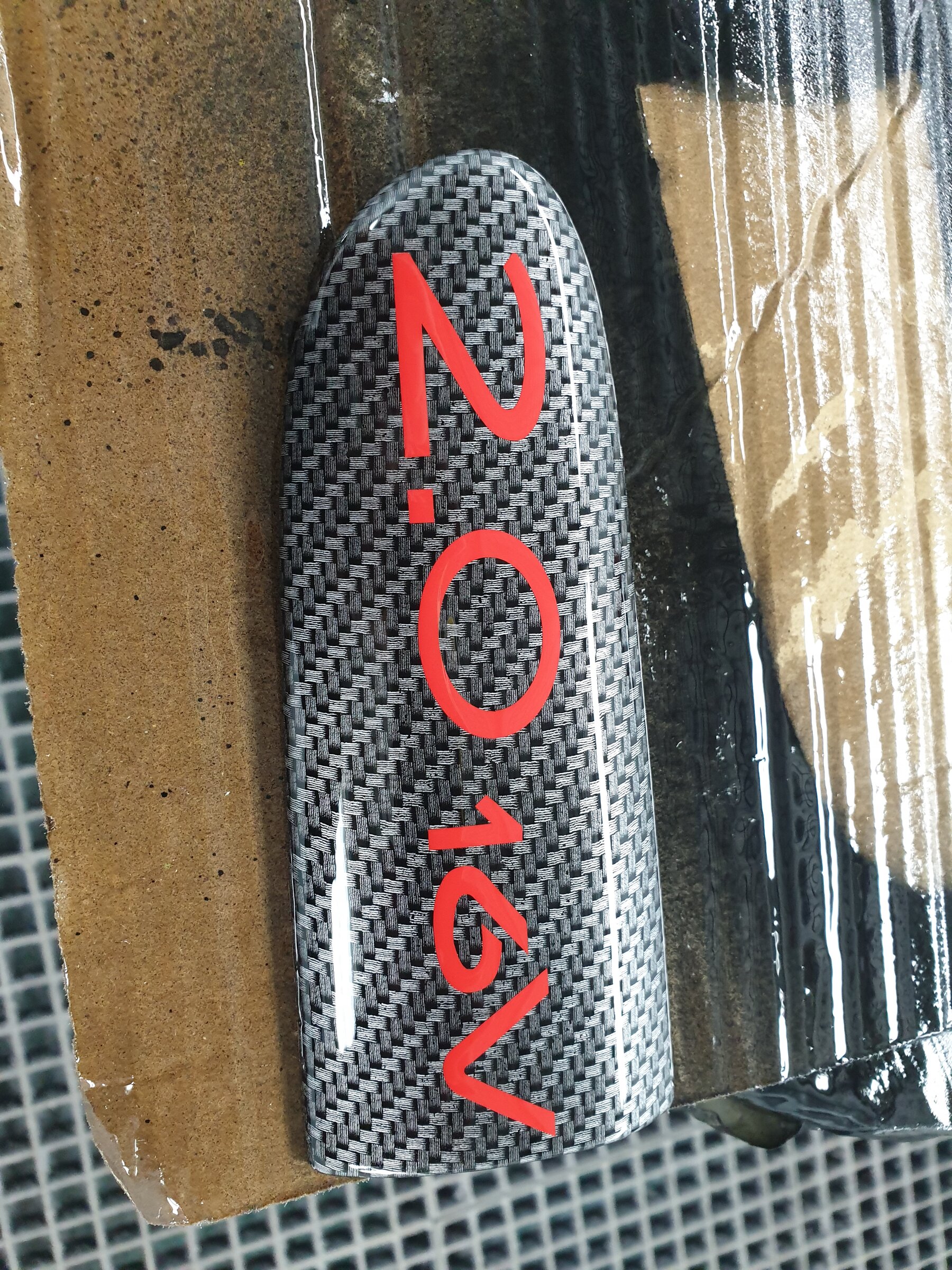

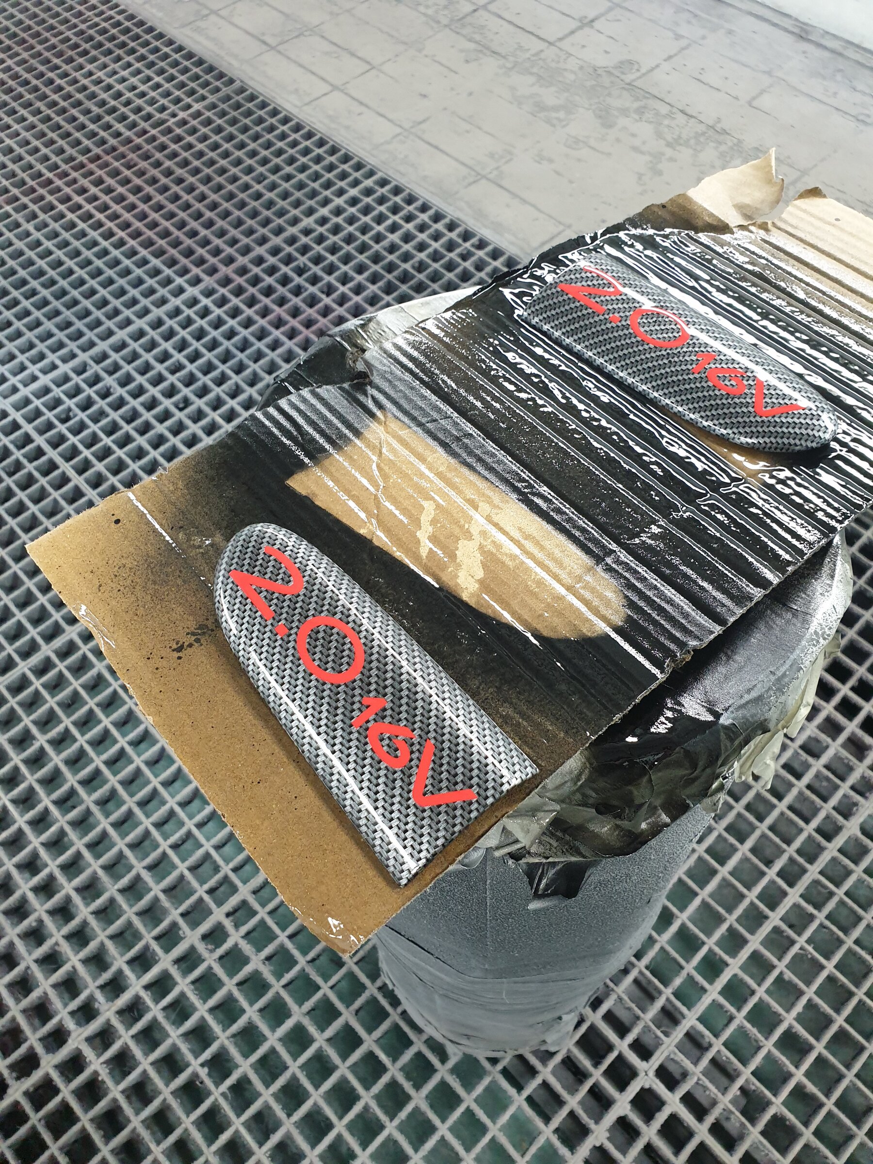

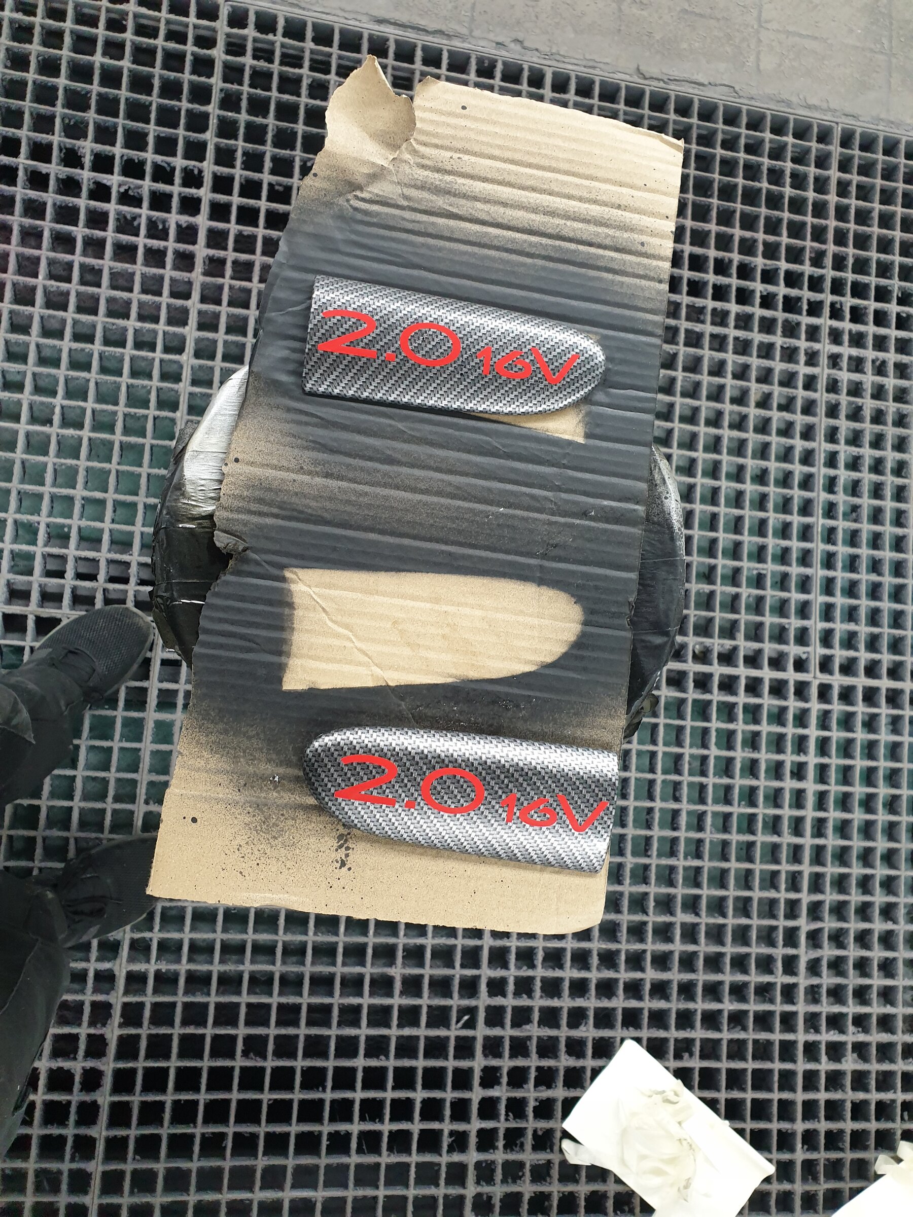

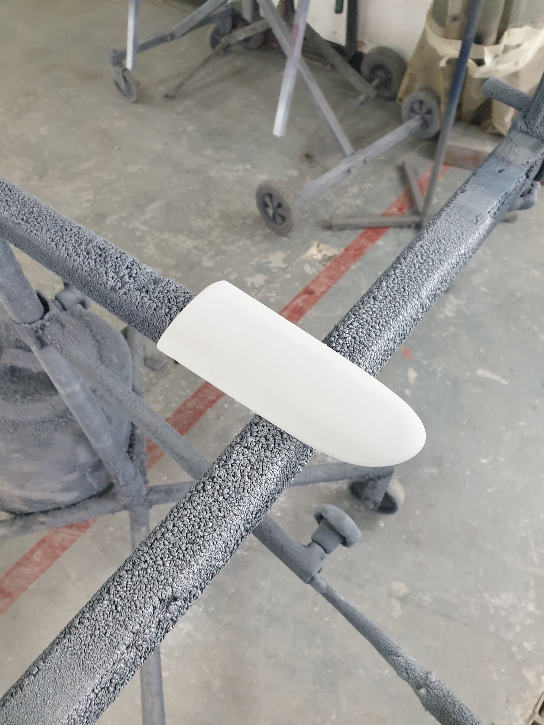

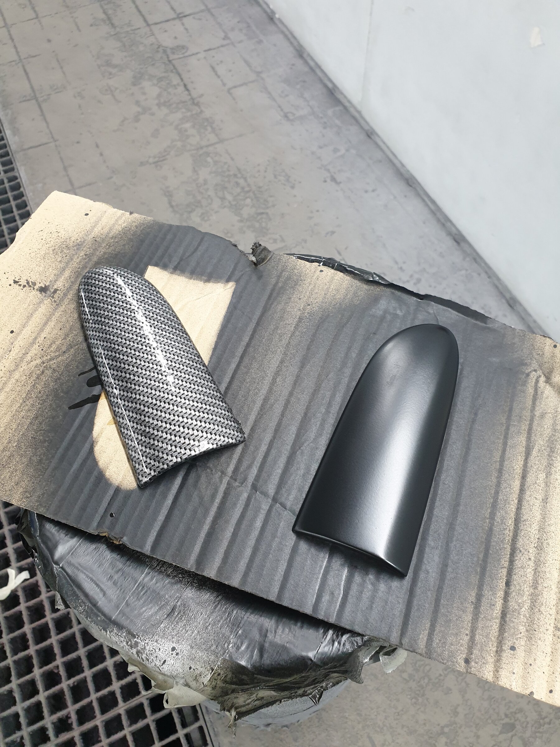

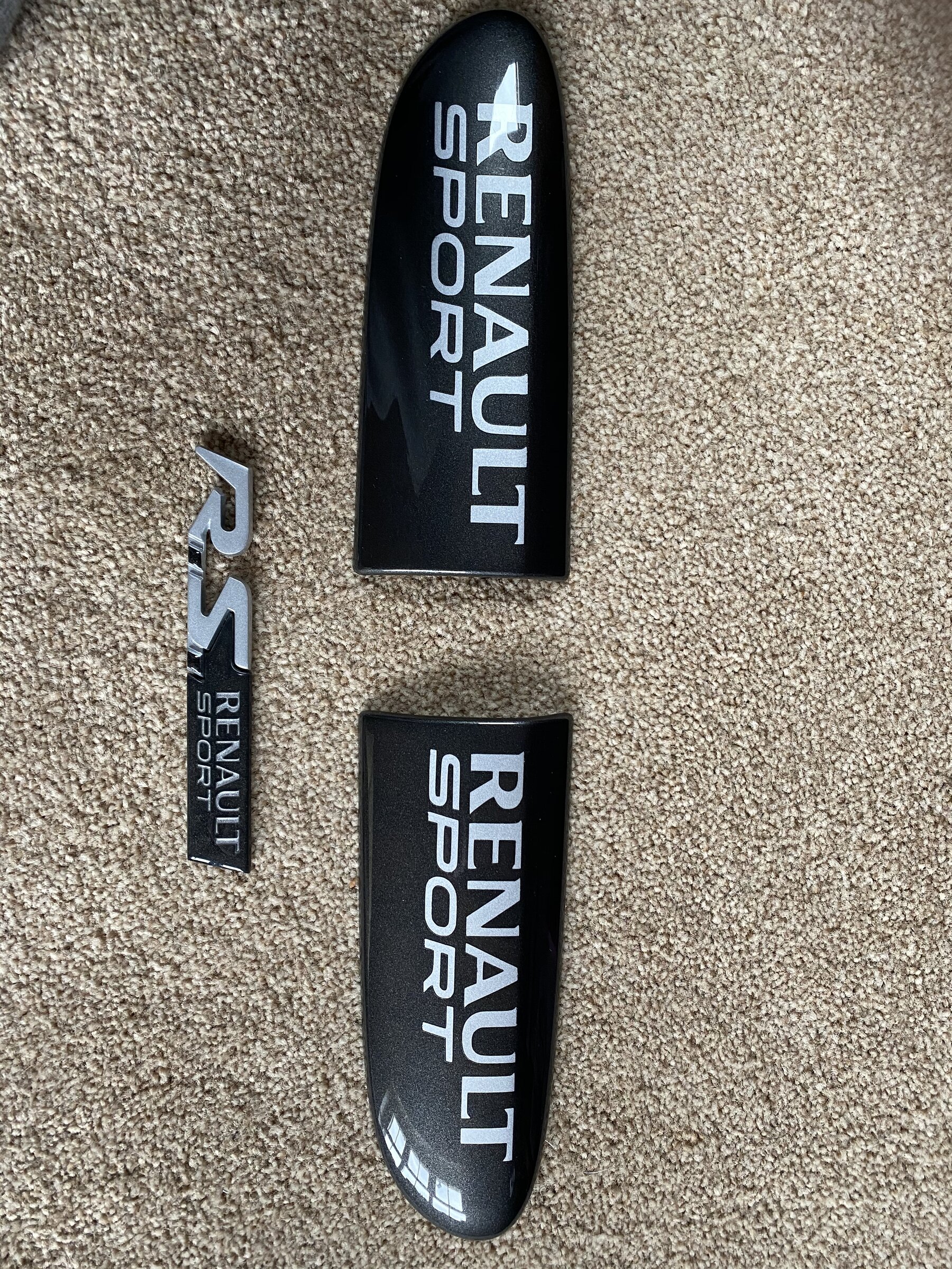

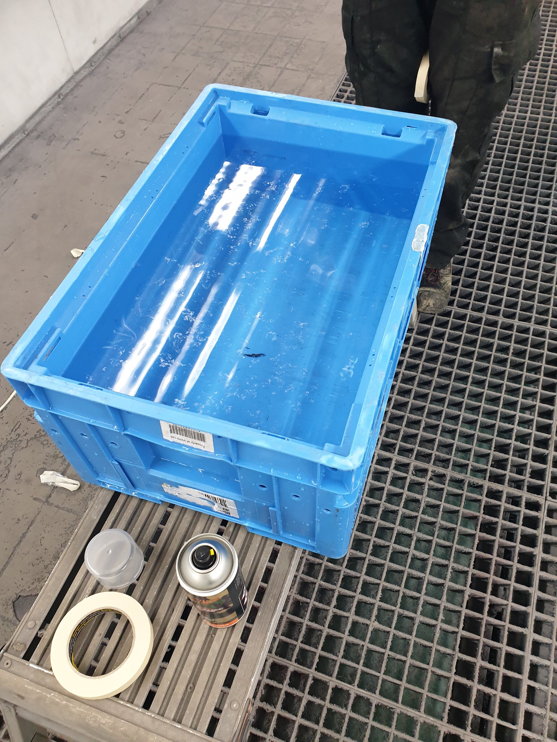

Ok so...
I've had a go.

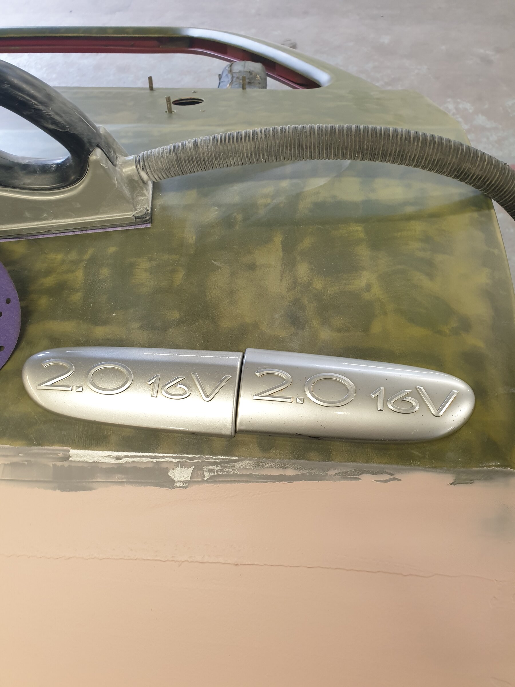

Started with the standard bullets
I removed the raised lettering with the DA sander starting with 80grit, 180, 240.
Quick scrub with a grey sctoch brite and cleaned them up.
Used adhesion promoter and then black primer. Wet and dry p800 with water to prep the surfaces so they are smooth and then coloured them up with satin black.
Cleaned a parts box out thoroughly and filled with clean water.
Ensuring theres no dust or bits floating on top of the water lay the film on the water shiney side down.
Leave for a minute to settle.
Spray the activator over the film and wait 30 seconds.
Dip your part slowly into the film at a 20°ish angle until fully submerged.
Shake the part to clear the rest of the film from the surface of the water.
Remove the part.
Next you need to wash the parts off with water, theres a slimy substance left on.
Once clean, dry them off.
At this stage I put my decals on.
Then I used our BMW clear to finish them off. Turned out nice.
Not 100% on the carbon colour being silvery but I think I might experiment with a few more including candy red carbon.
What do you guys think?
