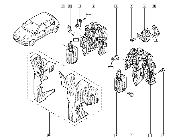

Does anyone know the part number or where to get the door lock bolts from?
When I open my door I have one that is rusty and I would like to get new ones. There are two on each door holding on the clasp for the door lock next to the striker when you close the door.
Guessing Number 3 or 7 ?
Perfect thanks for that. Its number 3 but there are two screws.
Where did you get the diagram from I used to use one like this for the BMW's and the Audi's I had but never came across one for the Clio. Thanks for the advice on the plating.
I have access to the Renault Parts System & Vehicle Information.
Screw CBLX 6x13.5 - 7703006229 £1.85+vat (Item Number 3)
