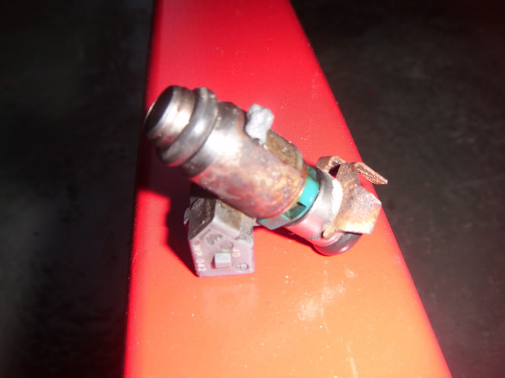

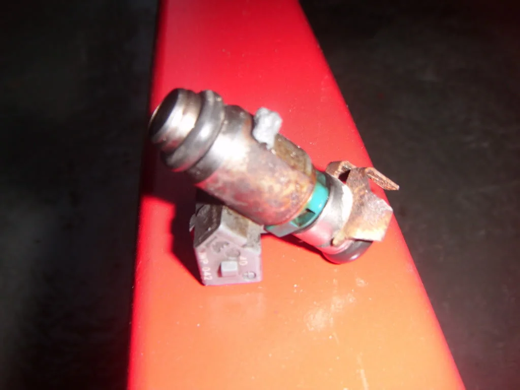

Removed all the injectors and gave them a flush through with injector cleaner. Injectors 1, 2 and 4 were fine and sprayed well but when no 3 was getting cleaned it started to sizzle slightly and then this happened:
Looks like I need a new injector then. When putting some voltage to open the coil in each injector, 3 sounded the same but injector no. 3 seemed to warm up a lot more than the others so looks to me that it was the solenoid of the injector rather than just being blocked with carbon or whatever that caused the issue.
Thanks again for the advice!
