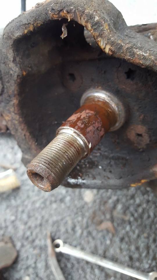

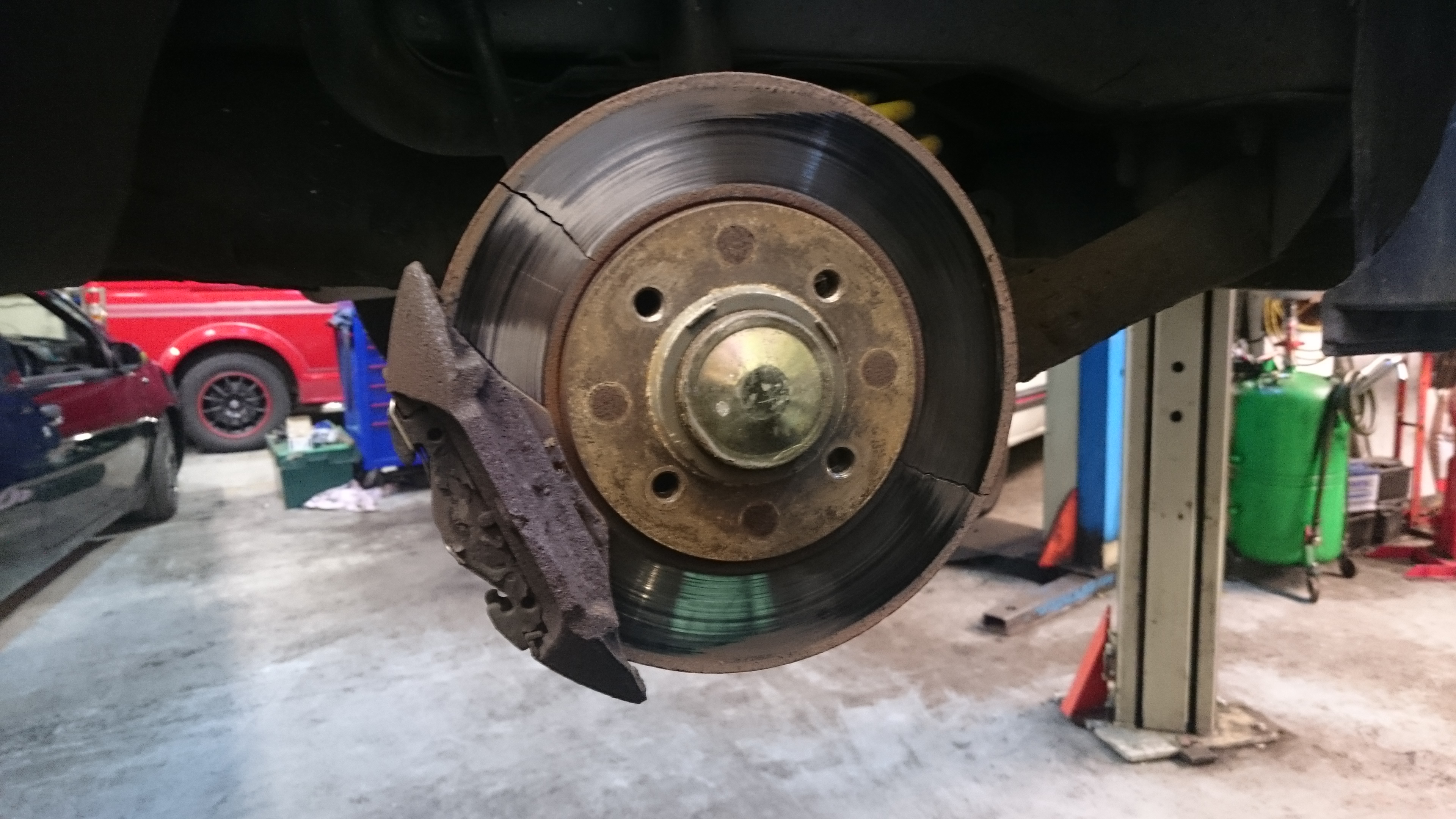

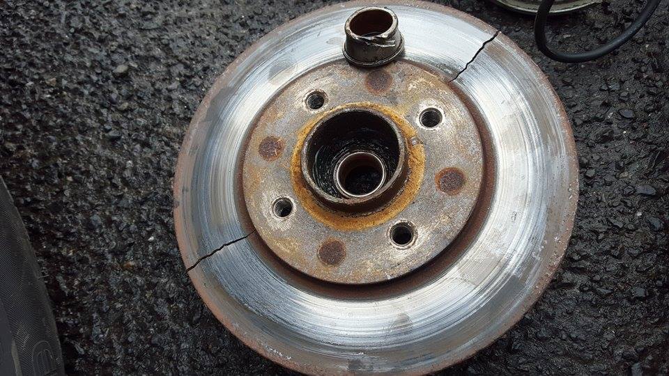

Mechanics just sent me these haha, nearly cracked all the way if it carried on and seems like the shaft is pretty war torn:
  Pearl Black Clio 172
Apparently the caliper is relatively unscathed and appears to be in 'ok' condition itself, but in a month or two ill get fresh calipers (the handbrake cables already been done, maybe they didnt spot this?).
