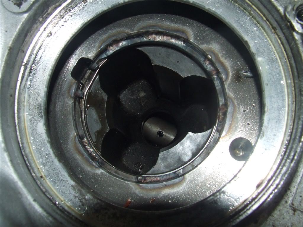

I take of the driveshaft to look for the problem. On the left side is a clip and under it a ring. When the clip fails, the ring broke. How can I find a ring to replace it?
I replace the circlip and ring. The ring was broken, but sadly a small part goes into the box and I think it does smash a teeth. That is why when leaving the throttle it sound like a rattle. I found the small broken part in the oil, but it was half of the original size:)). So...a new gearbox, right?

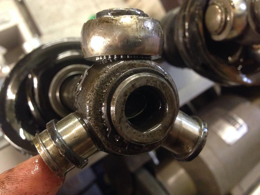

Which circlip do you mean?
The one from last picture. Not the Clip one which use a tool to put in place, the O one. I left with just the circle and the little tab goes into gearbox.
The O was broke and the tap goes into box and the C left into the boot, but the Circlip stays in place, just a little bend, but was there and the tripod did not come off.

The missing piece was in the box and when I drain the oil I found it, well, half of it. So it was a sign that some teeth from the box are damaged. I can hear them when releasing the throttle. Sorry, but my english is not so good and did not know lots of mechanical terms.

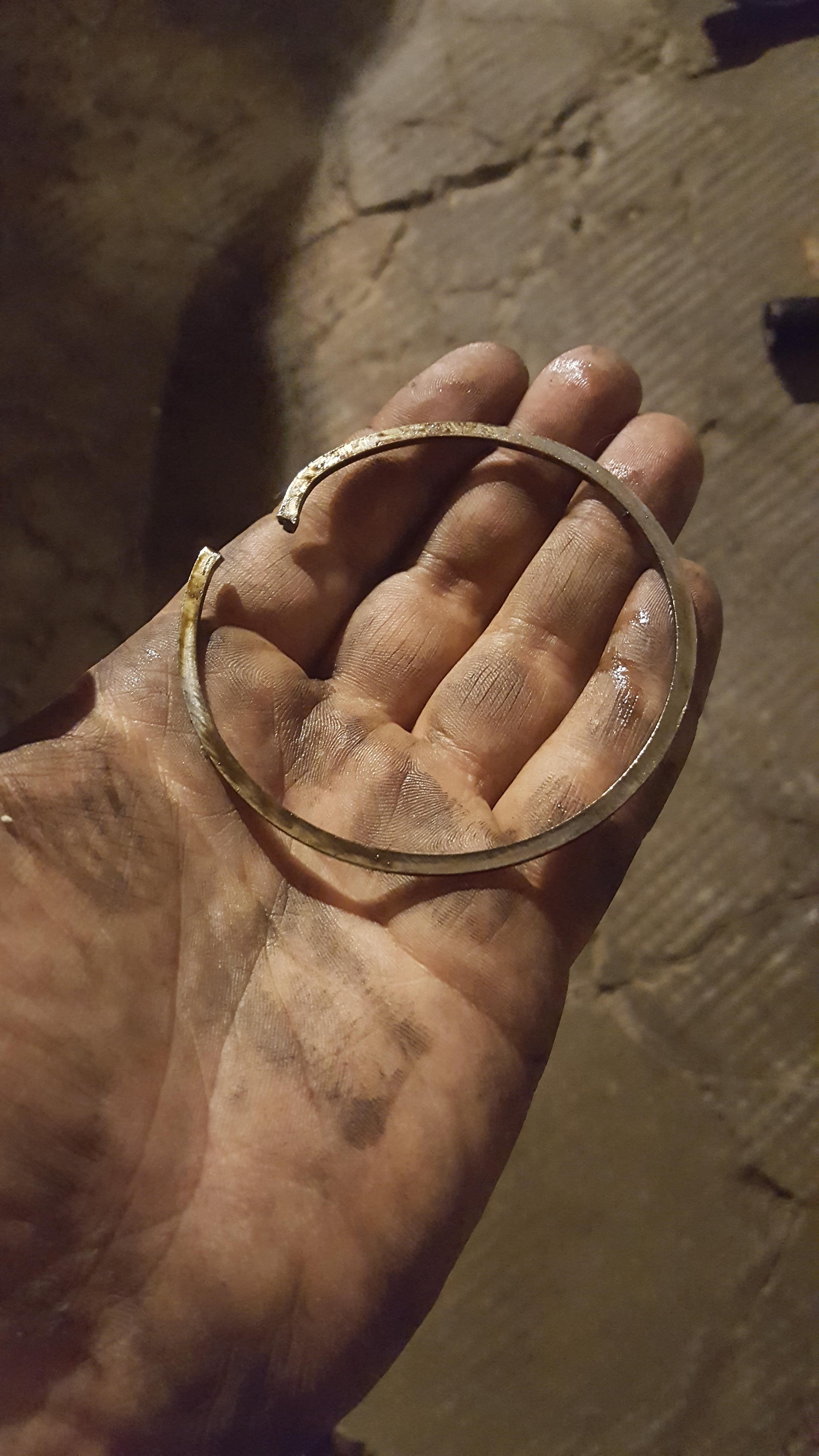

I don`t know your location, but necessity is the Mutha of all invention.
There`s some history here, and that`s a piston ring if I`m not mistaken.
Drive it till spit`s something out.
