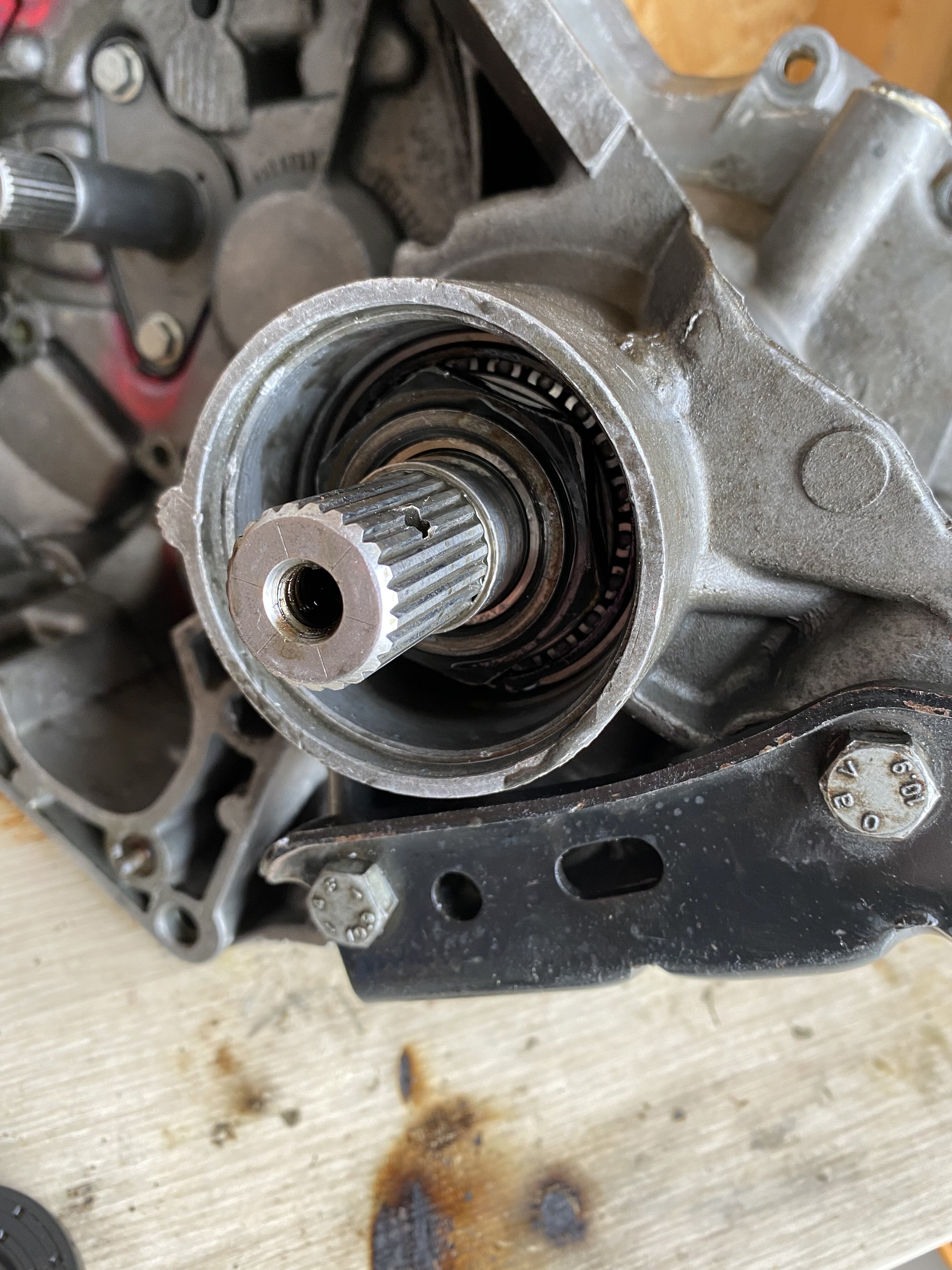

Hi. Does enybady know what torque should this nut below be tighten? My diff has a lot freeplay and I suppose someone hadn’t tighten this nut correctly while installing gripper lsd. Bearings are ok. Look at the video, please.

130nm is the torque setting. There’s only an image mate, not a video attached.

Will tightening that nut do anything?
The whole lot is moving when you moved it 😳
The nut isn’t all the way down, so yes it will. But the big problem comes with if the nut has a wear groove where the preload washer sits. If it does, you tighten the nut onto the bearing and not the preload washer.
Guess what happens then.
