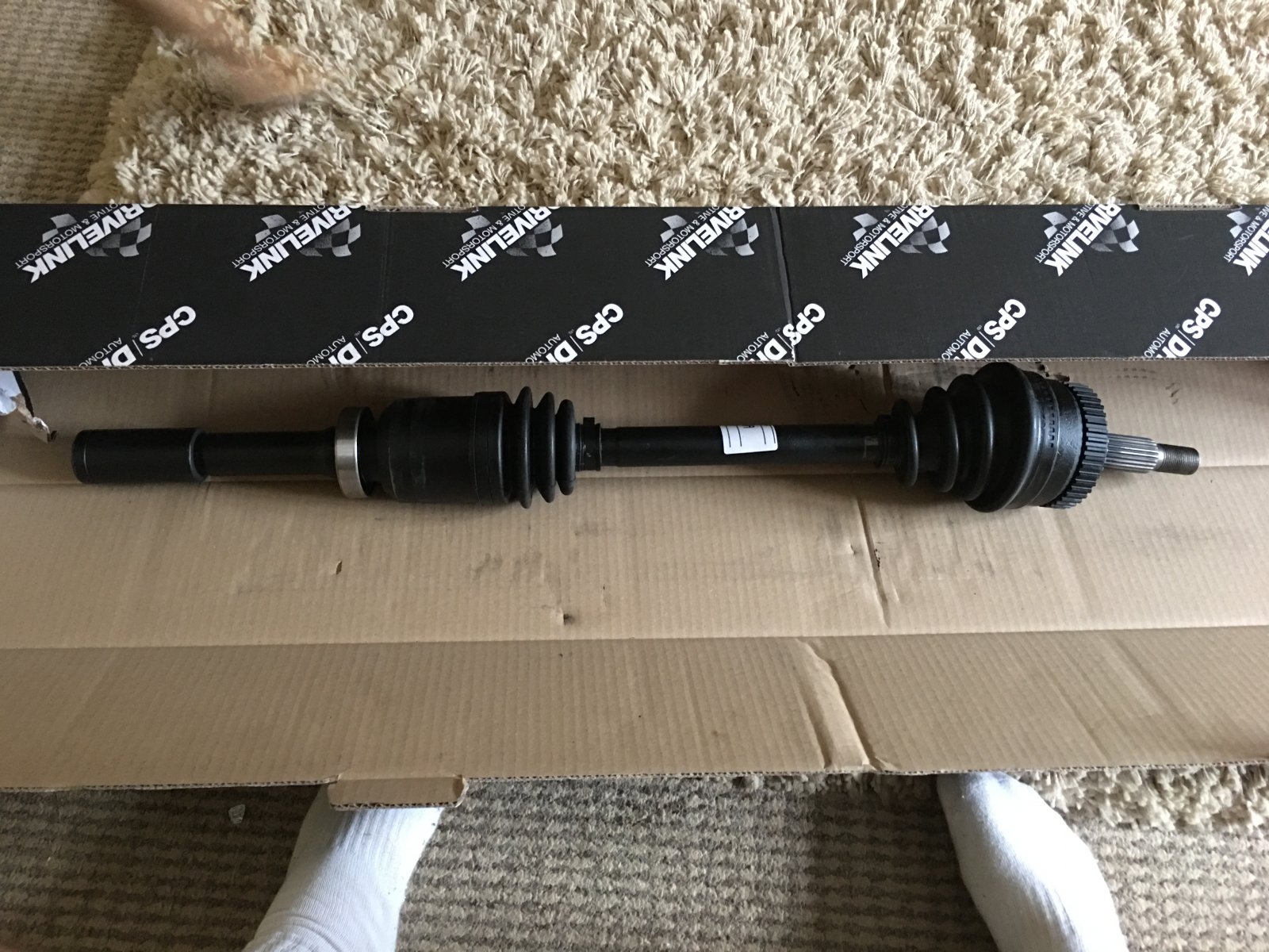

Well here it is .... finally a drive shaft which was the same as I had taken off to start with !
Still don't understand how the other driveshafts are meant to be fine ! This shaft was supposed to be double the price of the original one they gave me .
Part no:re559a

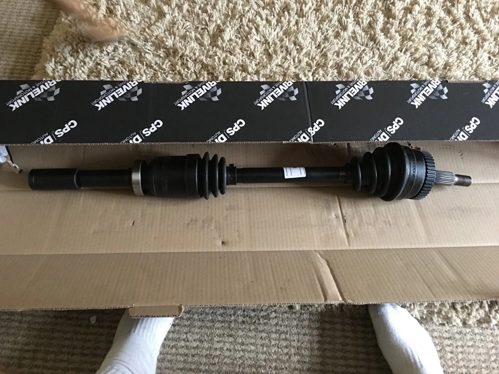

Part no:re559a
the inner boot is going to rub on the block.
and it's missing the s**t cover for the diff end as well.
  Clio 172
I've just fitted the drive shaft .. it is close the block but not rubbing . There's no shakes or wobbles from anything . I'm taking it to a mates garage in the morning to get everything checked and tracking set up properly .
  Clio 172
What cover is missing ? As it stands the shaft is mirror image of what the original one was I removed over a week ago ?
  Clio 172
Yeah I had the one piece ... well 2 of them lol . Both come apart and shat them selfs ... I now finally have one identical to what came off in the first place . It seems fine ATM but will get on a ramp and have a look properly in the morning
