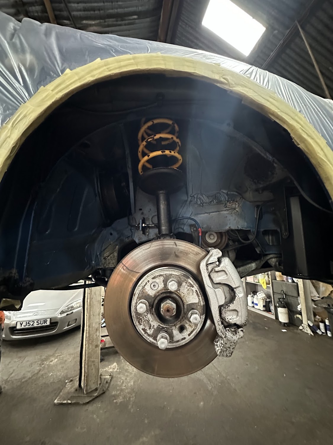

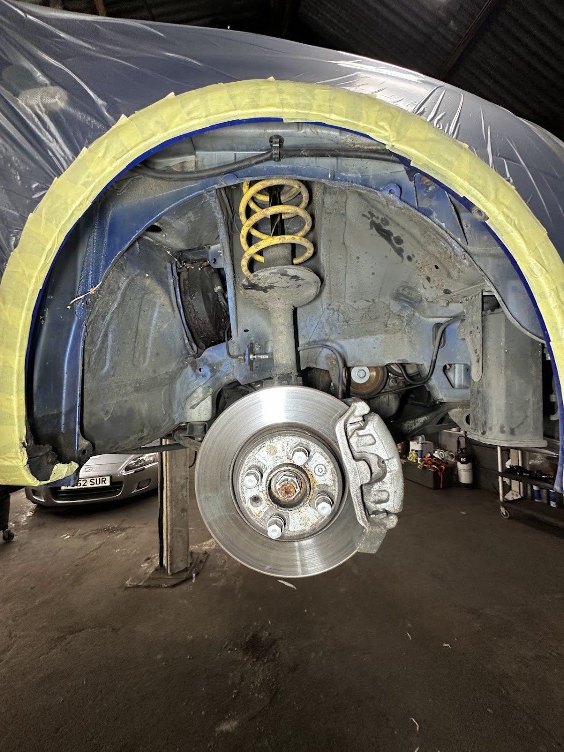

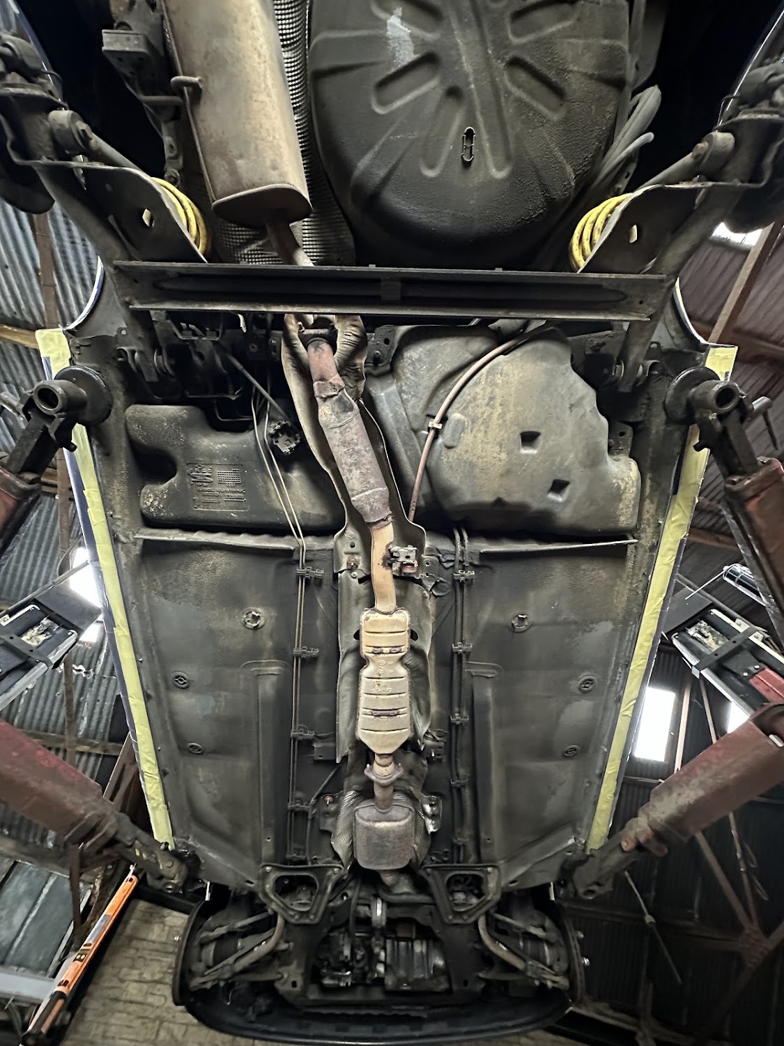

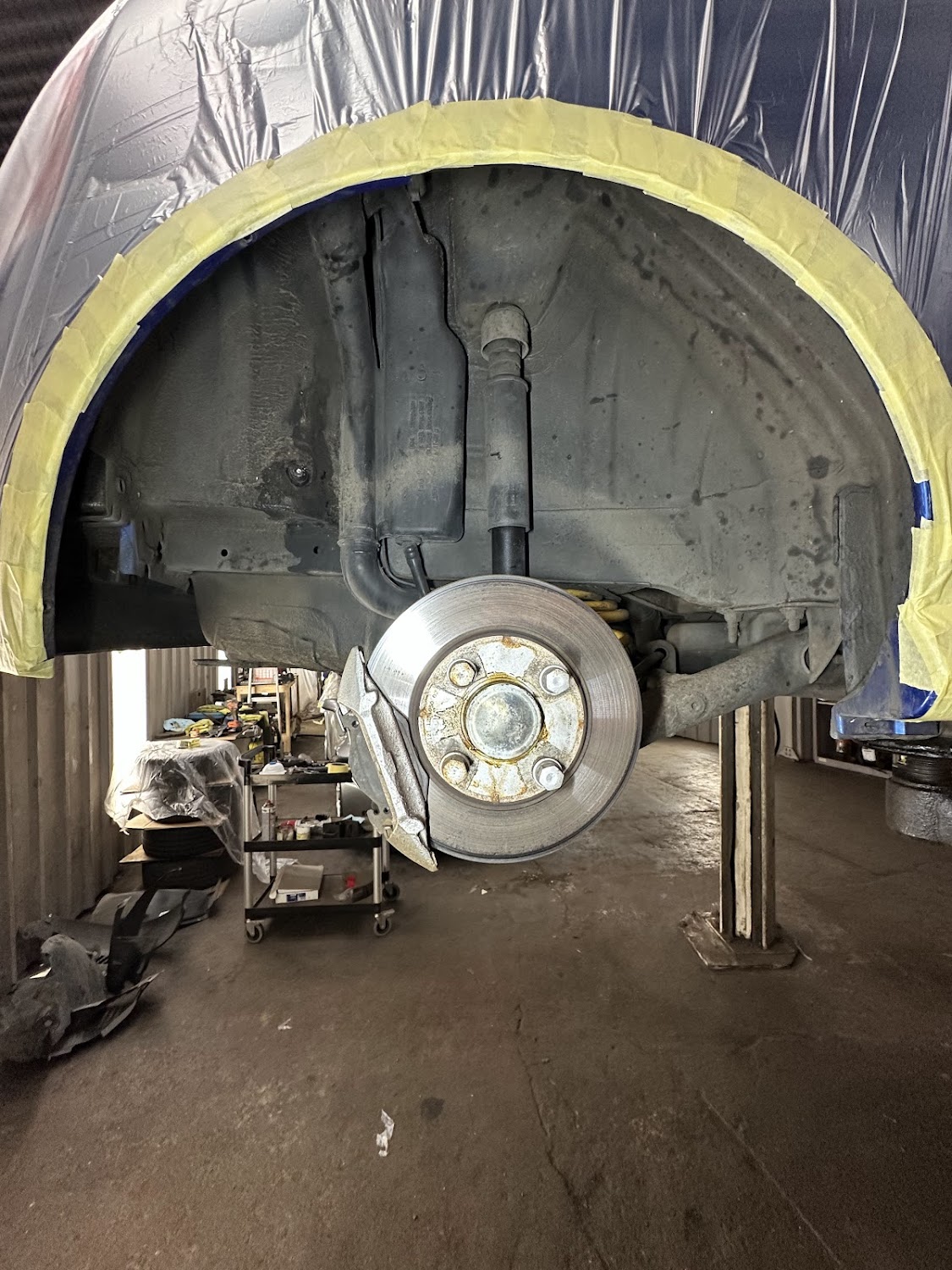

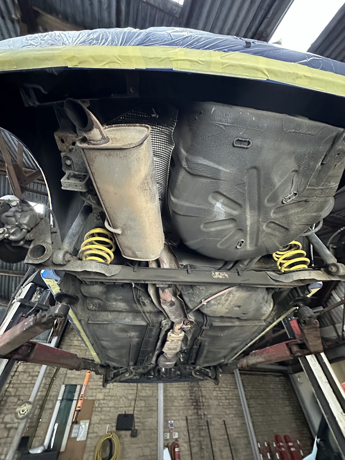

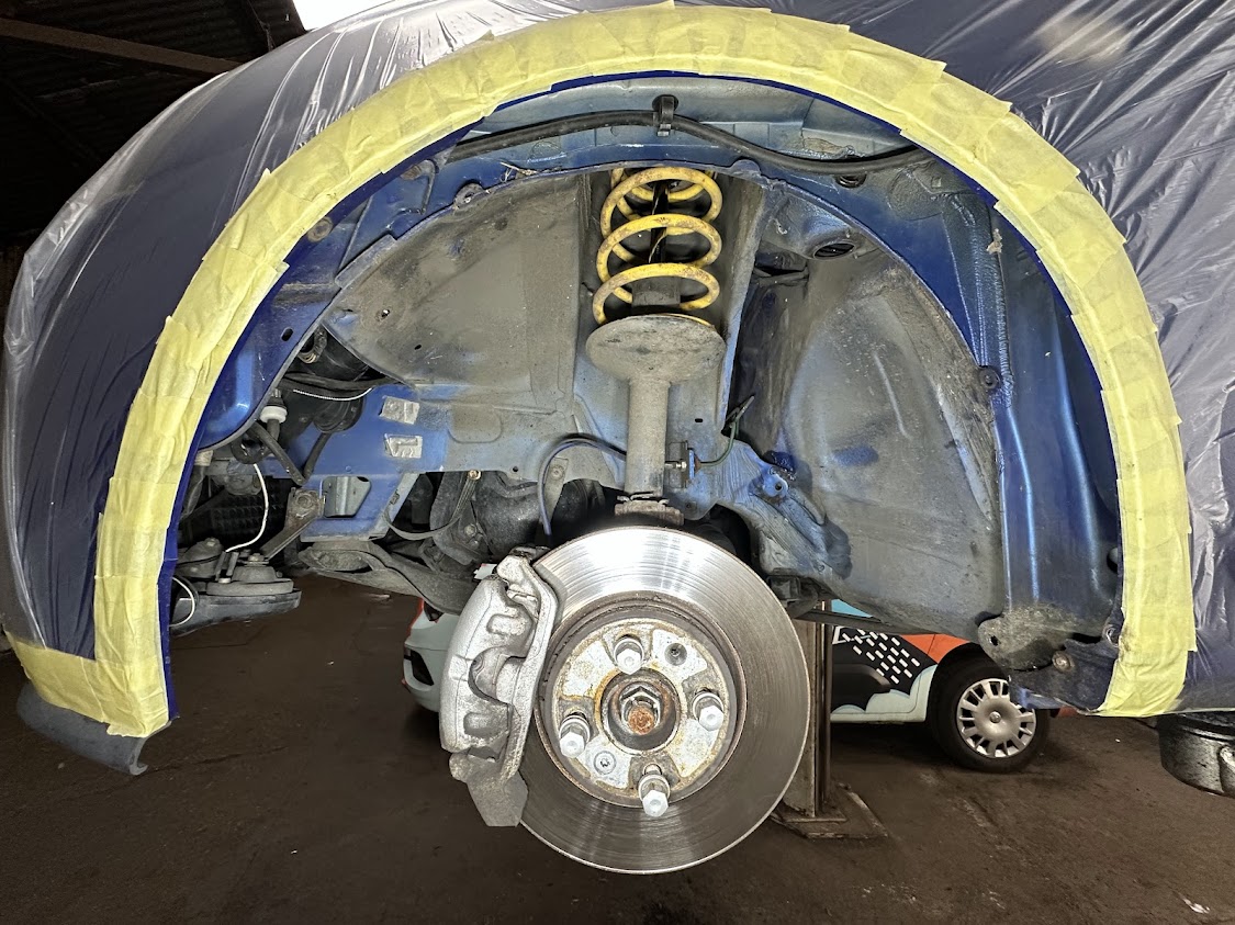

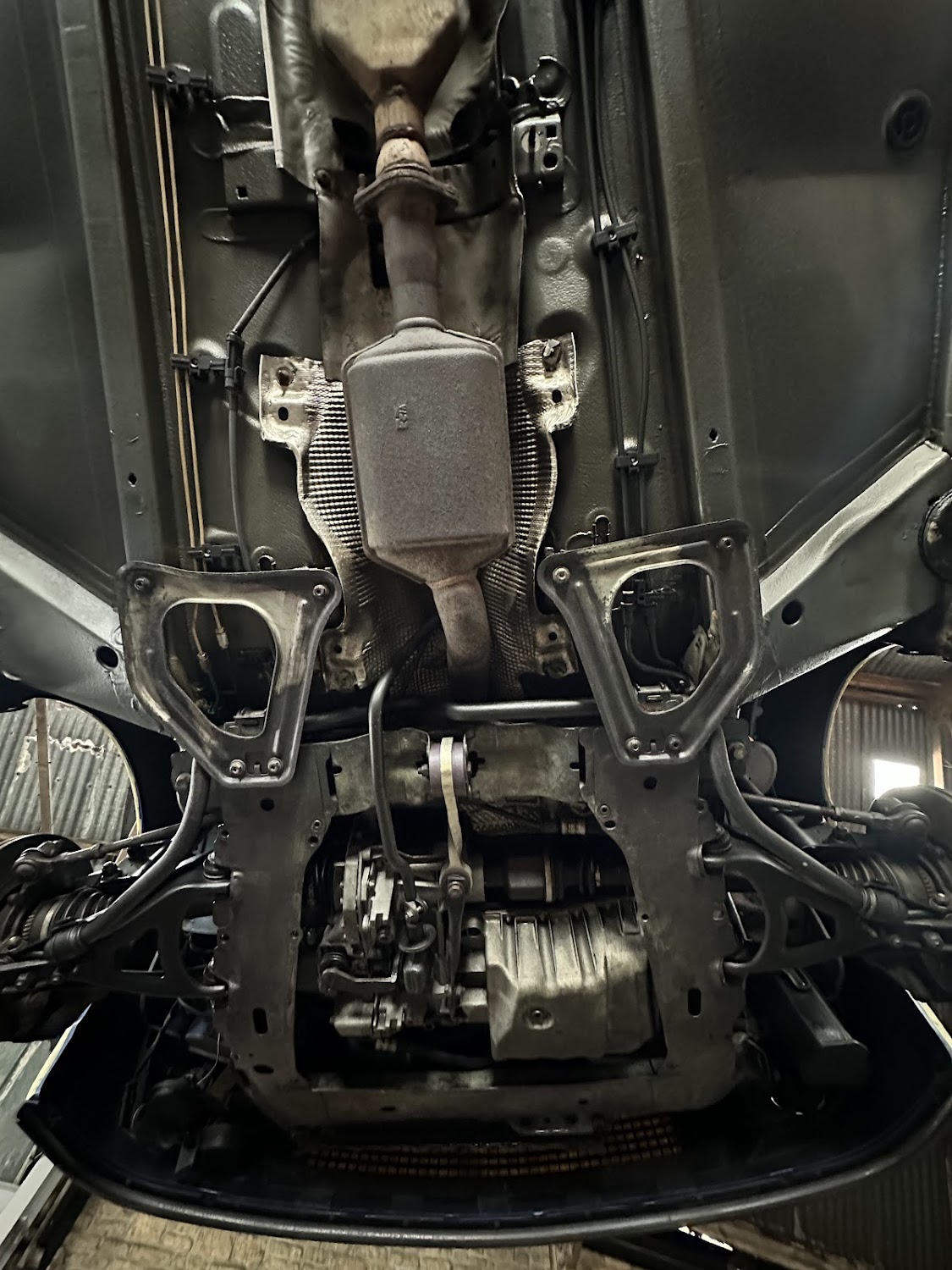

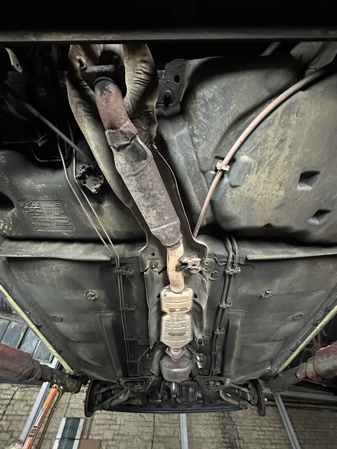

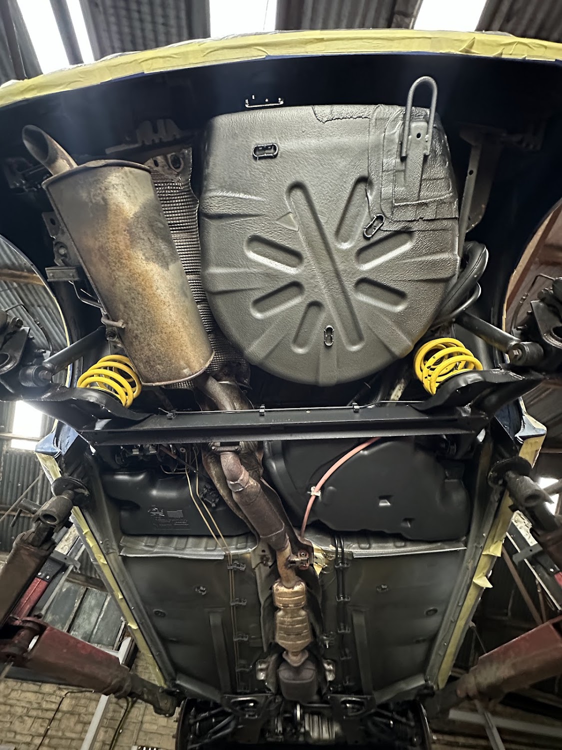

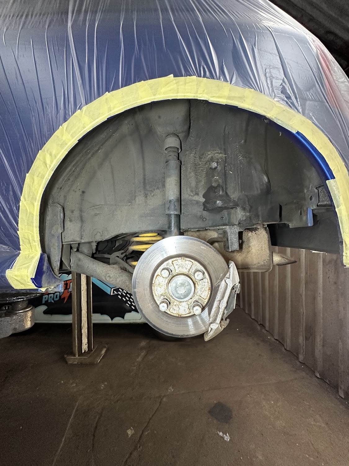

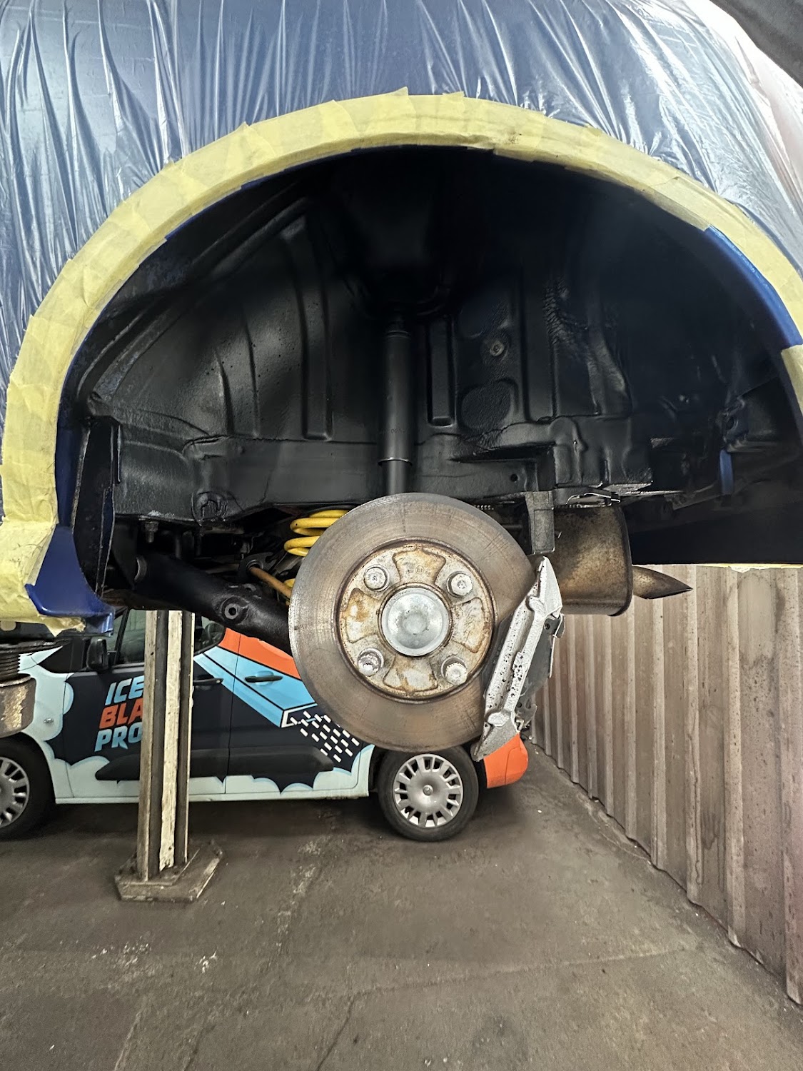

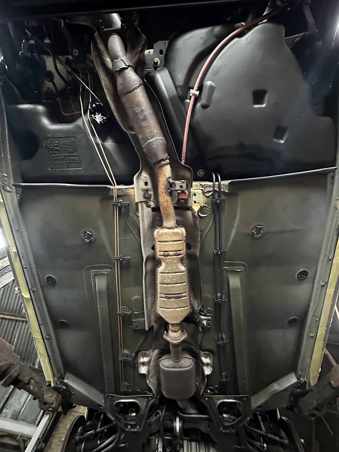

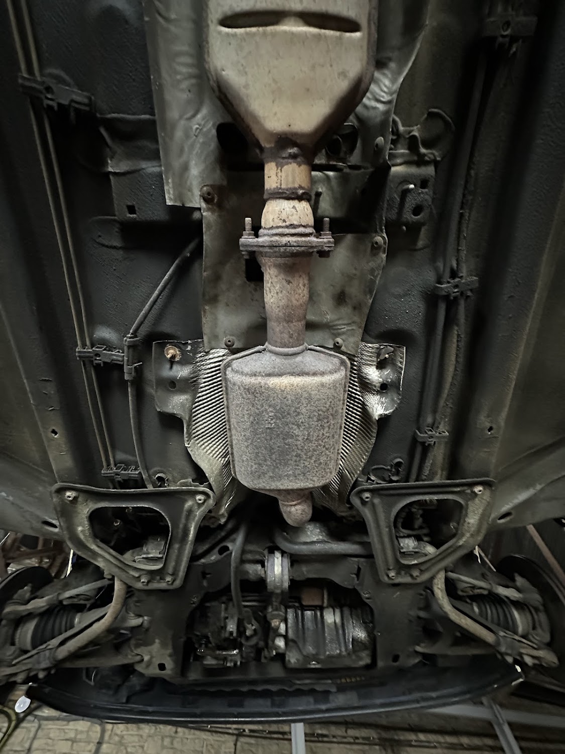

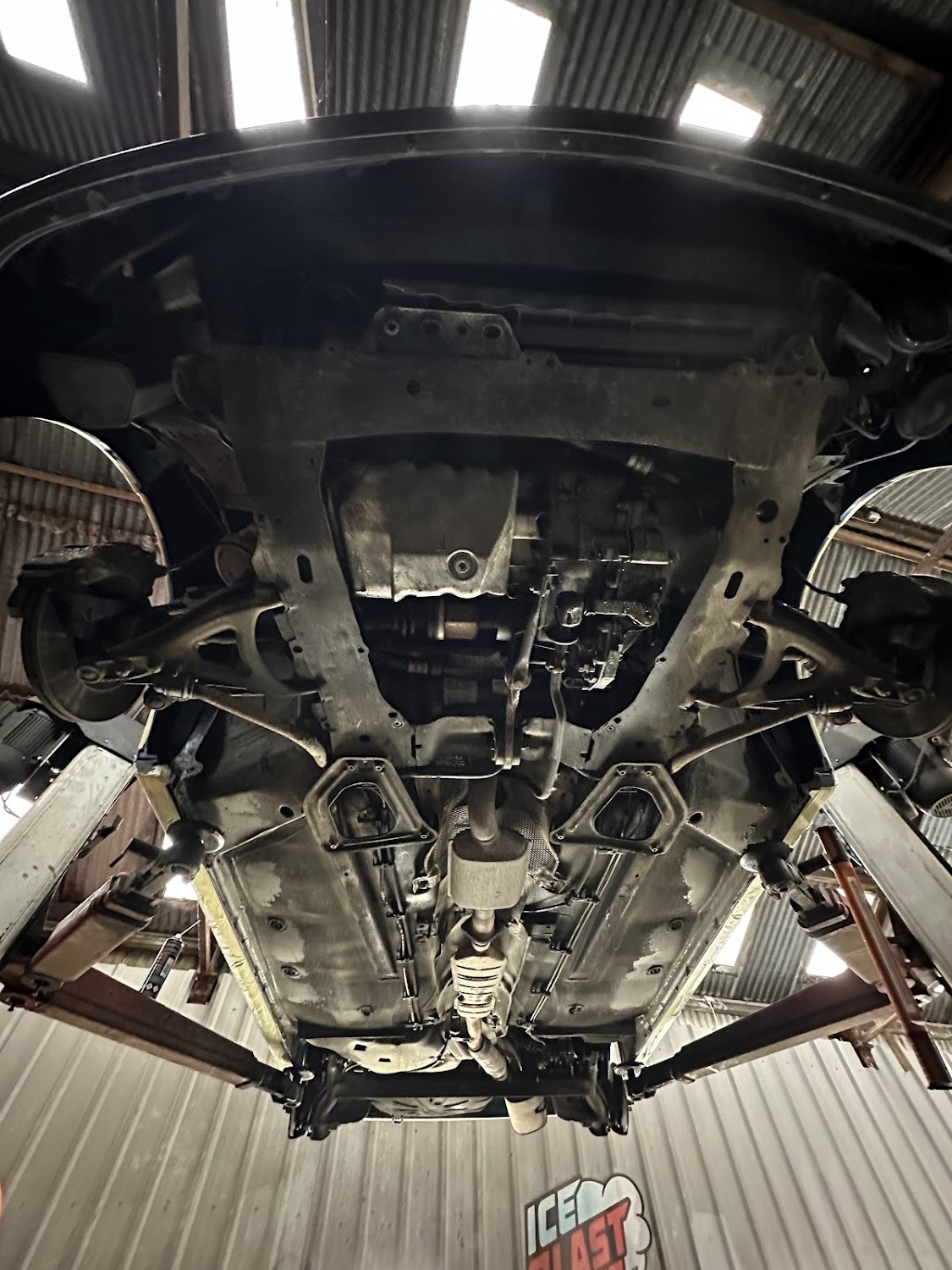

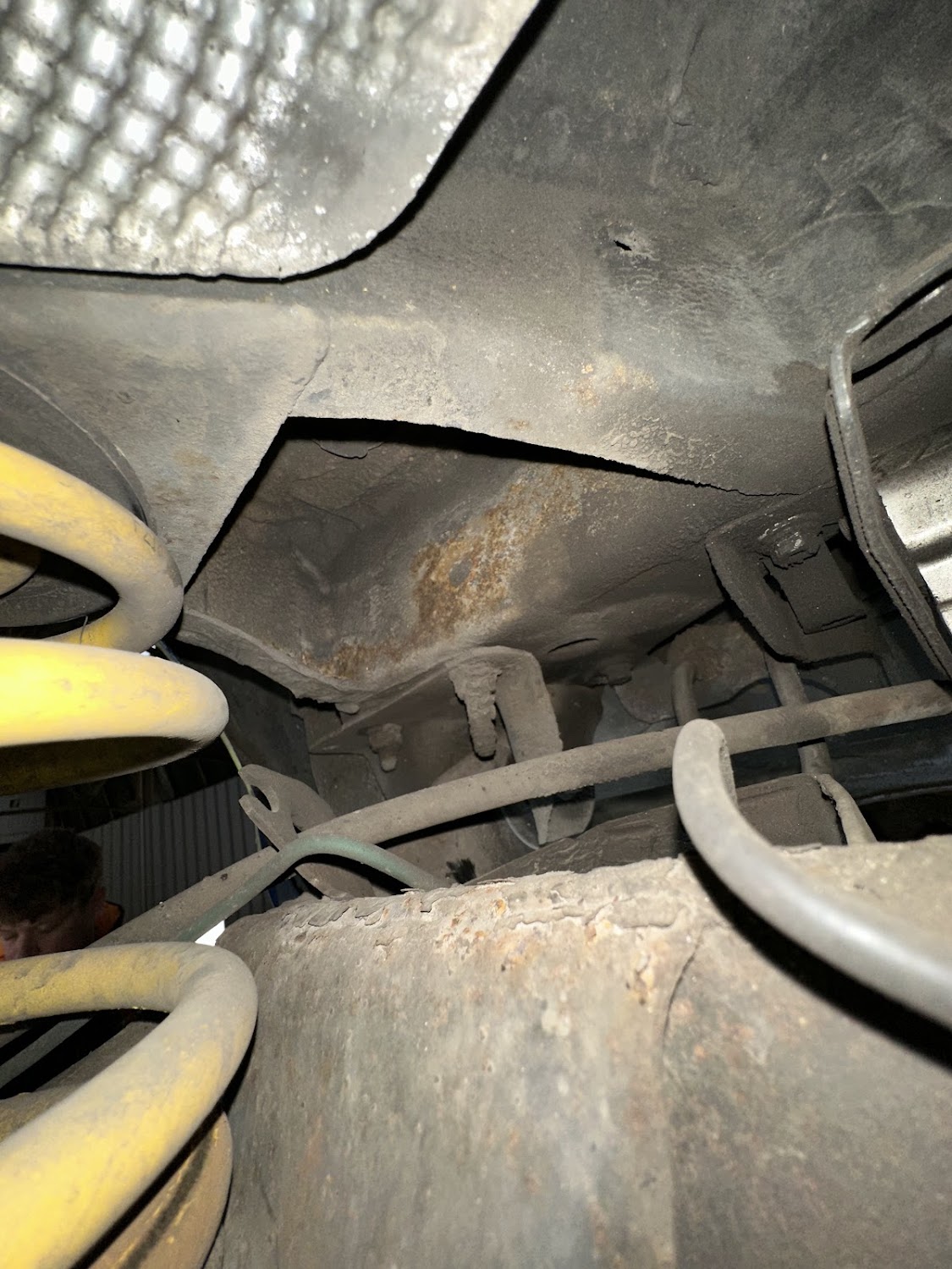

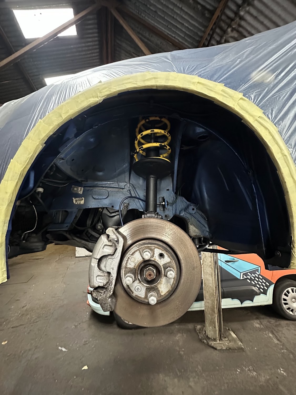

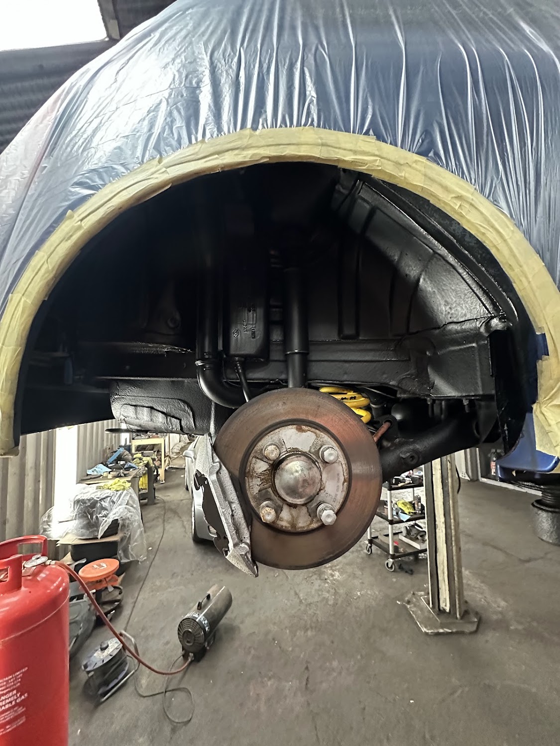

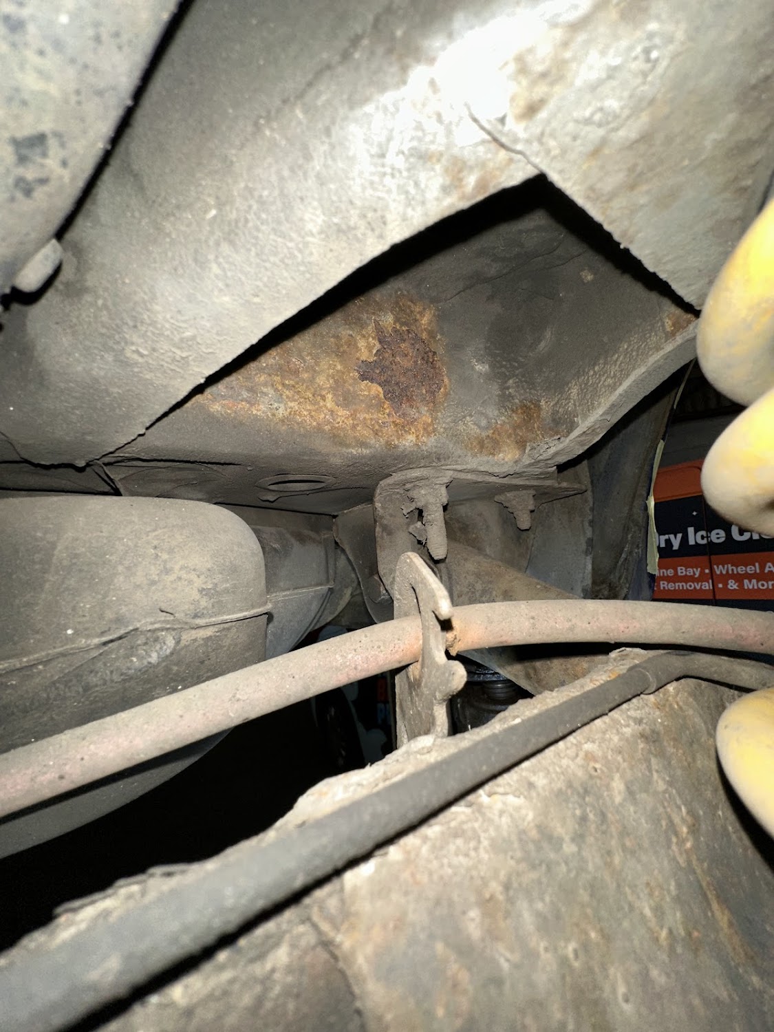

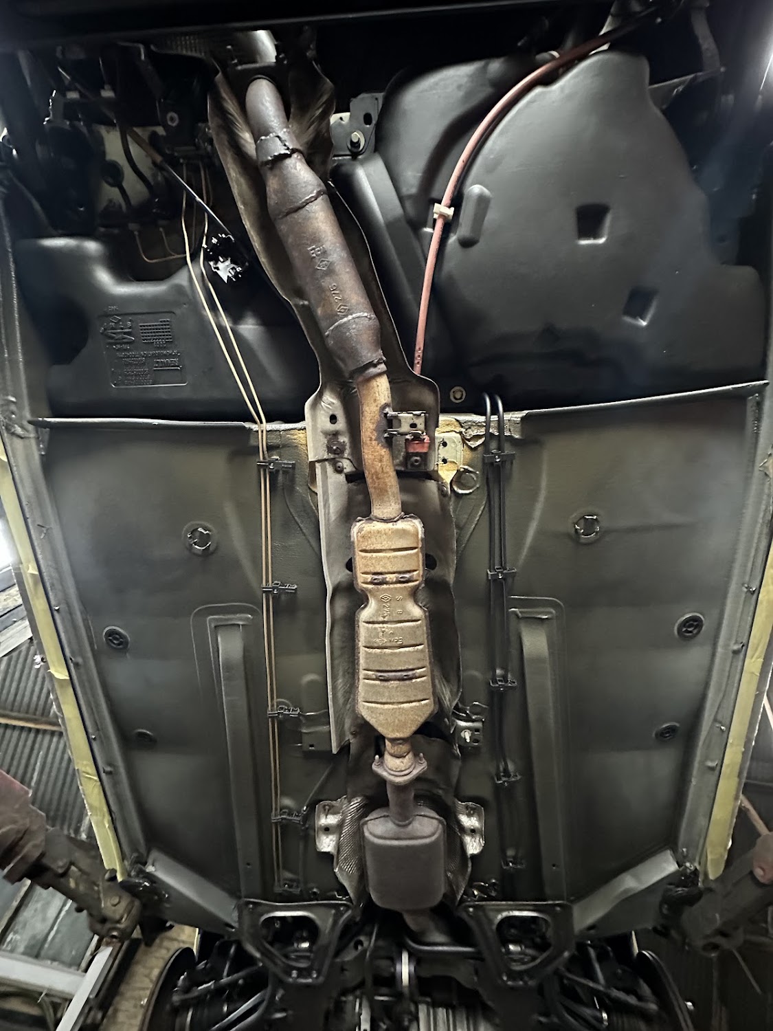

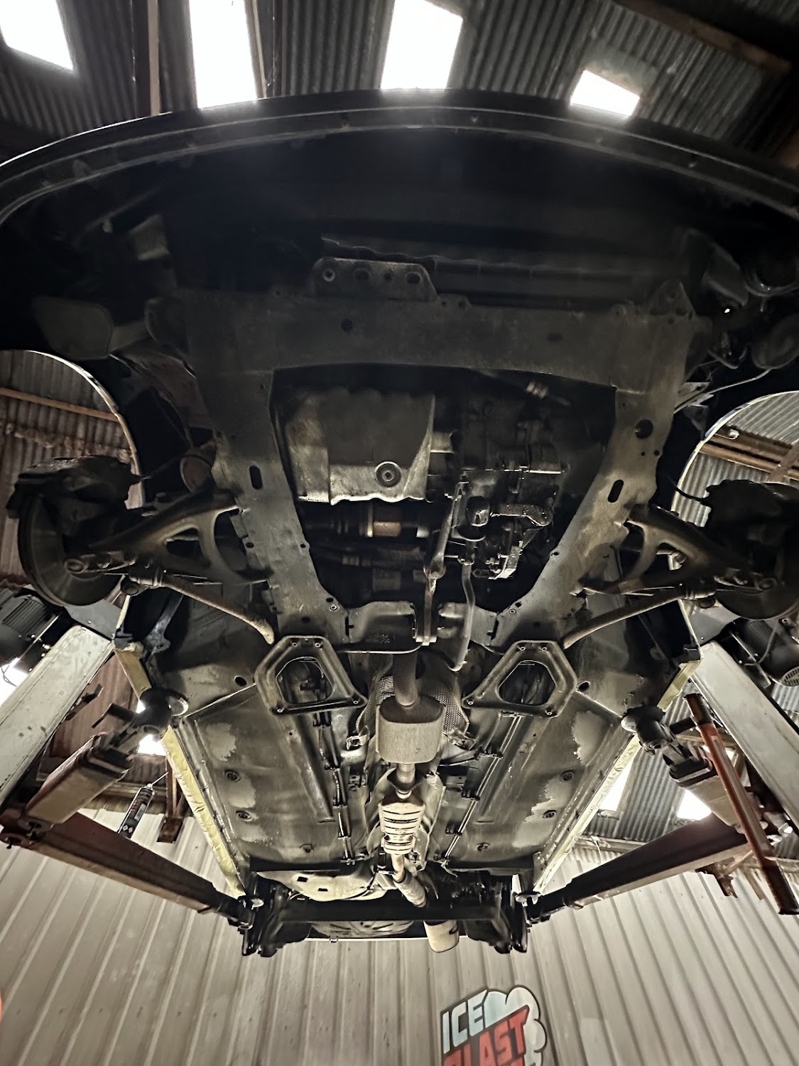

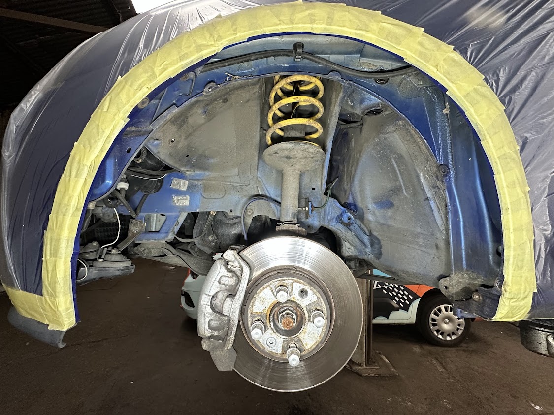

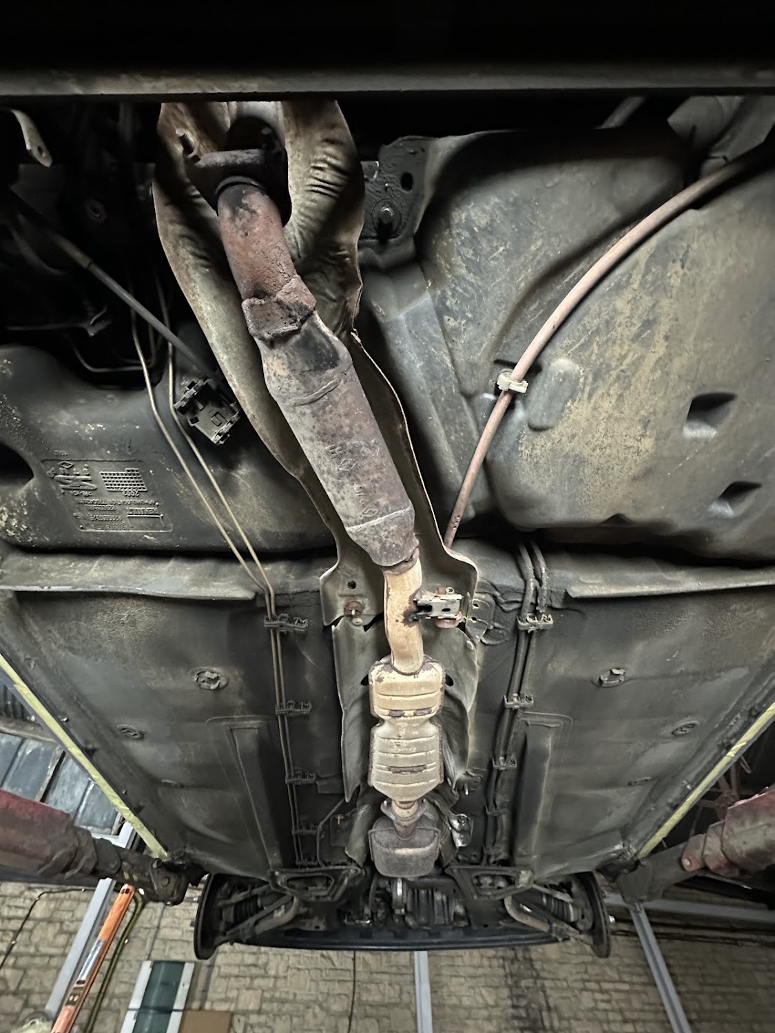

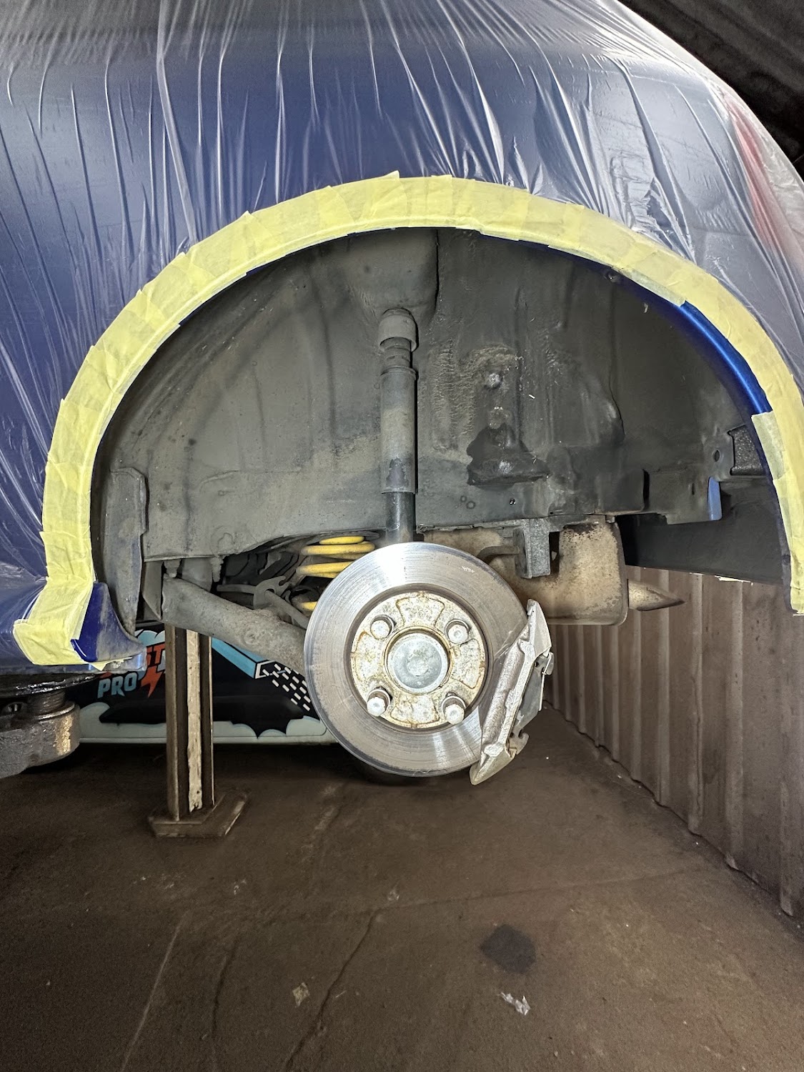

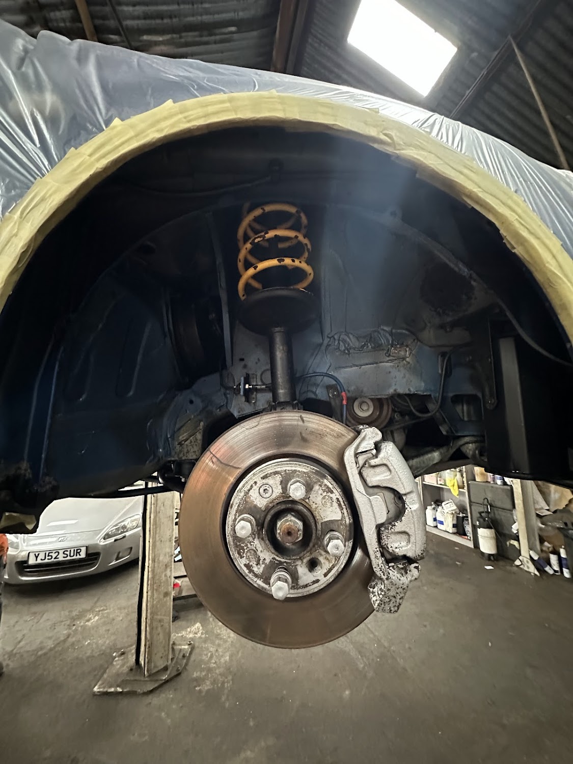

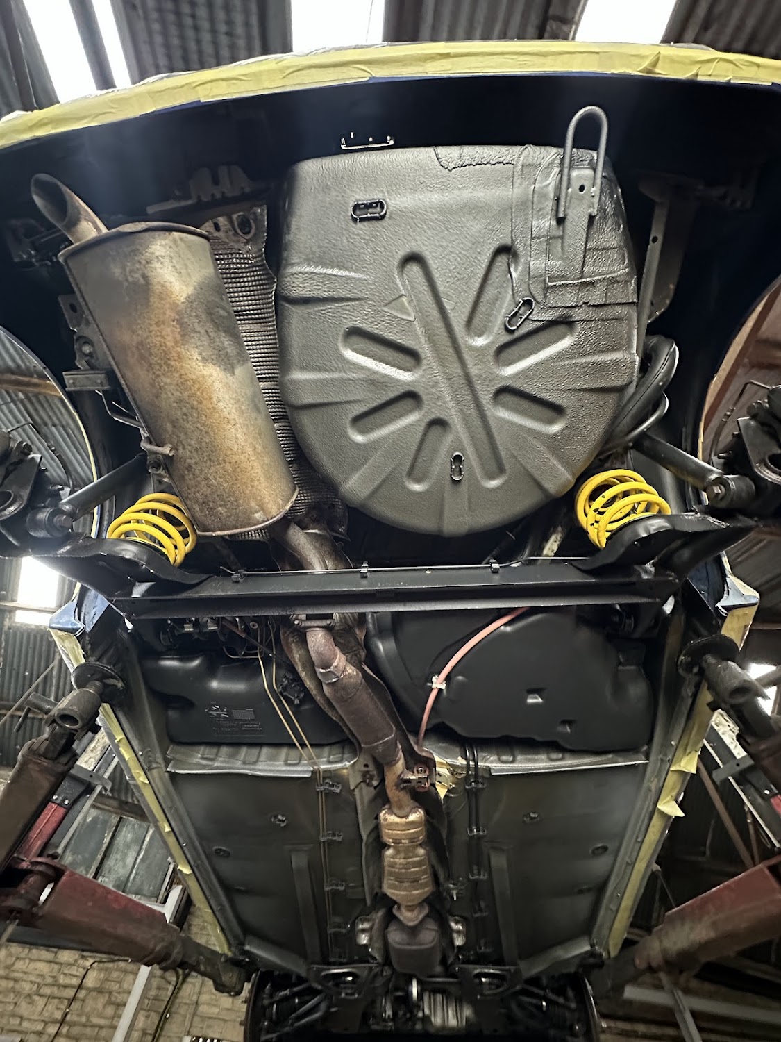

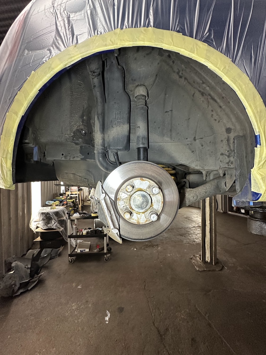

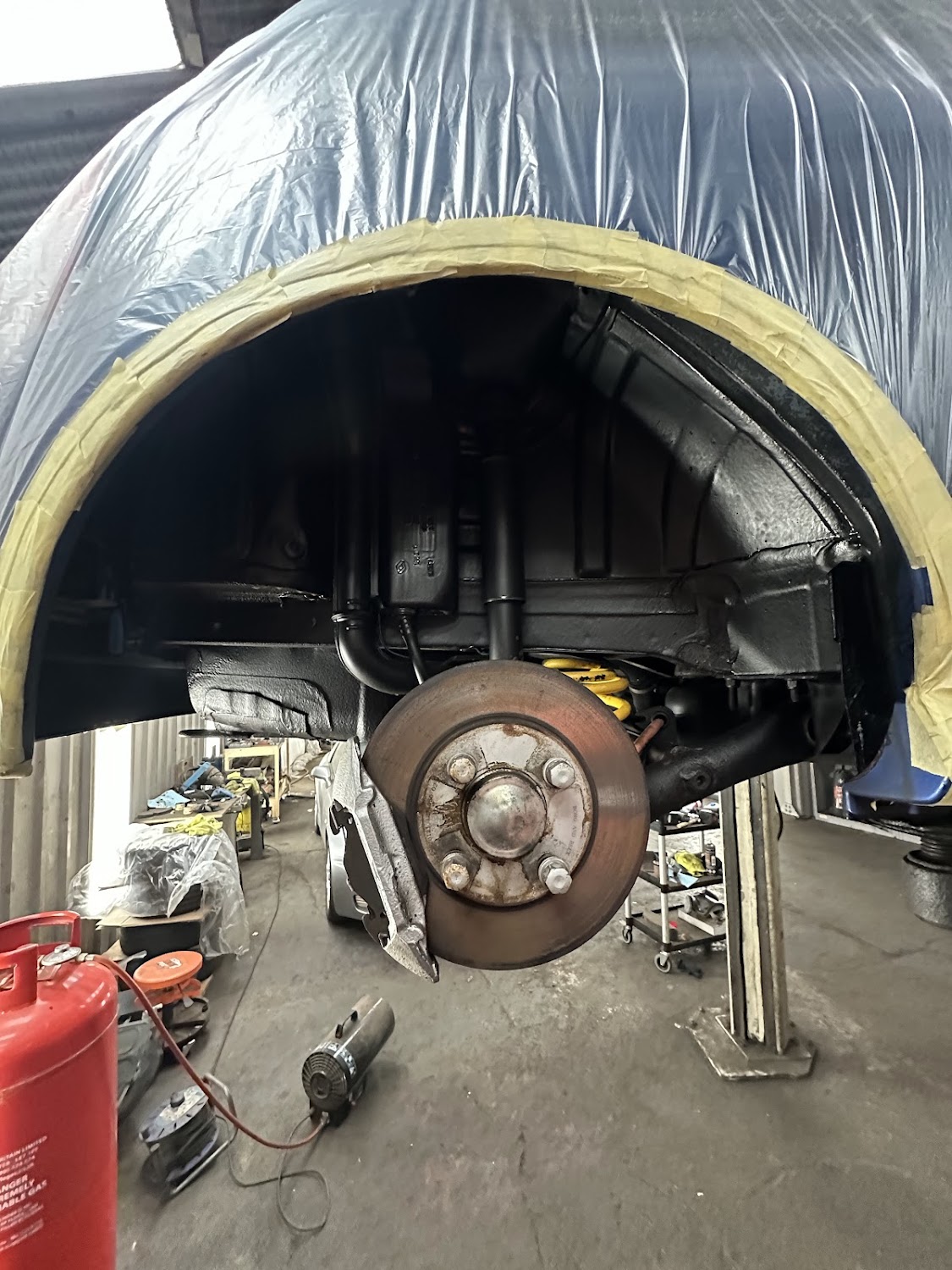

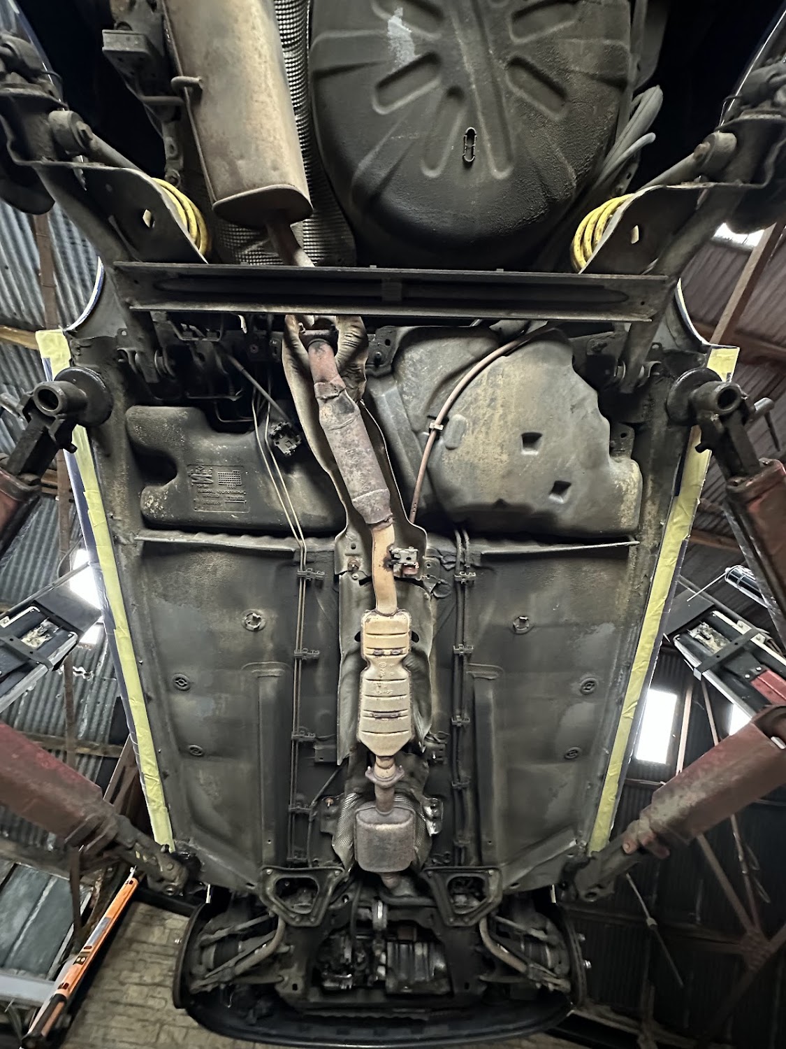

I had it done to my 172 Cup in October. Underside and arches were dry ice blasted, rust converter then applied to necessary areas and finally all protected with Bilt Hamber Dynax UC wax.
I was very pleased with the results and the company I used were great https://www.iceblastpro.co.uk/ . It was expensive at £2k. Is it worth it? I’d say so but it’s subjective.
I wanted the underside and arches cleaned, protected and any corrosion taken care of. This seems to be the best and safest method to do so and I was able to afford it so thought why not.
Underside and arches before dry ice blasting
Underside and arches after dry ice blasting and rust converter was applied to necessary areas
Underside and arches after dry ice blasting, rust converter was applied to necessary areas and all protected with Bilt Hamber Dynax UC wax
Before
After
Results look ace! Did they apply the rust treatment/preventer too for that price?
Before
After
