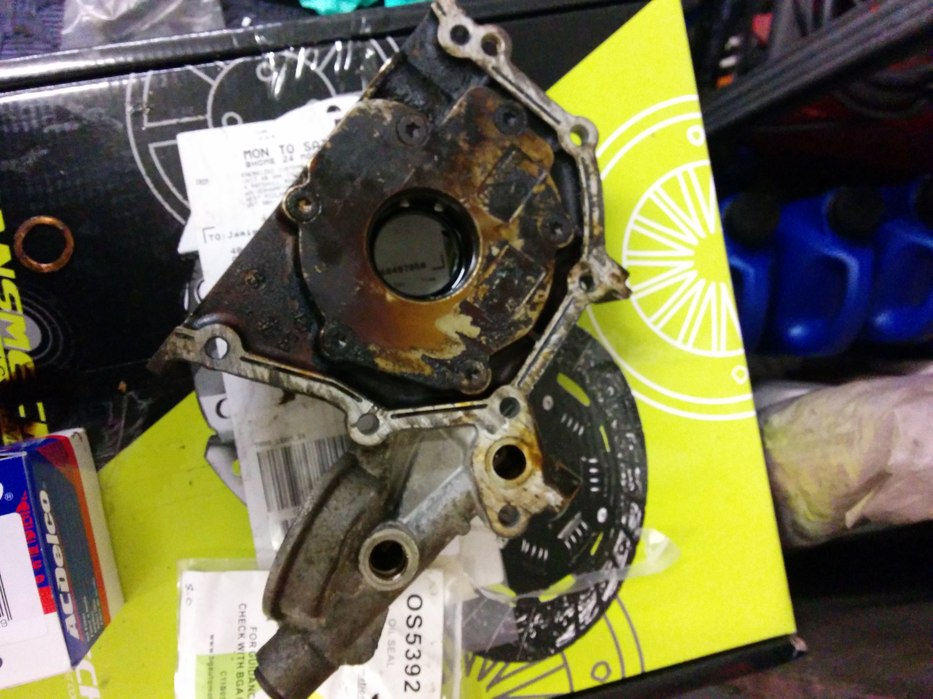

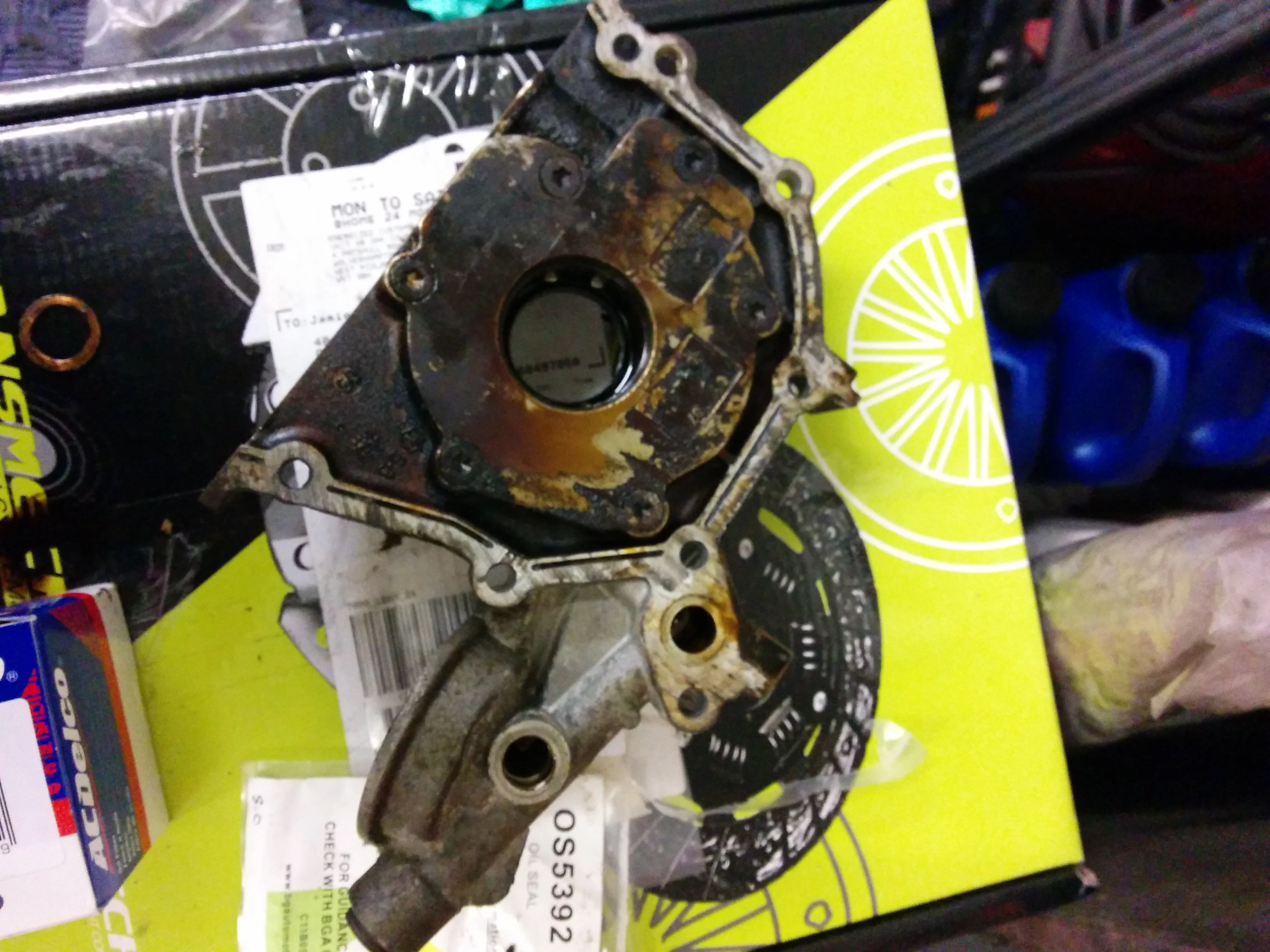

Evening all. Just got the car back. A list of work done: oil pump, oil pump seal, cambelt, oil level sensor, oil filter, oil and alternator belt.
Oil pump was the main issue, I've uploaded a picture of how it was. Thanks for the help all.
