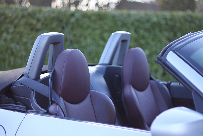

Seats look great Rob although can't help but think the leather looks a bit "baggy" already?
Rob
Re: E85 3.0 Z4 Roadster Project *Seat Pics #658*
+1 one for hairdresser thread..
It seems to be a trait with me and photographing seats, I always make them look really bad!
They're actually very tight, and there are methods to tighten them up further that have been done by others members on the zed forums so I may have a go at those.
Love the seats!
Just seen the seat Rob, they look great, good choice. :)
Good choice on the seats.
Thanks you three, I'm more than happy with them.

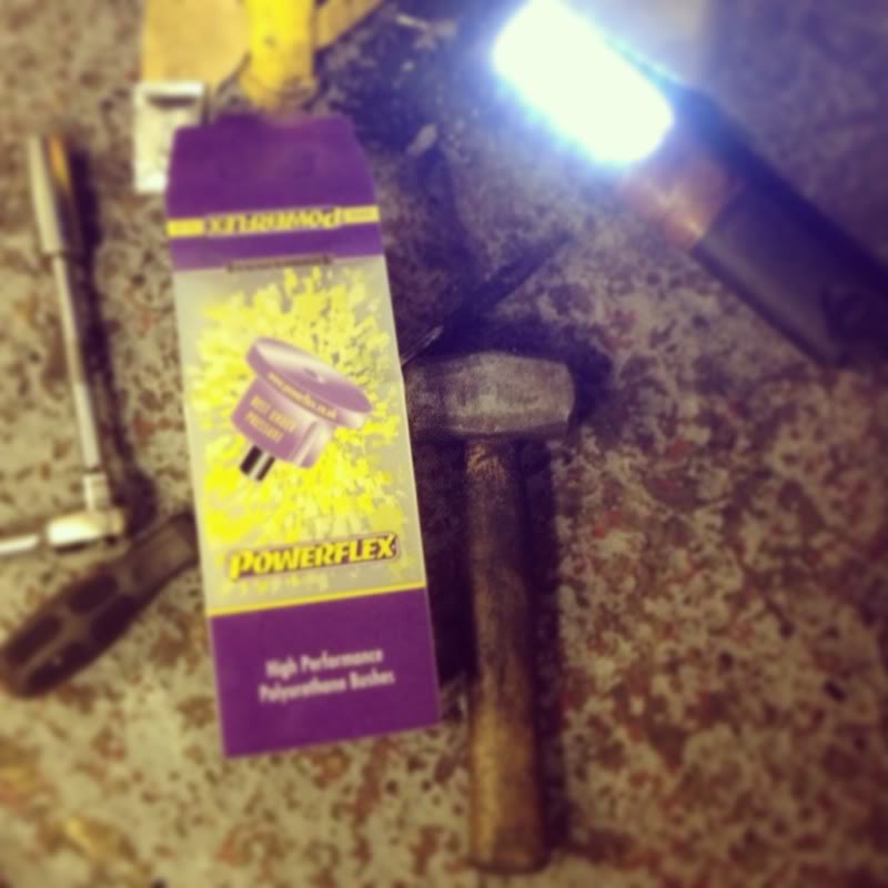

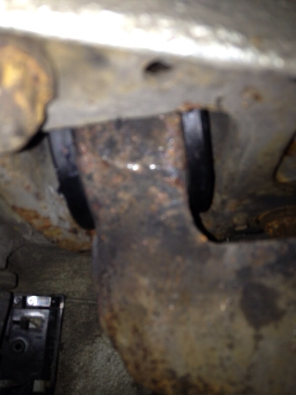

I decided to forefit paying BMW "specialist" prices this week and rectify a slight knock on the rear end myself (ish).
Fitted some powerflex rear trailing arm bushes last night (RTAB's) with Ant. Without the unit I could see BMW ownership being quite expensive on occasion, but thankfully its worked out cheap as chips.
Thankfully, Steve in the unit next door had an oxy acetylene torch and some metal plates, so we disconnect 90% of the rear arms and dropped the front of them down. We put some metal plates in places supported with some pieces of timber that would guard the fuel tank and bodywork etc and then set fire in a big way to the old bushes.
Then a quick hacksaw through the thick sleeves, a dash of sand paper and Ant's man strength fitted the new bushes, no press required. The mounting plate for the RTAB's even had clear silver bolt locations on (clean vs dirty) so we could bolt them back exactly where they were.
Quick breakdown in difference of costs..
Specialist:
Bushes: £50+VAT
Labour: 1 hour per side at £60+VAT
Alignment: £130+VAT
Total: £360
Unit Style:
Bushes: £46 Delivered
Alignment: £59 + possible £20 to equal rear camber up
McDonalds to keep us alive: £6
Total: £131 (That's maximum if the camber needs doing)

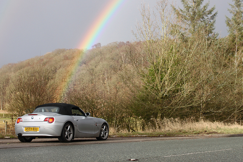

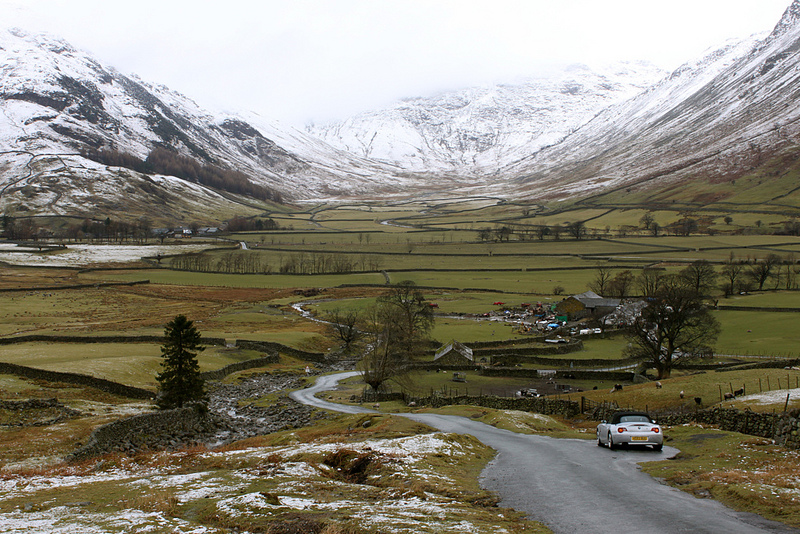

It then went to the lakes:
The weather had been abysmal so it was neglected a little, then I gave it a good spring clean and took some photos:

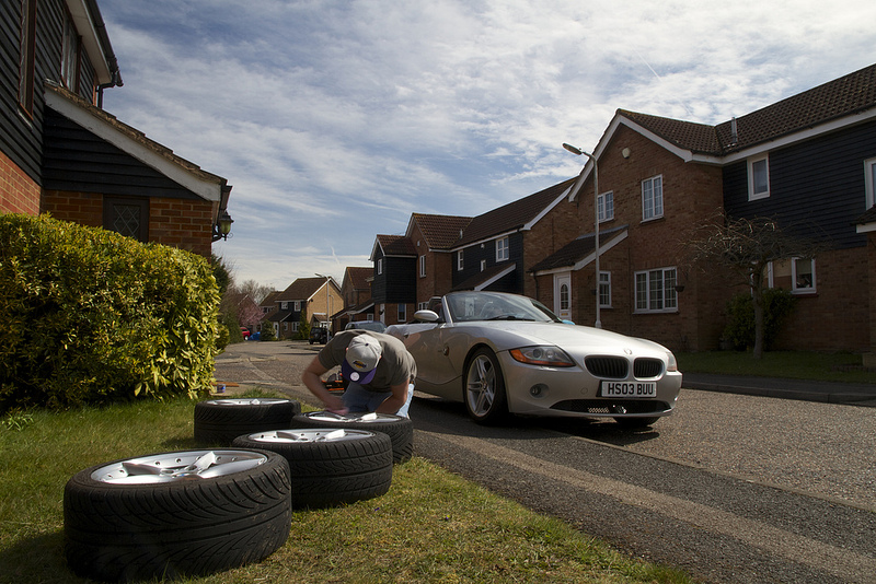

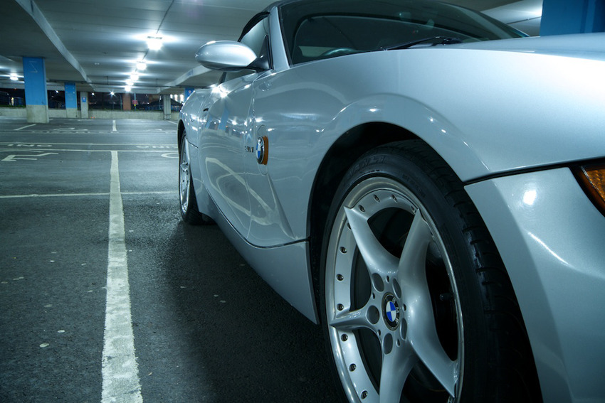

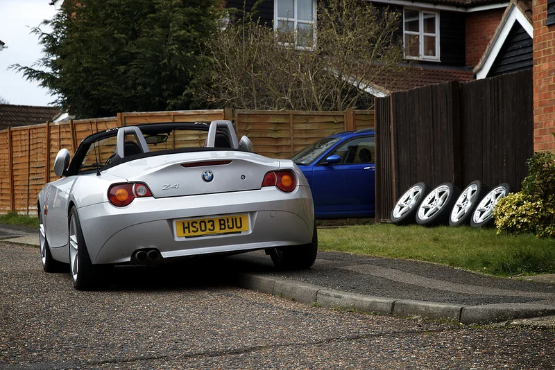

Then I went impulse buying, a friend of TEG's picked me up some new wheels (with good tyres) and I put mine up for sale.
Slave at work by evil_giraffes_rule, on Flickr
New boots by evil_giraffes_rule, on Flickr
The Zed by evil_giraffes_rule, on Flickr

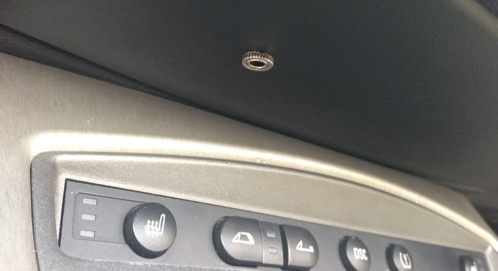

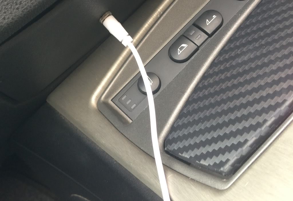

We also fitted a new Aux in a frankly awesome position, works wonderfully.
I'll take a photo tonight of that, it's very tidy.

Where did you put your AUX in? I have a cable on its way, still unsure where to put it. I think it will be going on the panel underneath the heater controls though.
  Ibiza FR
Got a 2006 Facelift SE in black. 2.0l engine - I'm only 21 so trying to keep insurance down, but power is plenty for me coming from a Mini Cooper and still sounds awesome!
So far I have put black grilles and a ZHP gear knob - the standard one is a horrible shape to use. Also waiting for private plate to go on.
I'll get a picture for your other thread soon :)

Those M wheels suit the silver well, need a few more photos to cast a proper opinion though that last photo looks great.
Good shout on the aux cable, is it good quality sounds though? I considered a dice kit but forgot all about it.
Oh, lose those silver french fries in the rear lights mate ;)
