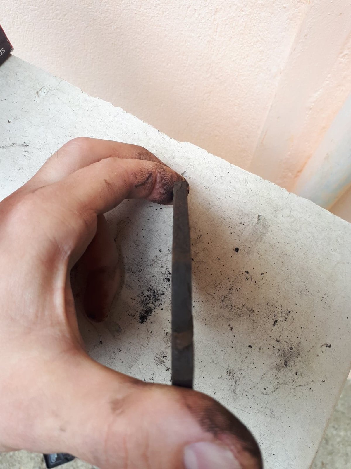

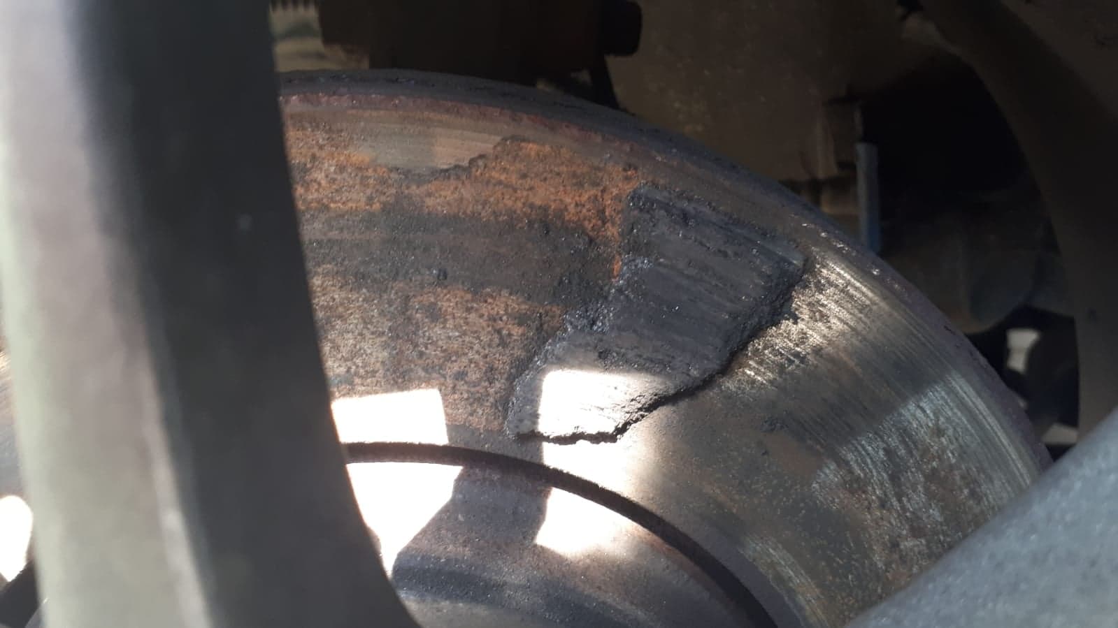

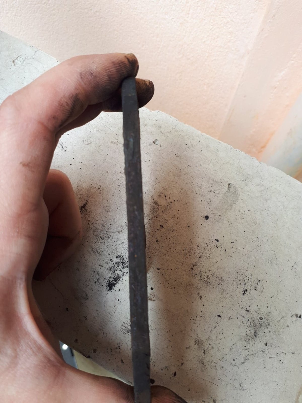

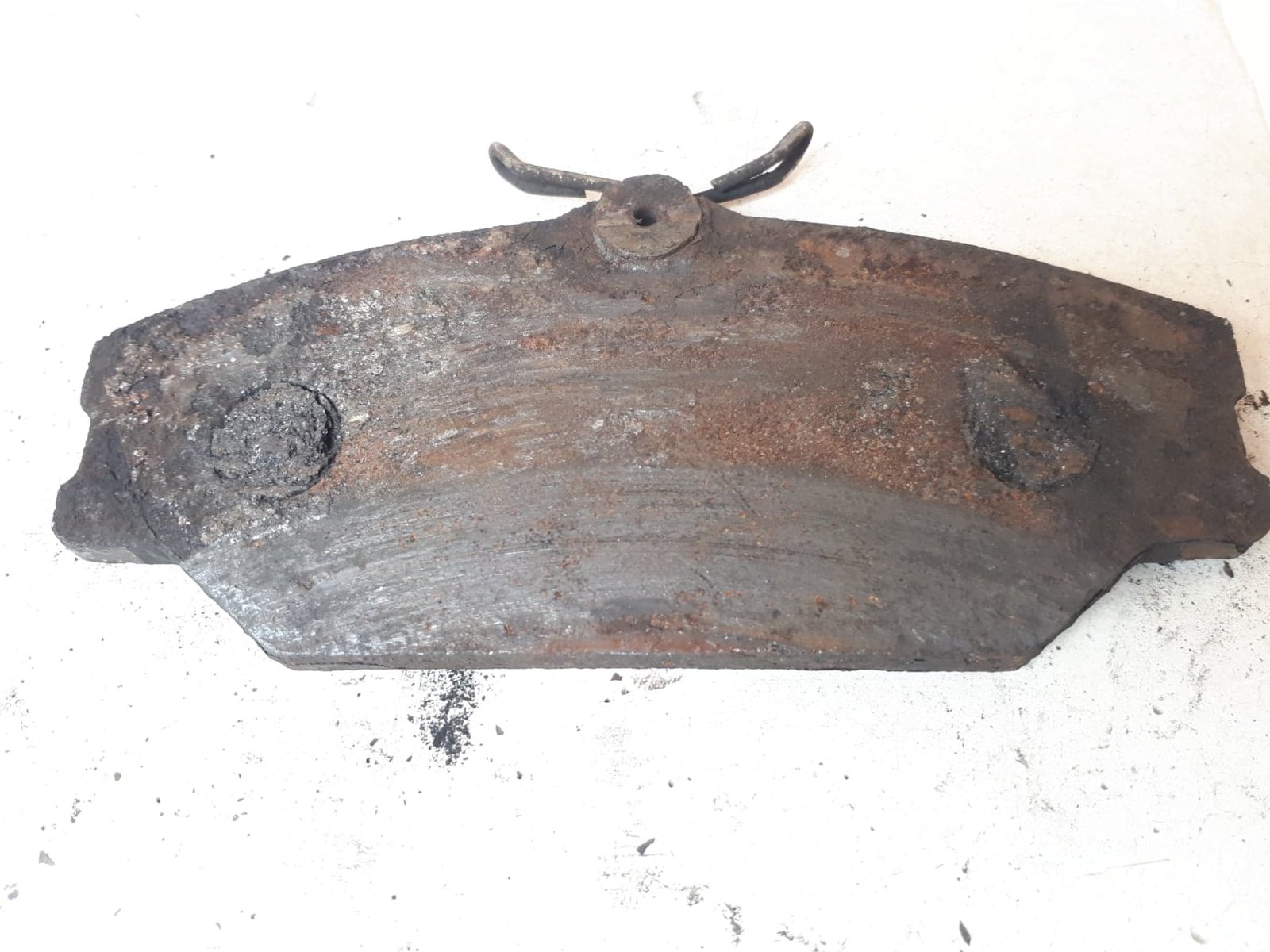

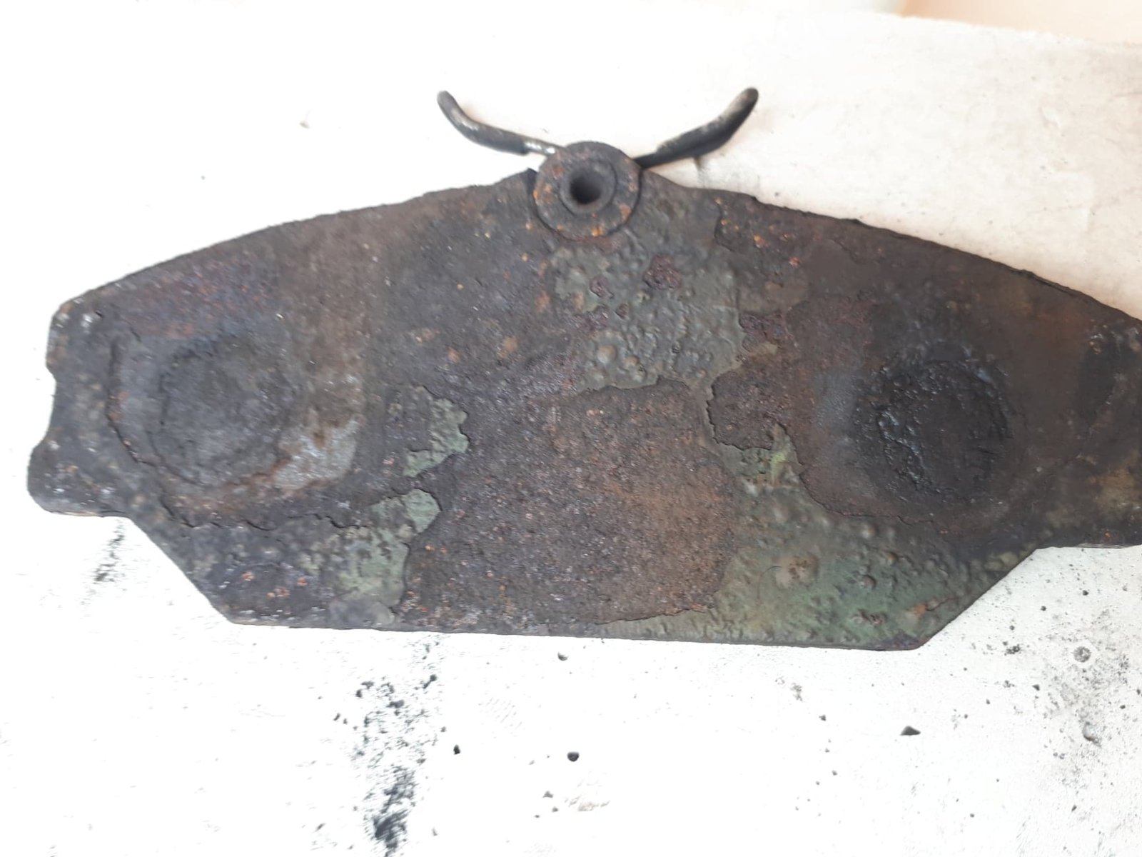

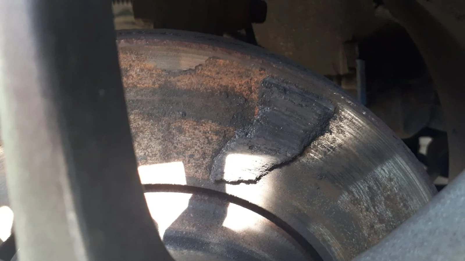

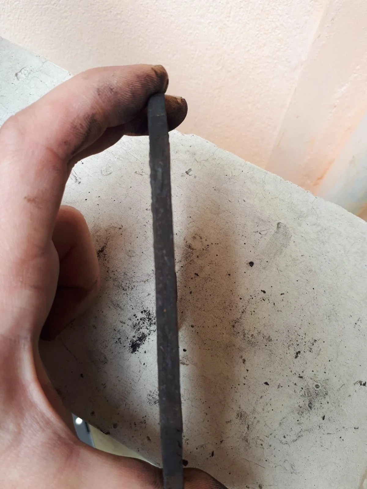

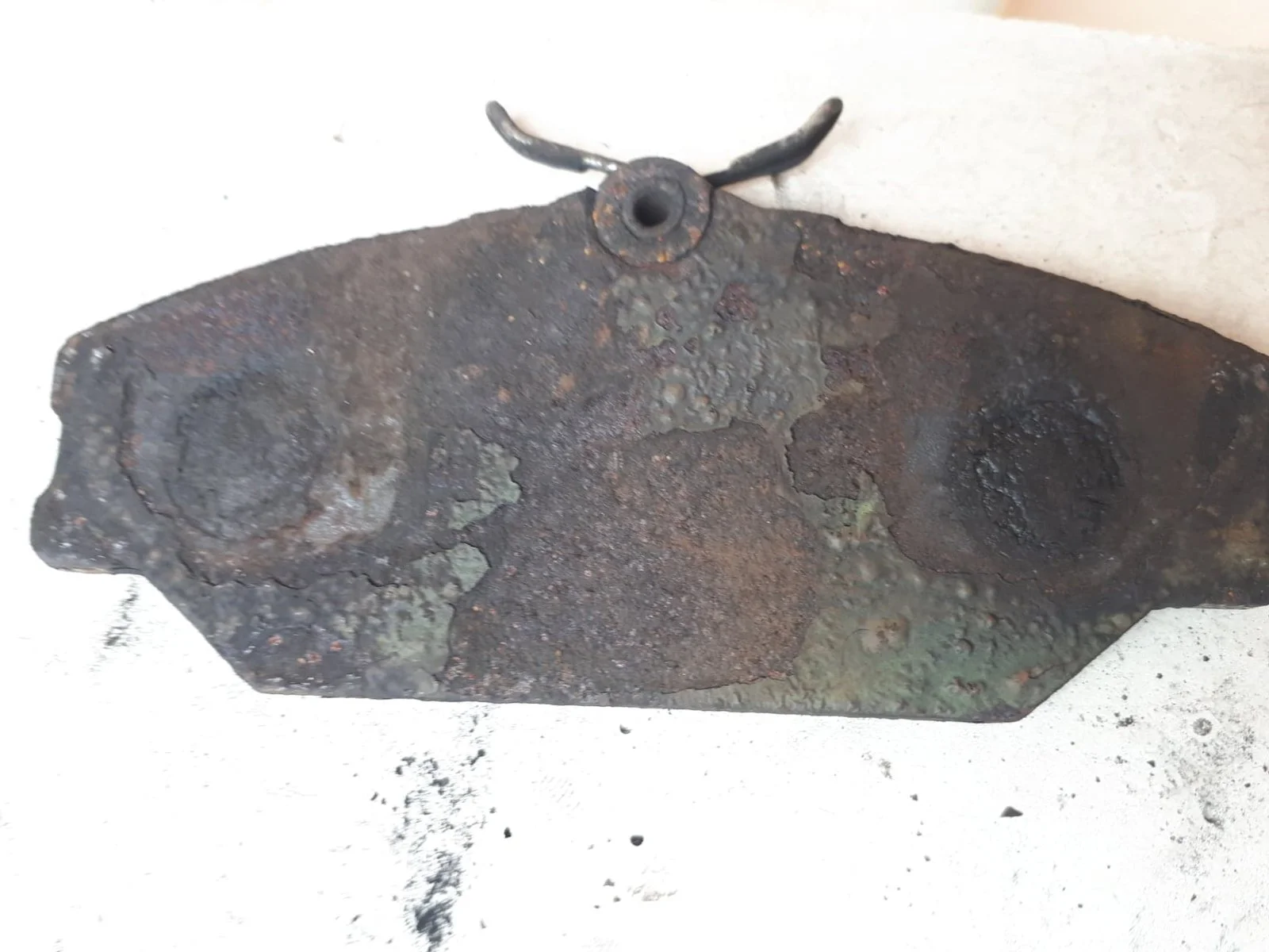

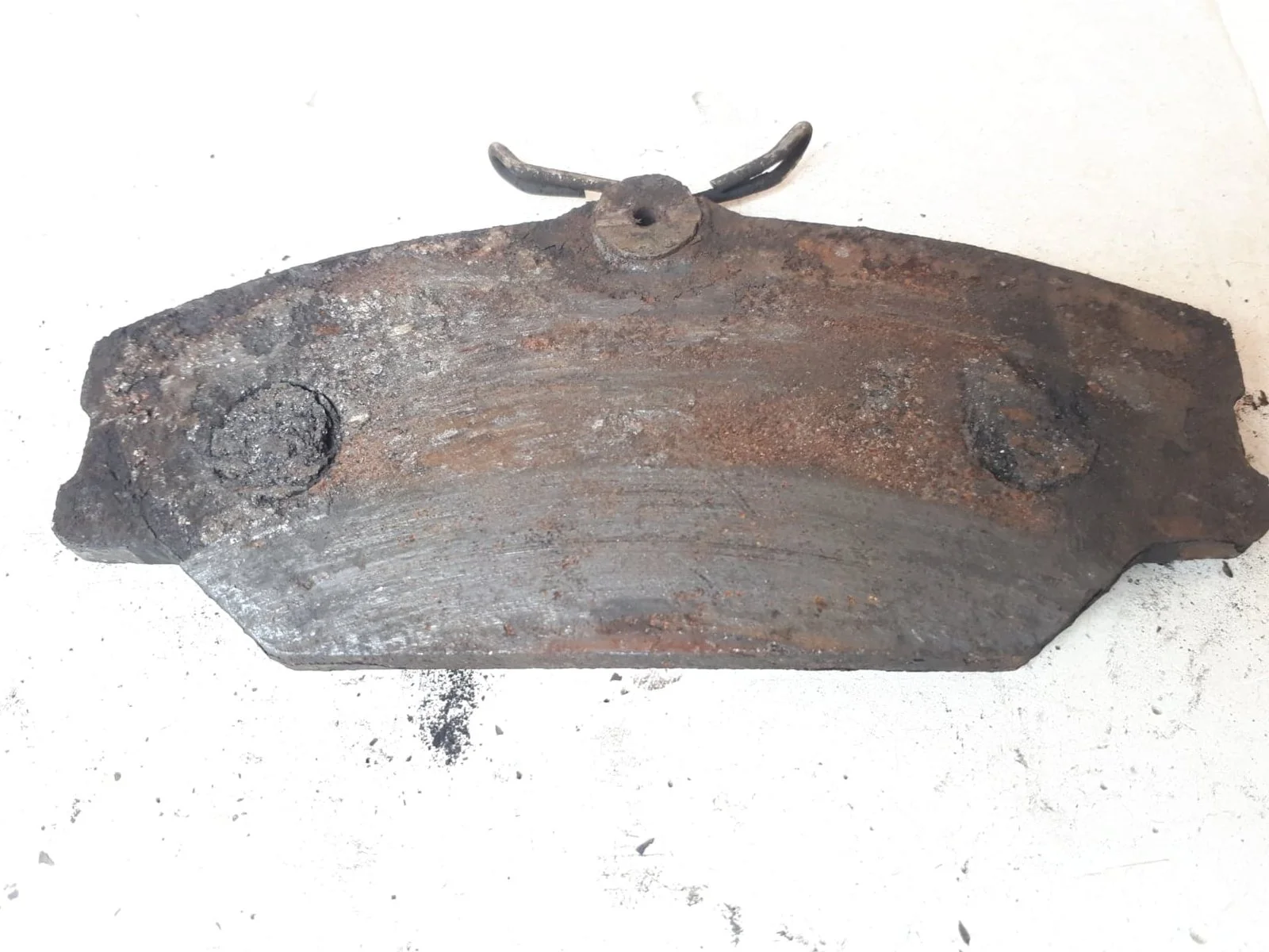

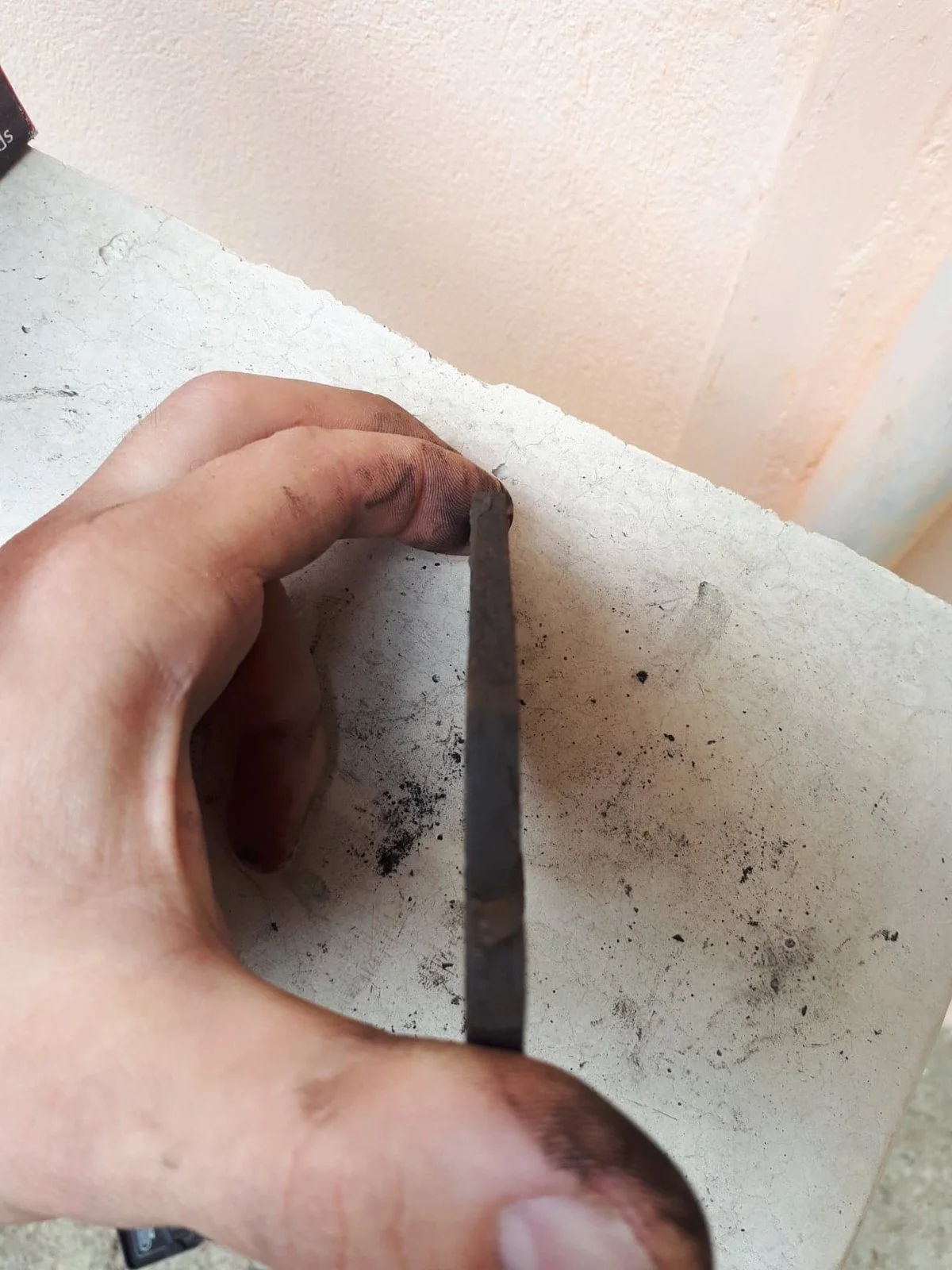

Unfortunatelly a couple of days ago when I left the parking lot I heard a clunking noise from the front axle, came to an imediate stop and found that one of the pads had been stripped of the braking material - part of it remained attached to the front disc.(it's the outer front left pad)

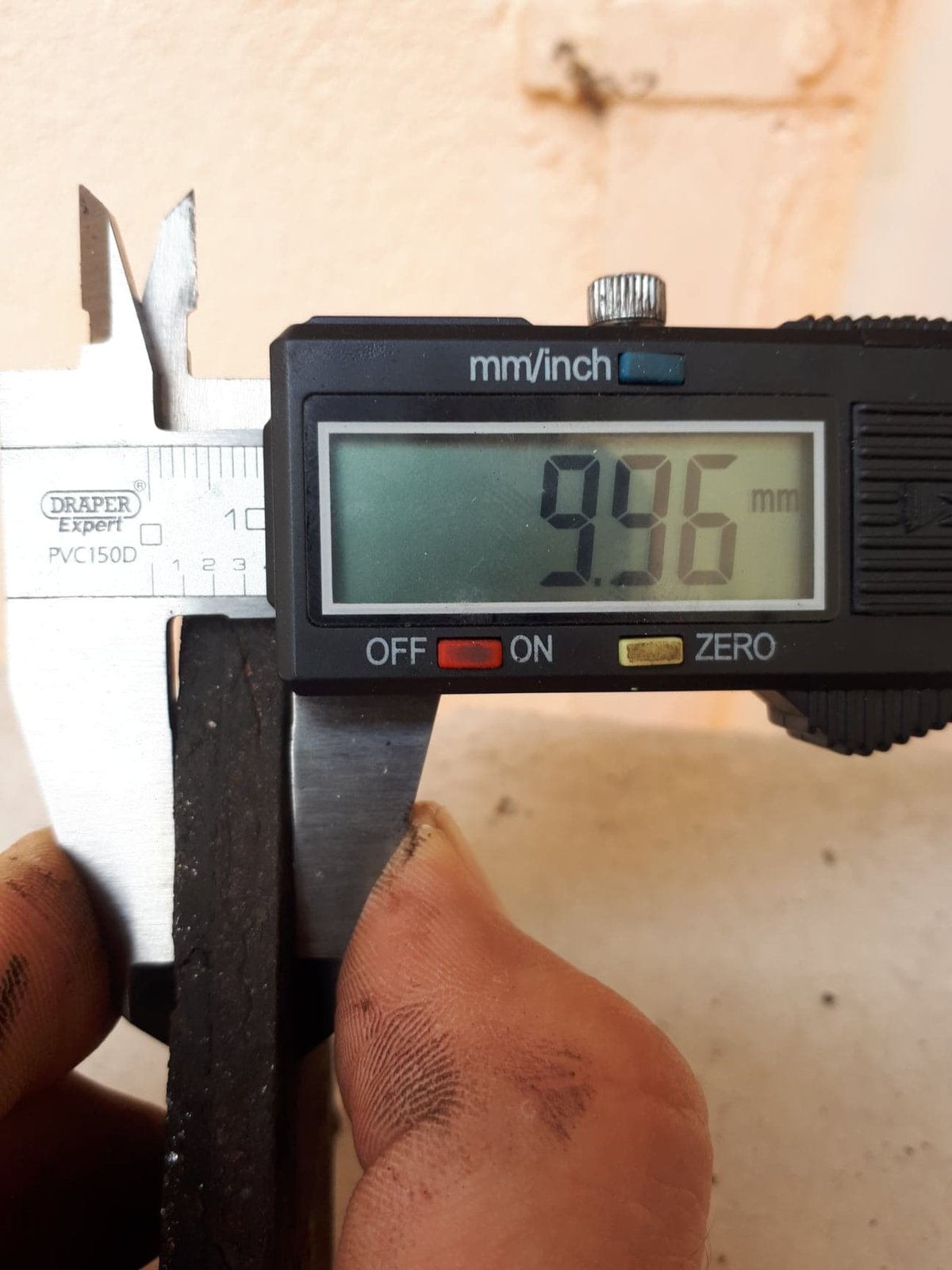

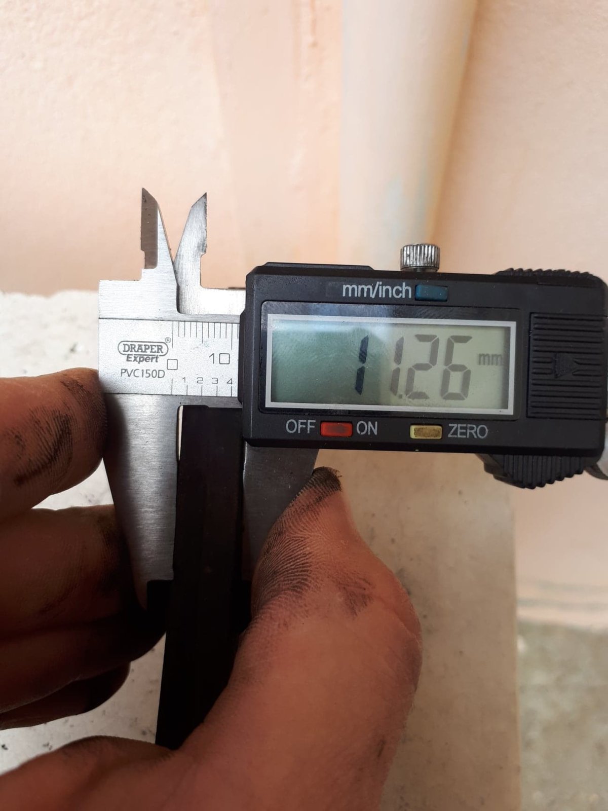

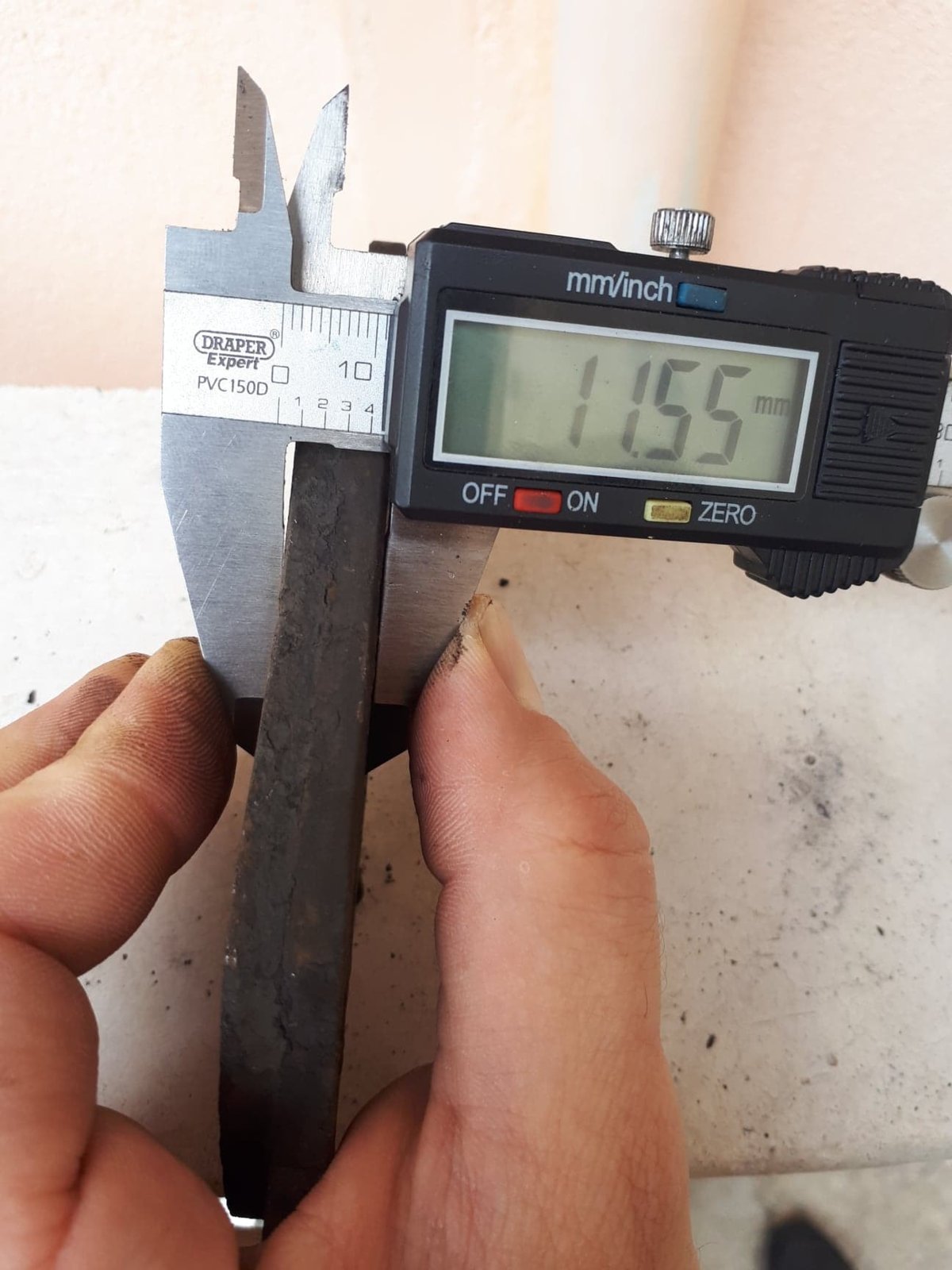

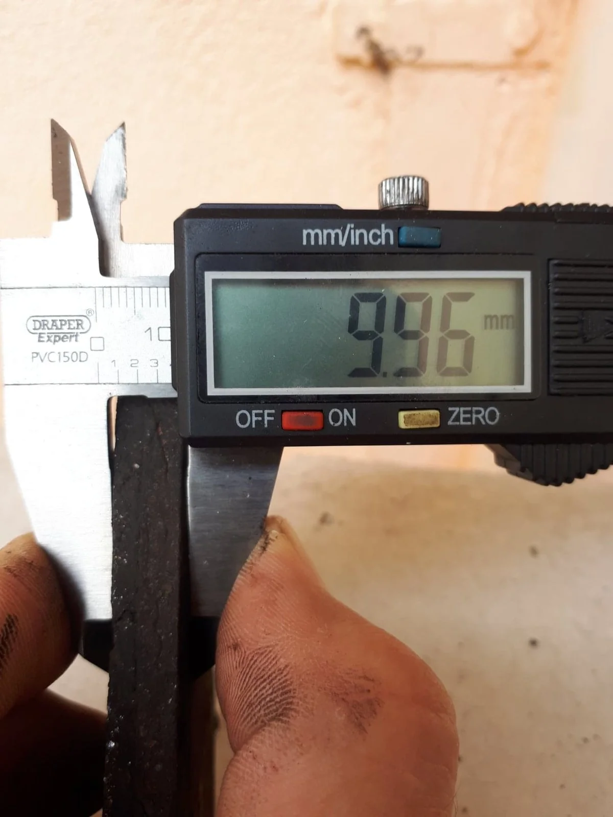

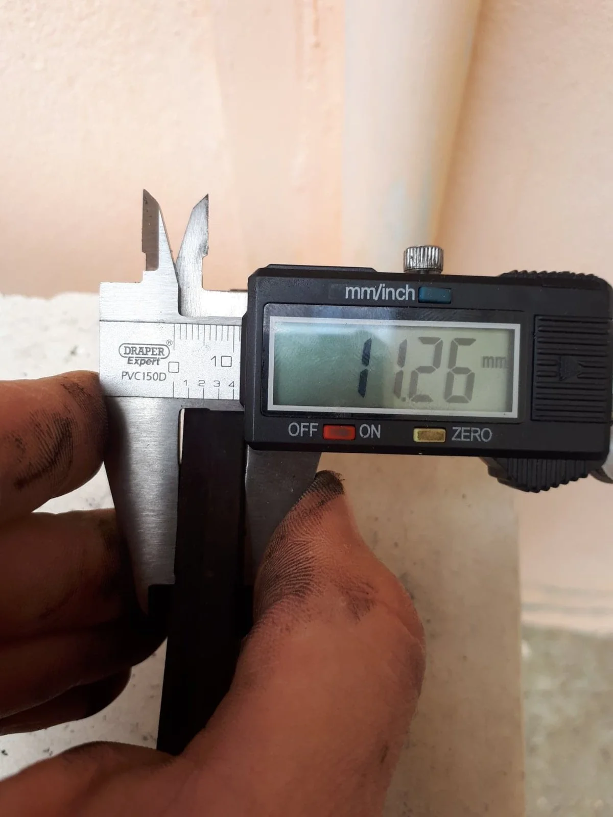

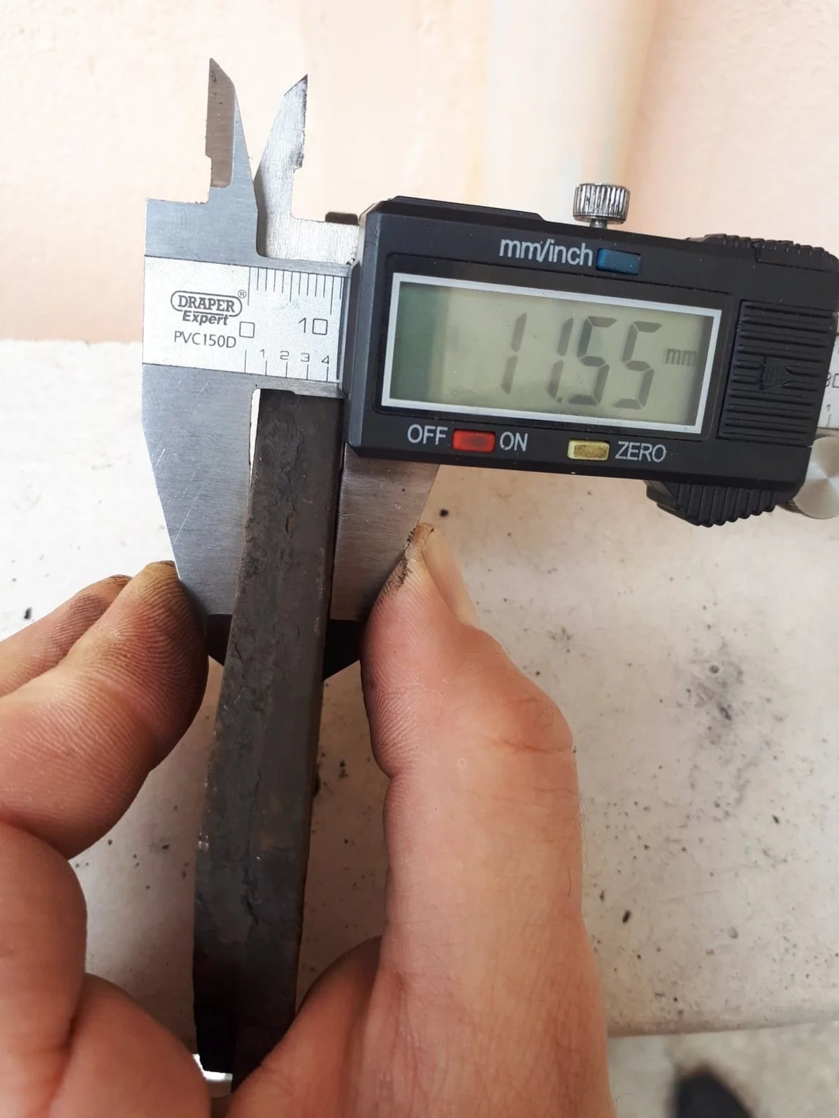

You can see in the pics all of the front pads removed and measured, they are still usable - thickness wise, so they aren't worn out to their limit yet, at least according to the car's owner's manual (also PDF attached with those specs)

"From the pictures you have set us it looks like were the disc has rusted to the pad, this isn’t a common thing to happen to this extreme.
It mainly happens on cars that sit for a while."
I also talked to the guy that sells them here and his answer was smth like "of course this happened, you went on the track, this combined with the fact that they are almost 3 years old and rusty, no wonder the material came off"
I want to know what you guys think, because in my book, after nearly 3 years and without excessive wear and abuse, this should NEVER EVER happen to a pad. I had DS2500 before and they stood up perfectly (never tracked them though but gave them some abuse on mountain roads couple of times) and when they came off the car didn't looked like taken from the Titanic wreck..

Well I bought new pads obviously, but will never ever touch EBC unless I will know that I'll burn them pretty quickly because it seems that they don't do well against time.
What about someone that has a weekend car and does 1000 miles per year?? Is that person supposed to change the pads every 2 years to avoid failure even if they're barely worn out? The DS2500 even had the backplate paint intact after more than 3 years on my car, not a single hint of brake material crack and got them even thinner than these.

If left to the elements brake pads deteriorate, especially track pads. You think of the cold, hot, wet, dry cycles they go through along with them sticking to discs with surface rust and being ripped away when moving away.

Track and race pads are not like OEM road pads and should not be treated as such. Really an owner should be maintaining a higher level of care, inspection and maintenance to their car than waiting for something to fail before replacing. This is not a failure of the product.
