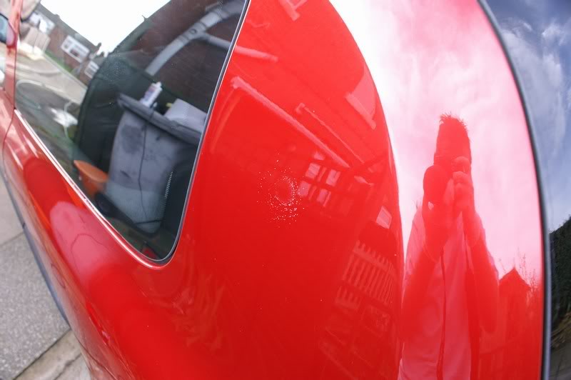

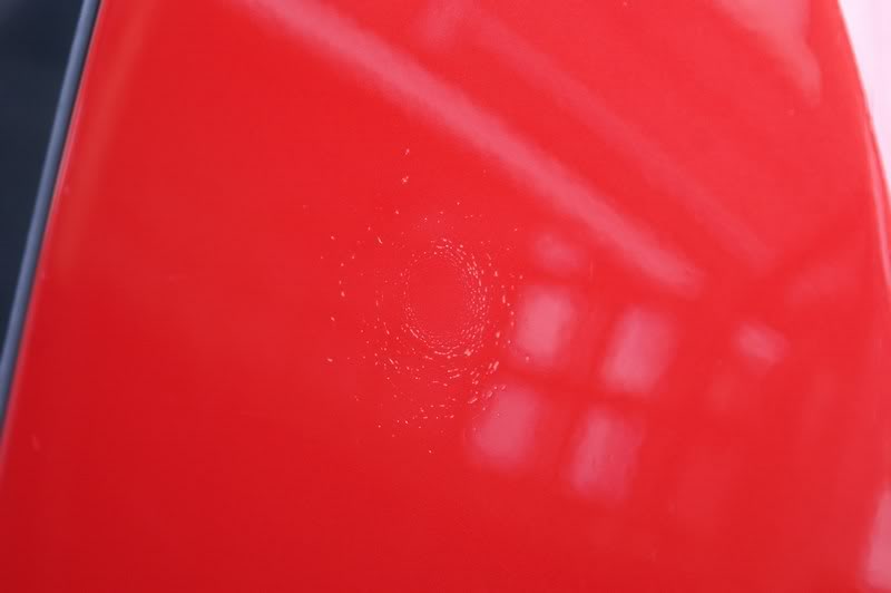

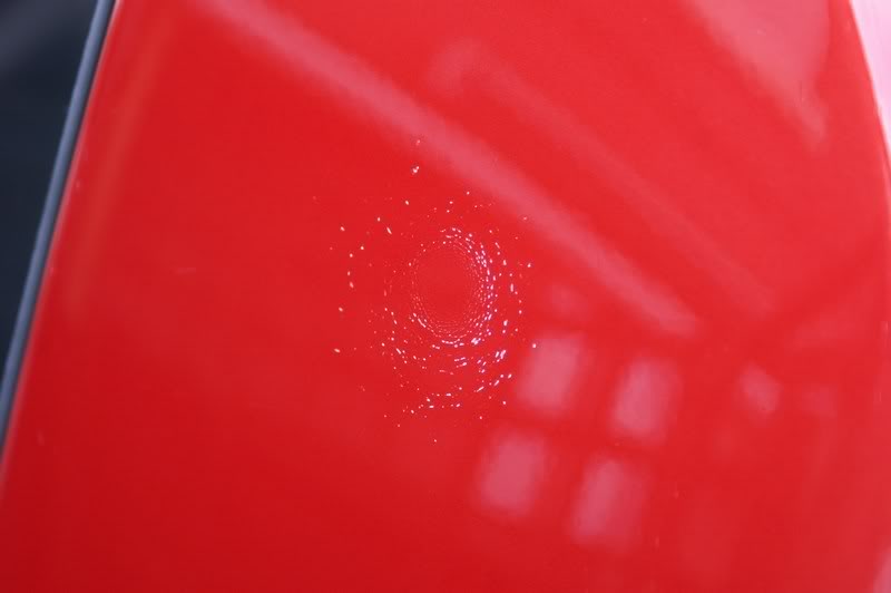

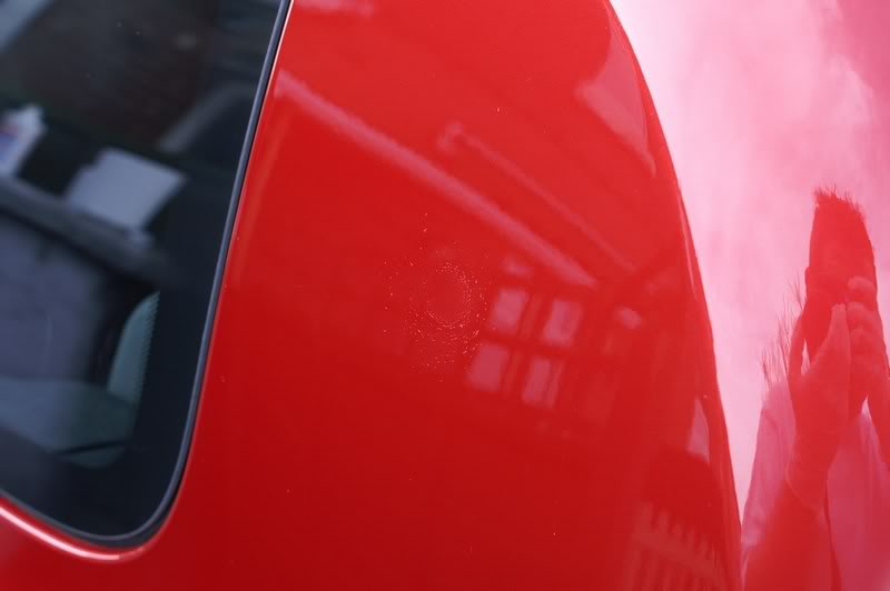

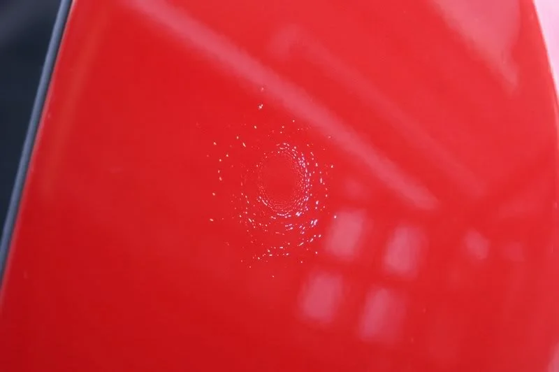

With a bit of time and patience (and a touch up pen, wetsanding and a pc) it's possible to improve the marks.
  Mk1 Maxim Sport
Cheers for all the advice folks. the pictures that "al" posted above are exactly the same as the mark on my car. its pretty much identical so u have more of an idea. iv tried tar and glue remover stuff and that didnt work either, may just get it sanded down primed and respray it. cheers all.

The glue and tar won't work as the marks are deep into the paint. If wet sanding and polishing does not sort it you will need some paint.
