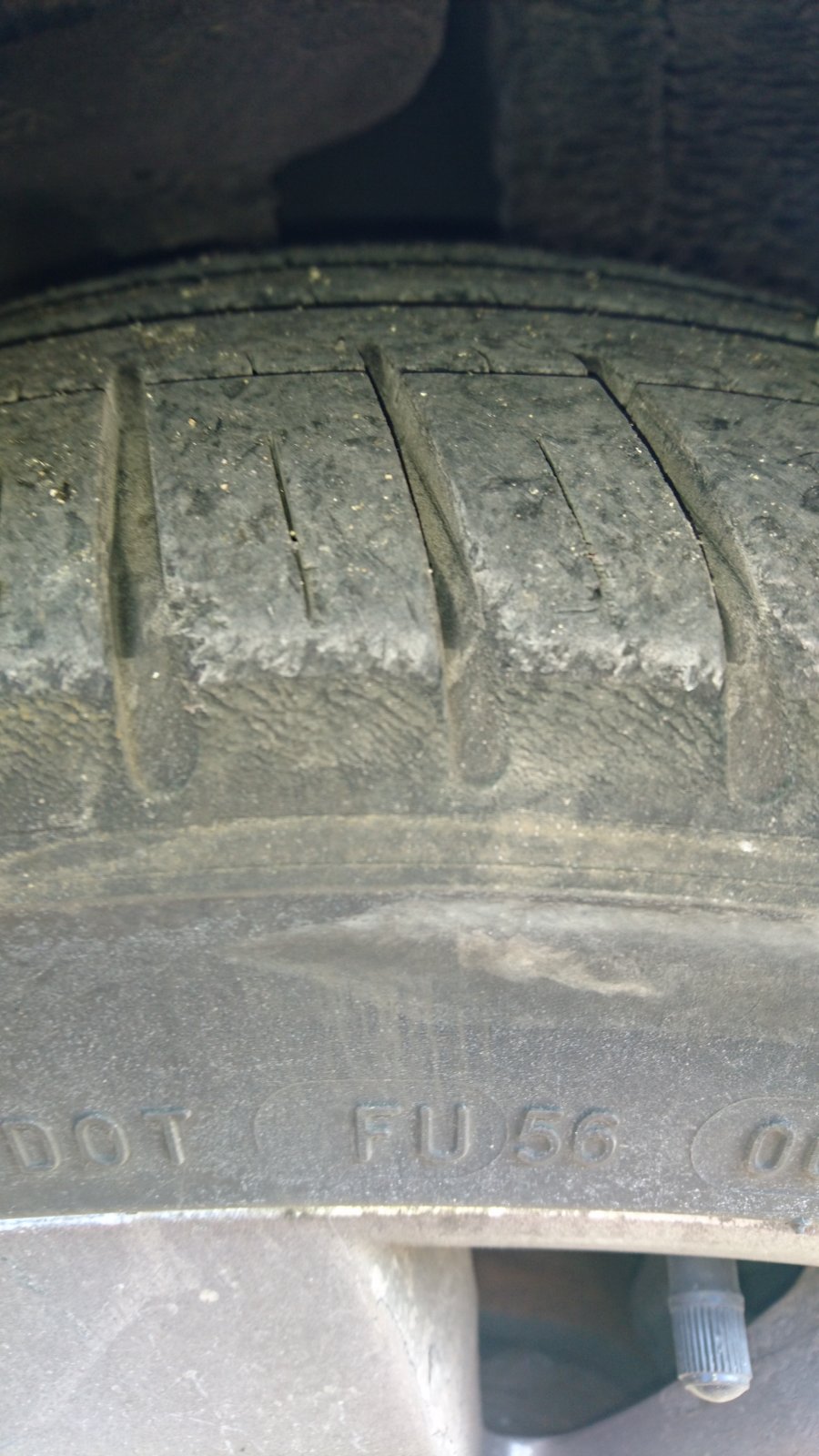

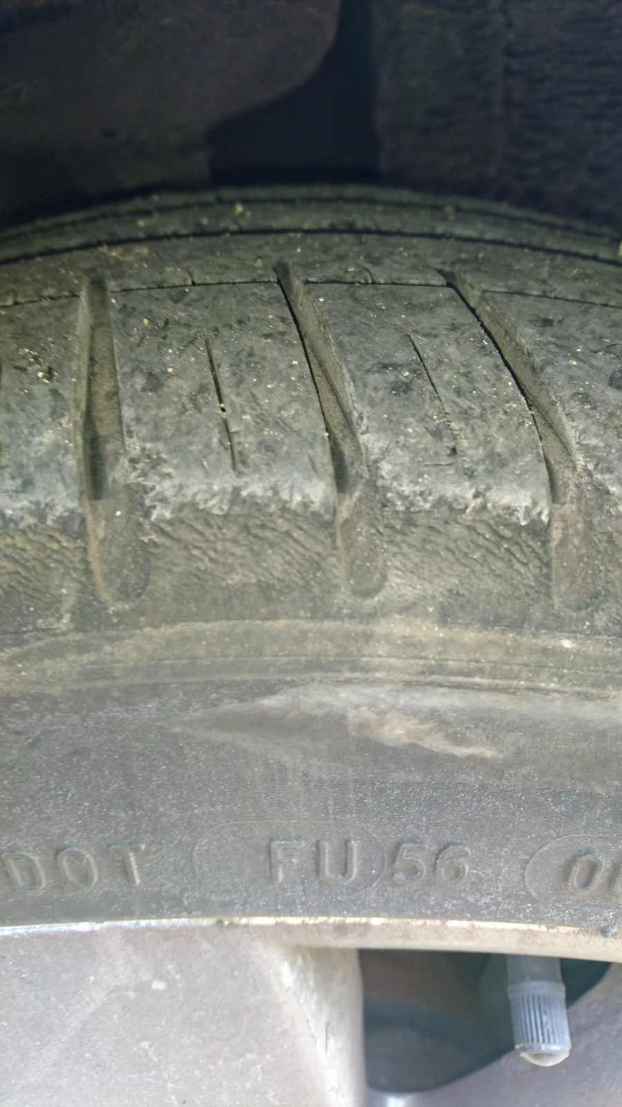

The front half (bottom that tucks under bumper) is not fitted at all. And it's gone through that hitting the metal lip and shaved a chunk off the tyre. Maybe 195/45 would be a little better as it's only slight by the looks of it... But loud enough!
  Clio Sport 182

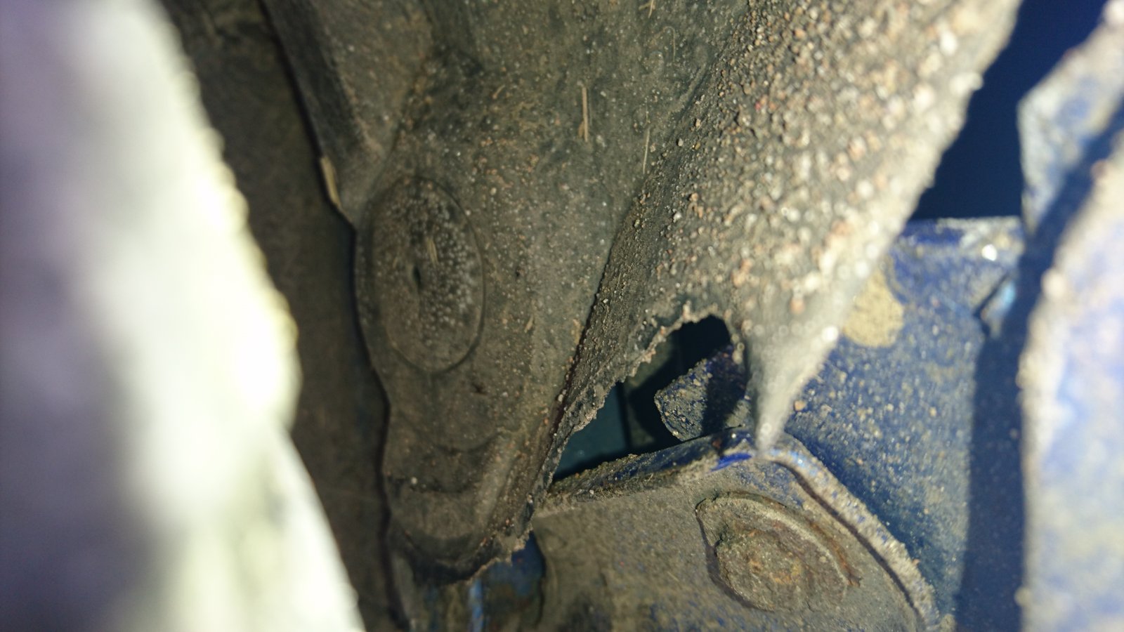

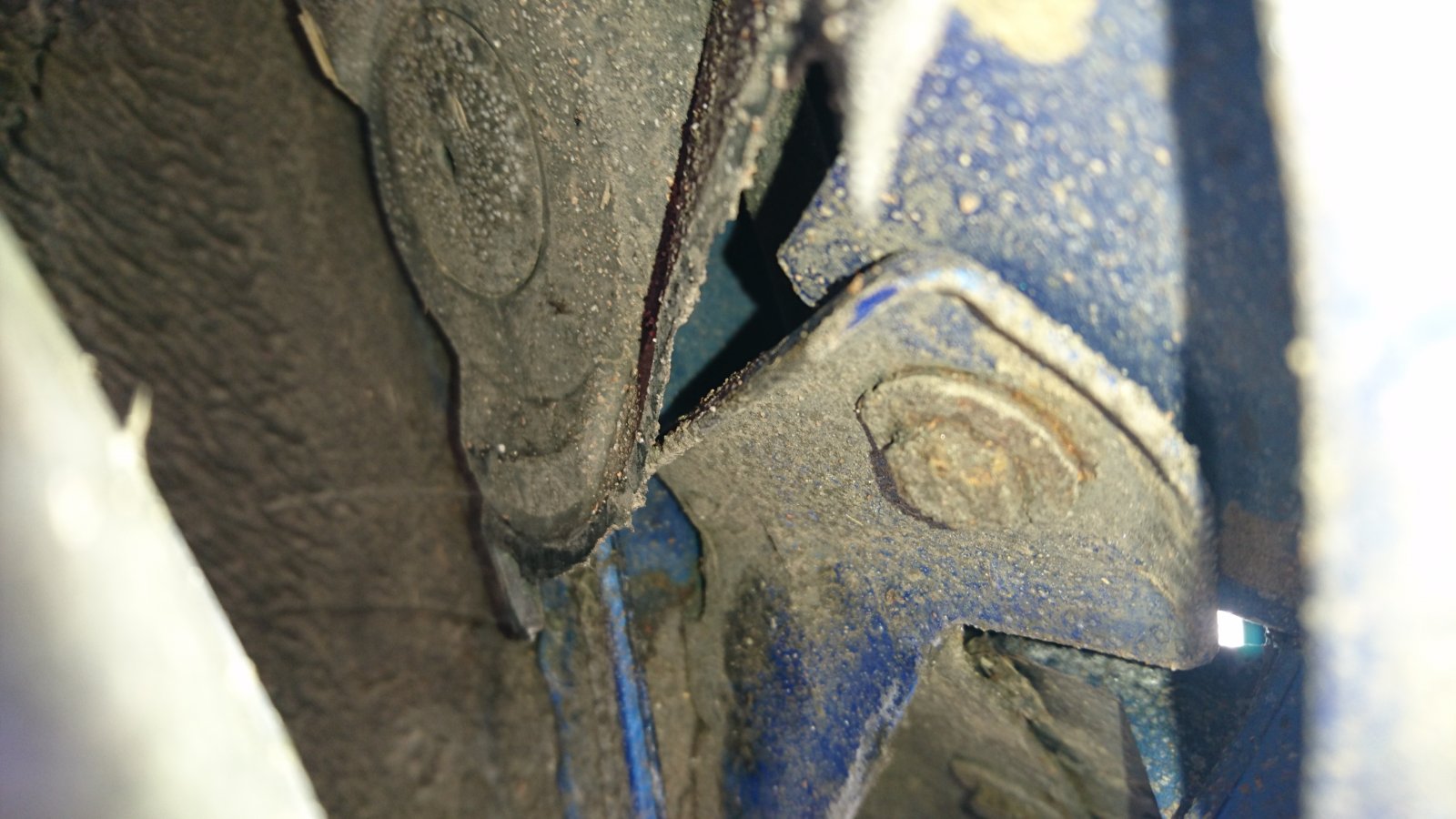

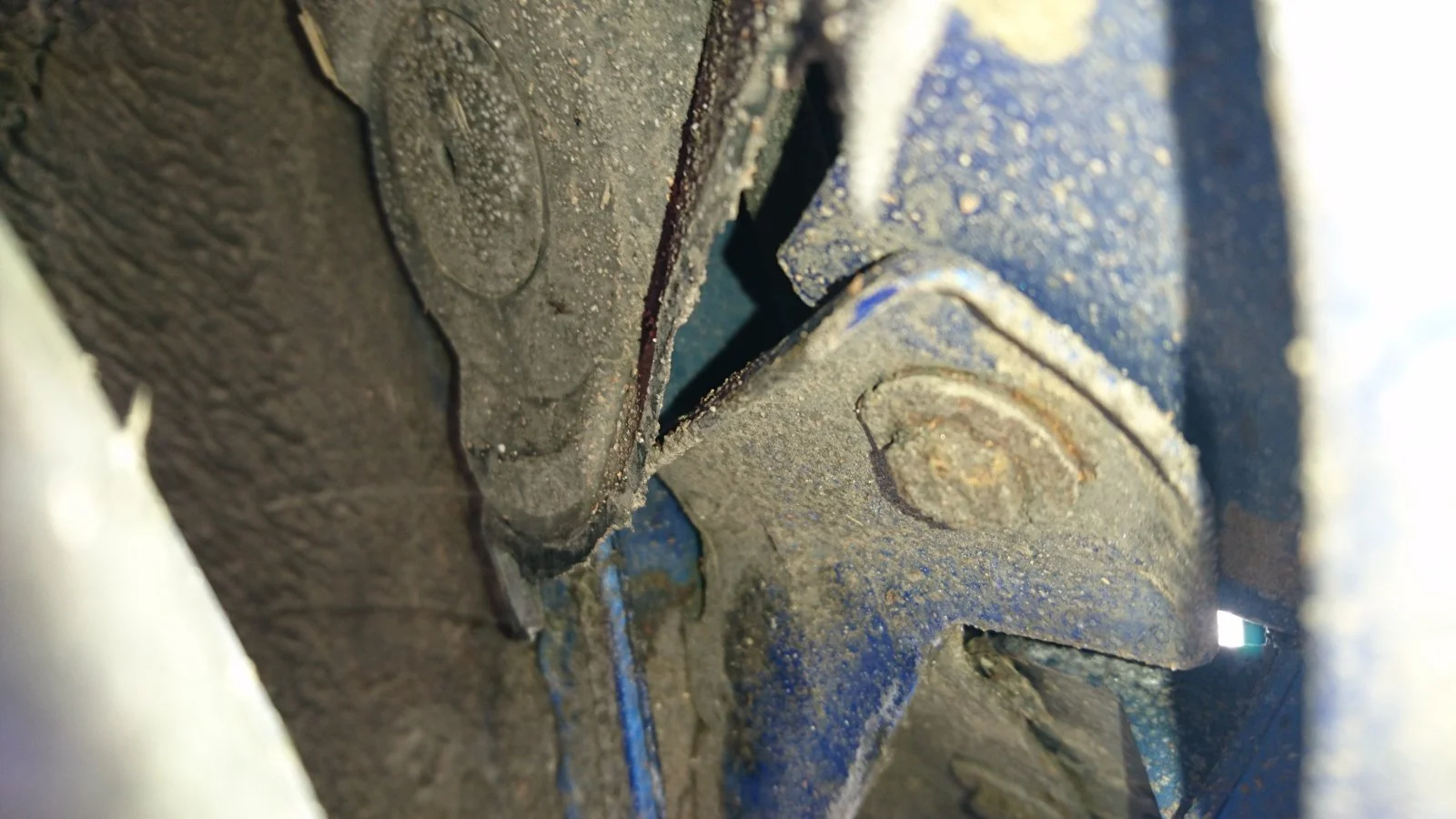

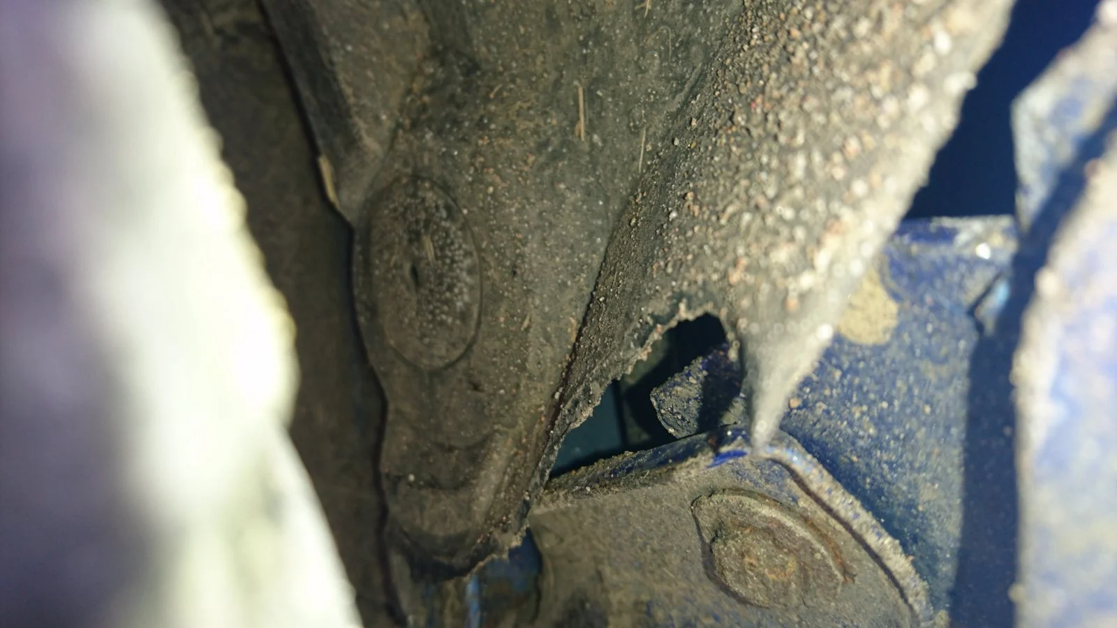

Here's some crappy pictures as I don't have the keys on me to lock the wheel

On the picture similar to this above, it's rubbing on the lip to the left of the bolt. This one shows the liner better
Edit- this is drivers side, and outer part of the arch. Obviously when I'm turning left and the cars leaning right the outer tyre is hitting into this. And the same on the passenger side too.
