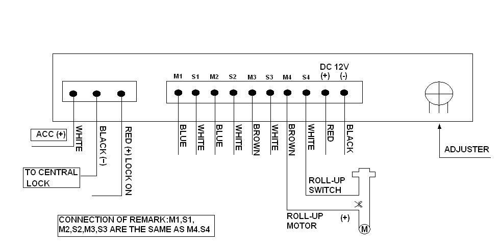

Does anyone have the wiring diagrams for a 182? Im specifically after what whire dos what one the door loom and the colour as I have a closure kit add on that needs to be wired to these. Any help would be appreciated. thanks
Here is the diagram that came with the closure kit
