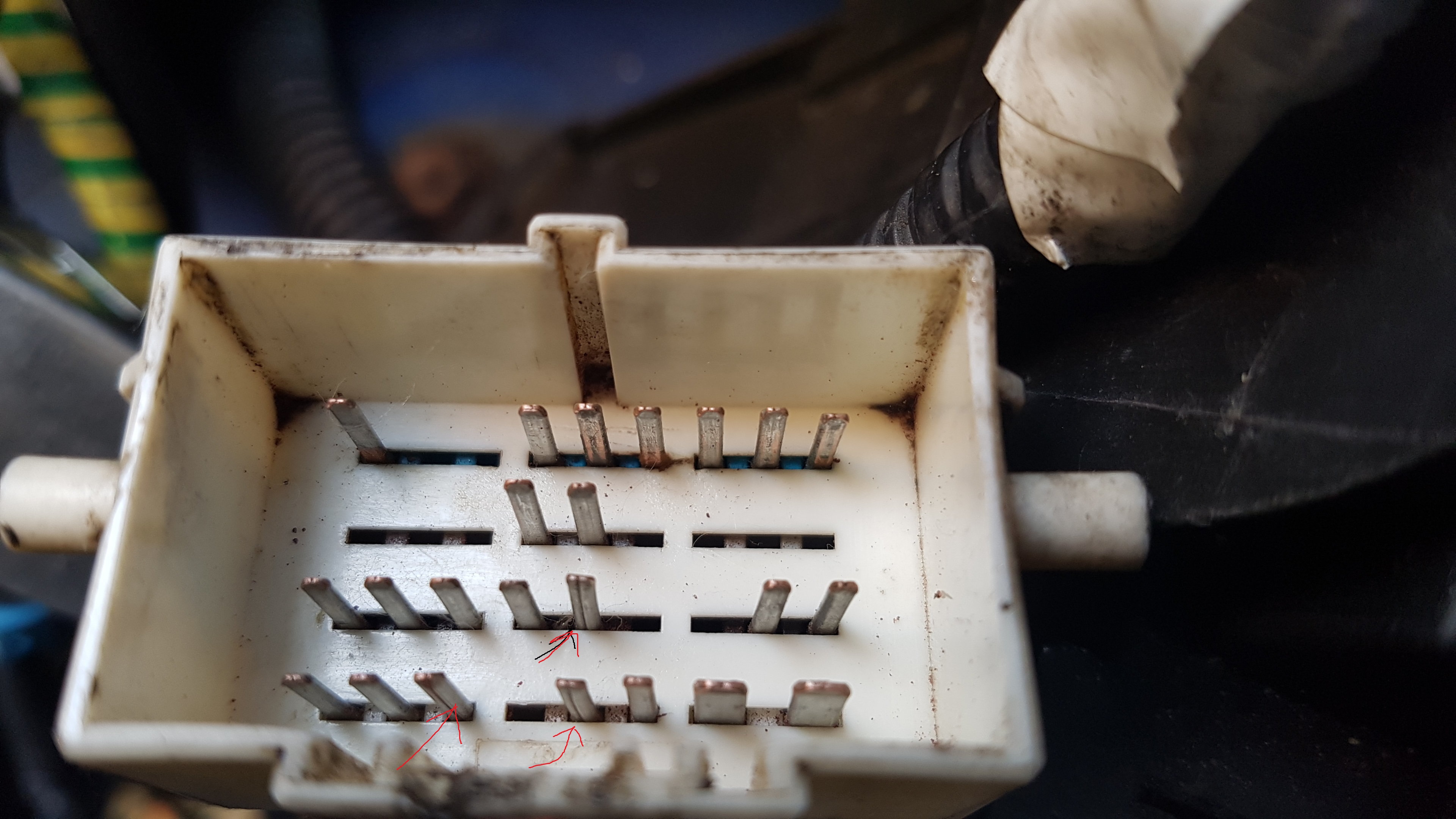

Clean all the relays & the pins in the white plugs.
