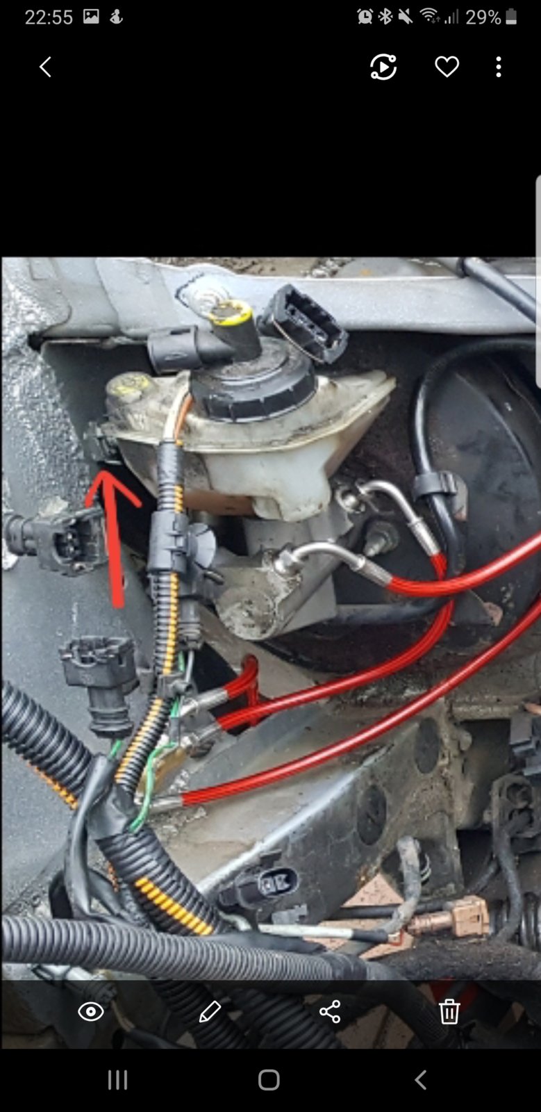

Never knew of the one above brake fluid res. Is the earth under scuttle panel?
Its here ?
