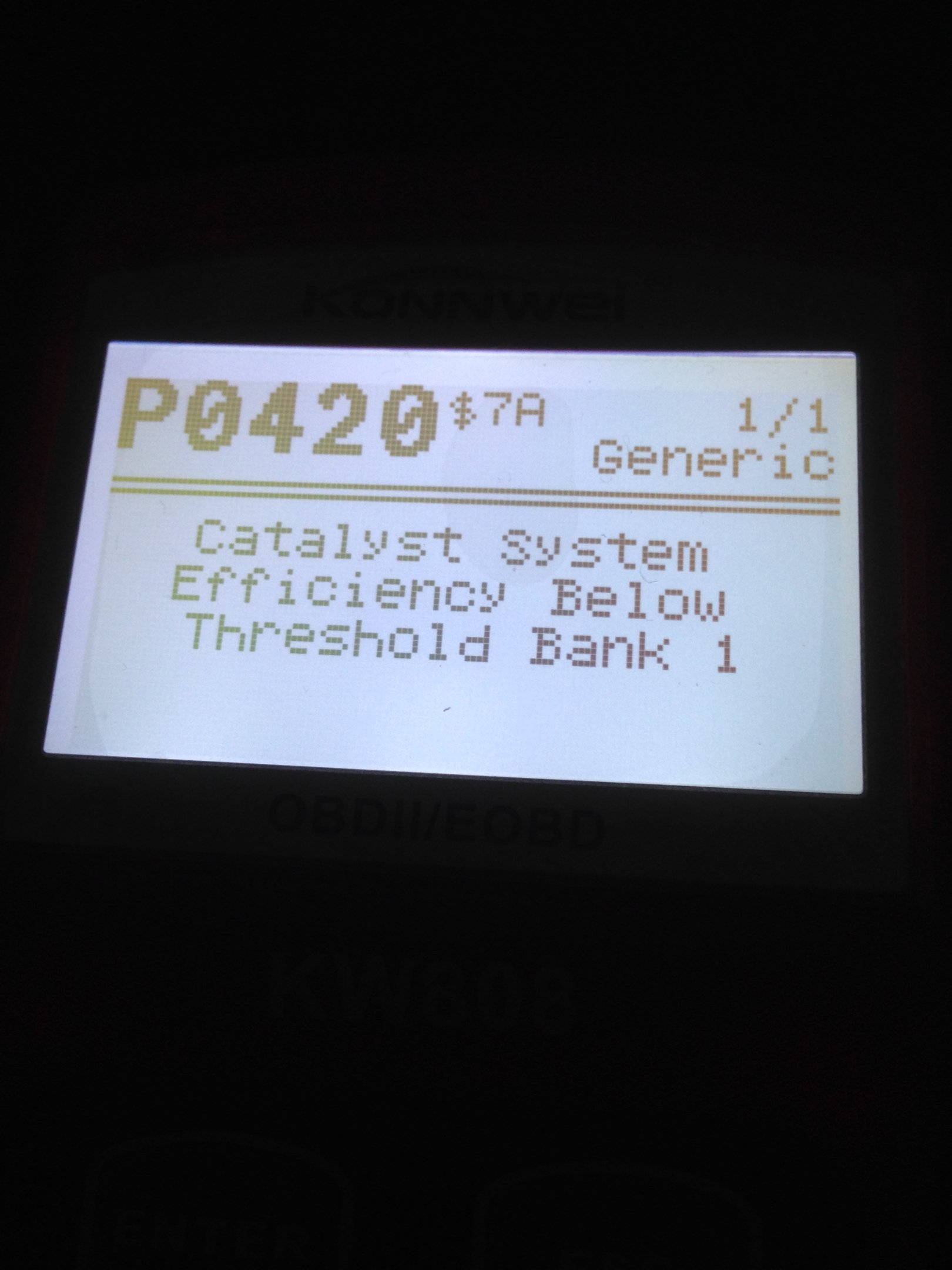

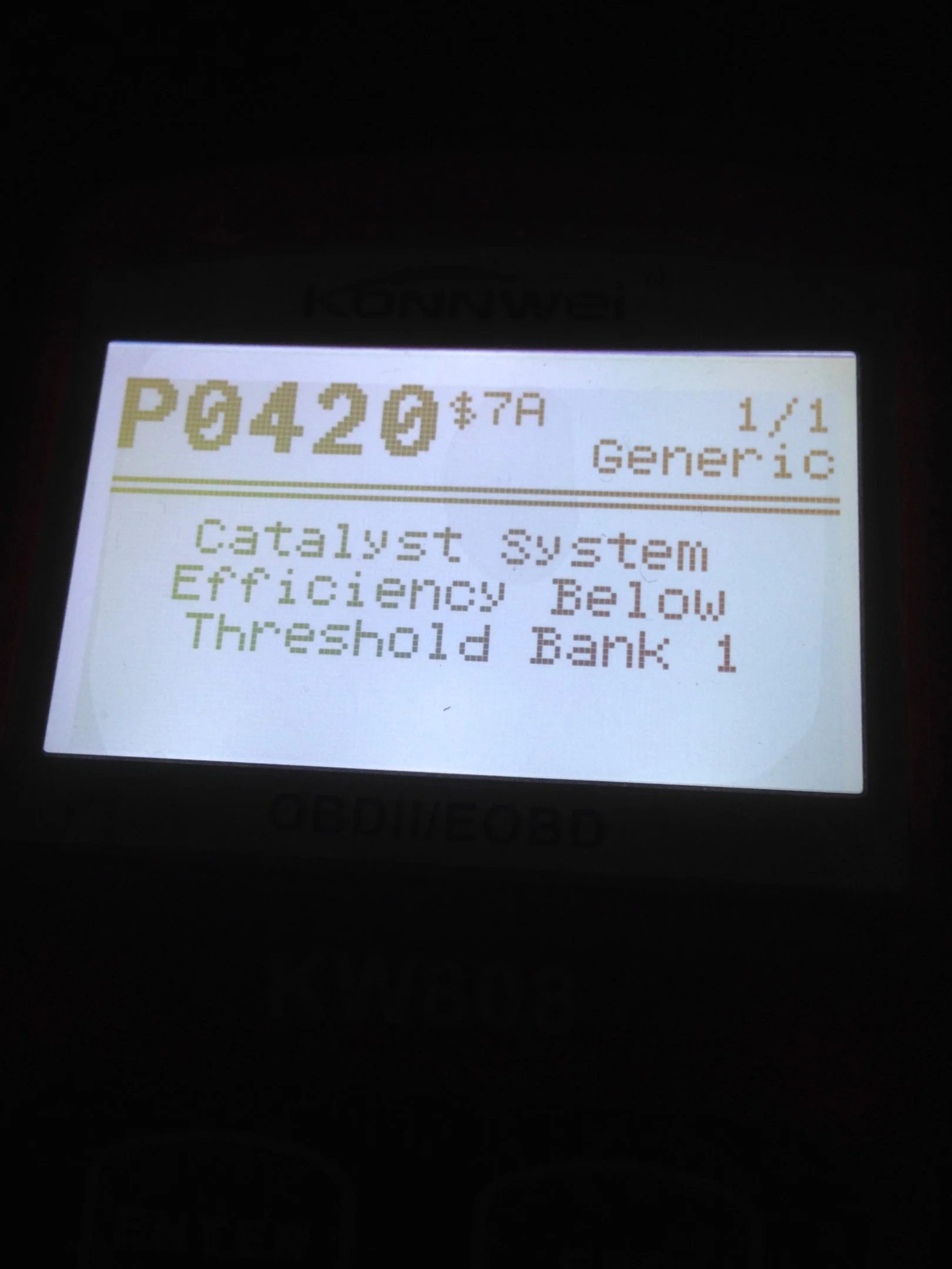

Just got my new code reader on it and it's relating to the cat again.
Assuming the cat itself isn't on its way out, O2 sensors the likely culprit?

Try swapping the lambda sensors round . Could be your Cats knackered or blocked . I saw one on here not that long ago that was blocked . If you do a search you might find it.
As above take the cat of and hold it up to the light, should be able to see trough it, any dark patches means its blocked in that area.

Given it was November when it first appeared and has only just re-appeared, is that likely to hint at one or the other?
that's your precat lambda, nothing to do with the cat. graph the lambda and see what it's doing, chances are the misfire has killed it off.
i won't say i told you so :tonguewink:
What exactly do you mean by 'graph the lambda'? And do you mean it's killed the cat or the lambda?

will of killed the lambda, the cats take all sorts of abuse.
need to look at the lambda and see how it's switching, range and frequency of it. or if it's done over about 80,000 miles you may as well just bin it and stick a new one on, think the recommended life by bosch is 90,000 miles?
