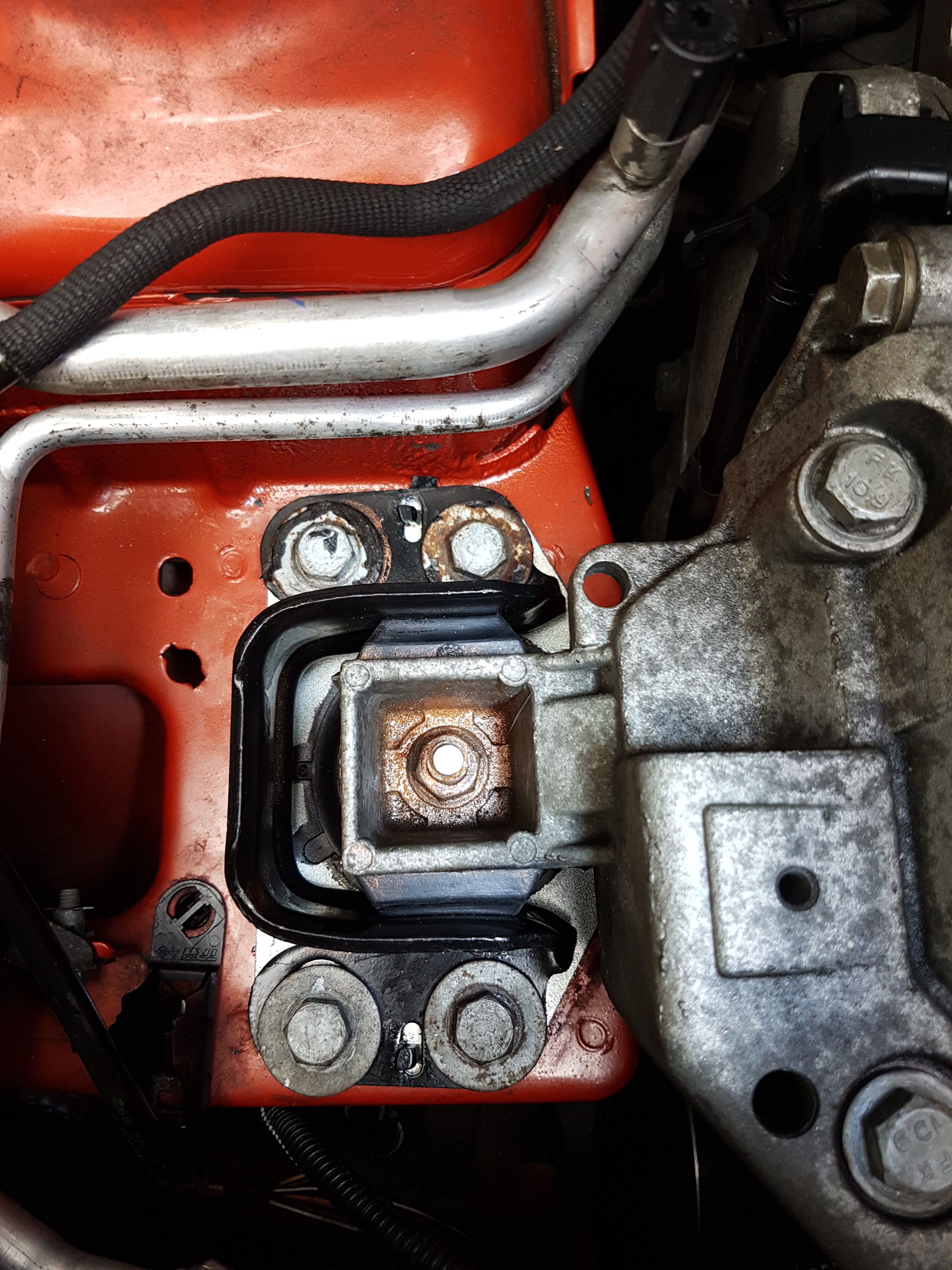

Done and replaced with a Febi mount.
Rubbers seem quite far over towards the engine rather than in the metal 'casing'. Didn't notice this on my old original oem mount.
Normal?
Just been for a quick blast. Seems much better and no gear stick wobble at all.
When changing the gearbox mount, it did seem to drop suddenly a shift slightly. Doesn't seem to have made any difference though.
