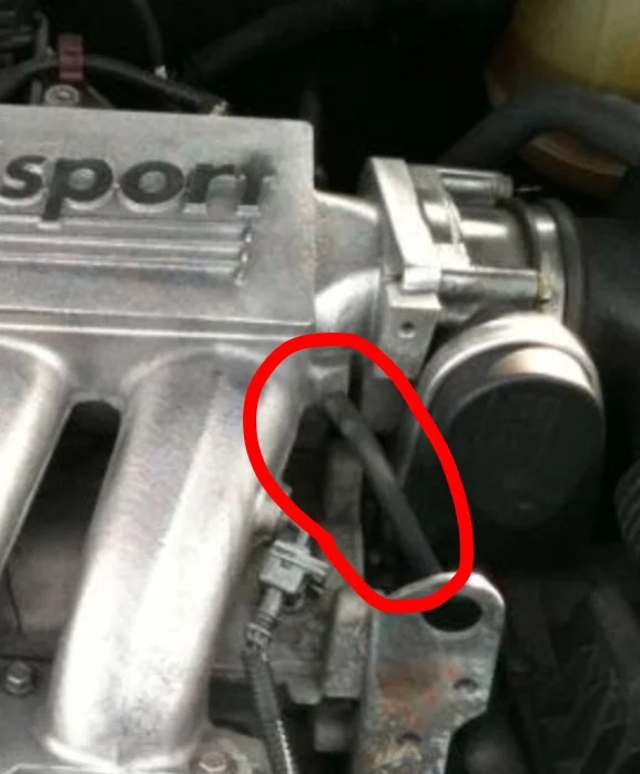

I popped open my bonnet today to find the hose photographed openly swinging around. For the life of me I can't locate where the far end of it attaches to - any ideas?

Vacuum hoses.
That one controls the acoustic valve.

Will the fact it's disconnected affect the performance in any noticeable way? Or can I just yank the thing off and remove the acoustic valve altogether when I get a couple of hours?

The acoustic valve is located behind the LH (UK passenger) wheel arch liner.
Removal offers no performance gains or losses other than weight loss.
You will need to cap the vacuum take off nozzle to avoid a weak mixture/high tickover.
as long as you blank it off it's fine to remove.

Many thanks for the replies, pipe is now capped and car feels good as ever. I'm guessing it had been disconnected for a while as I only discovered it by chance whilst cleaning the engine bay.
