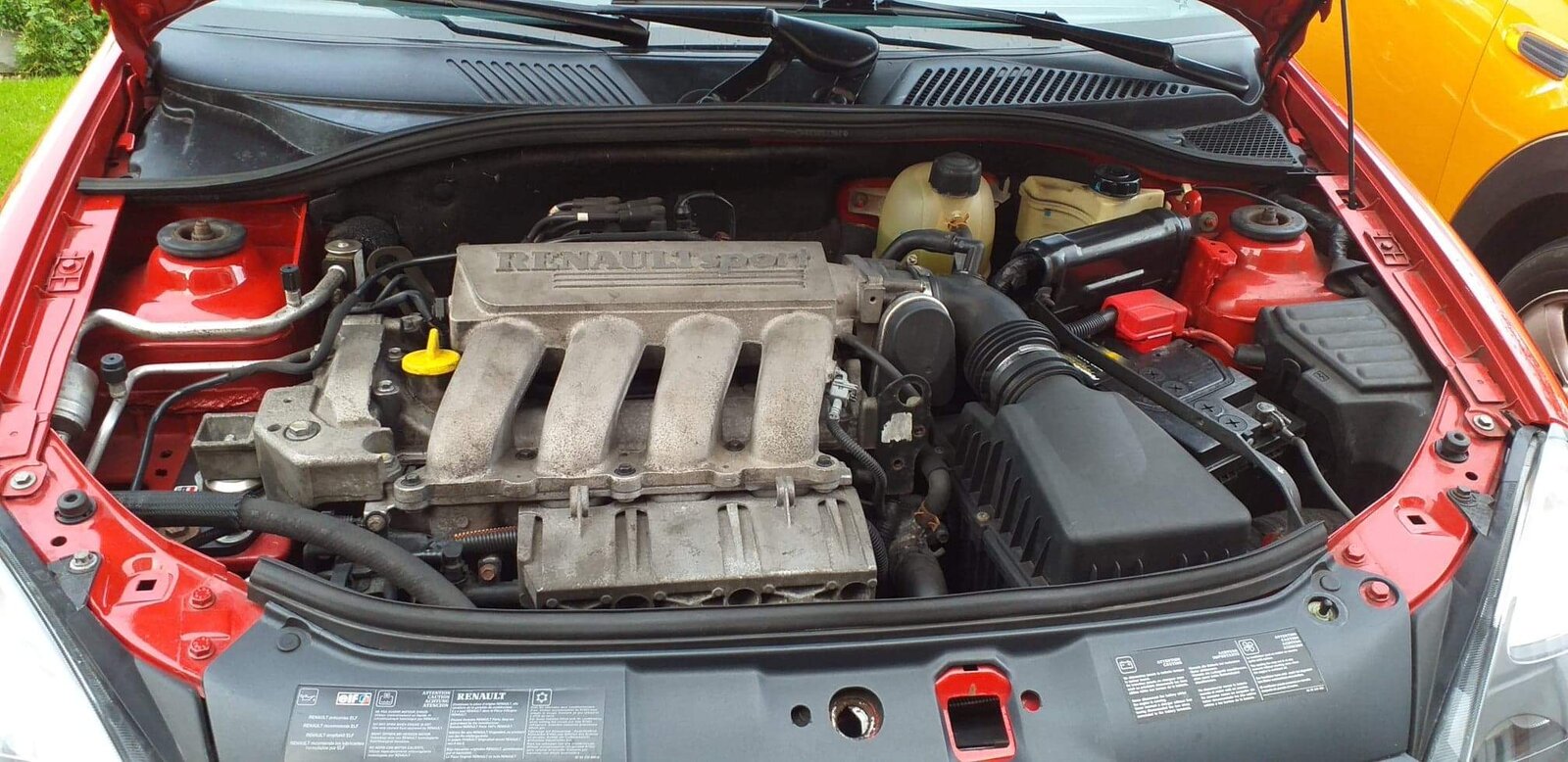

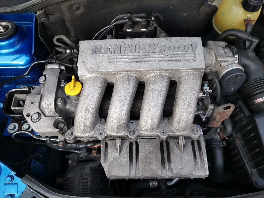

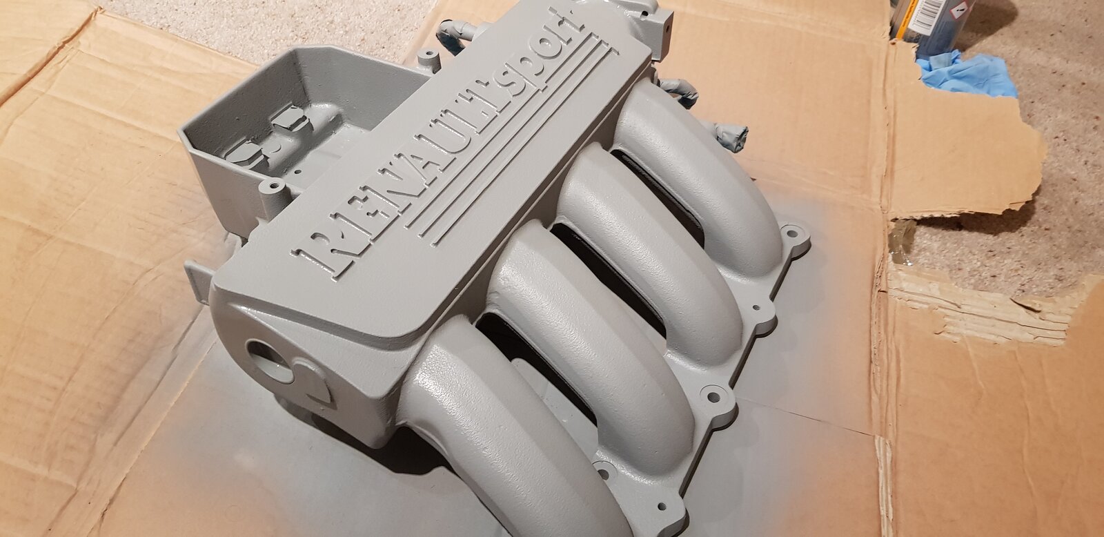

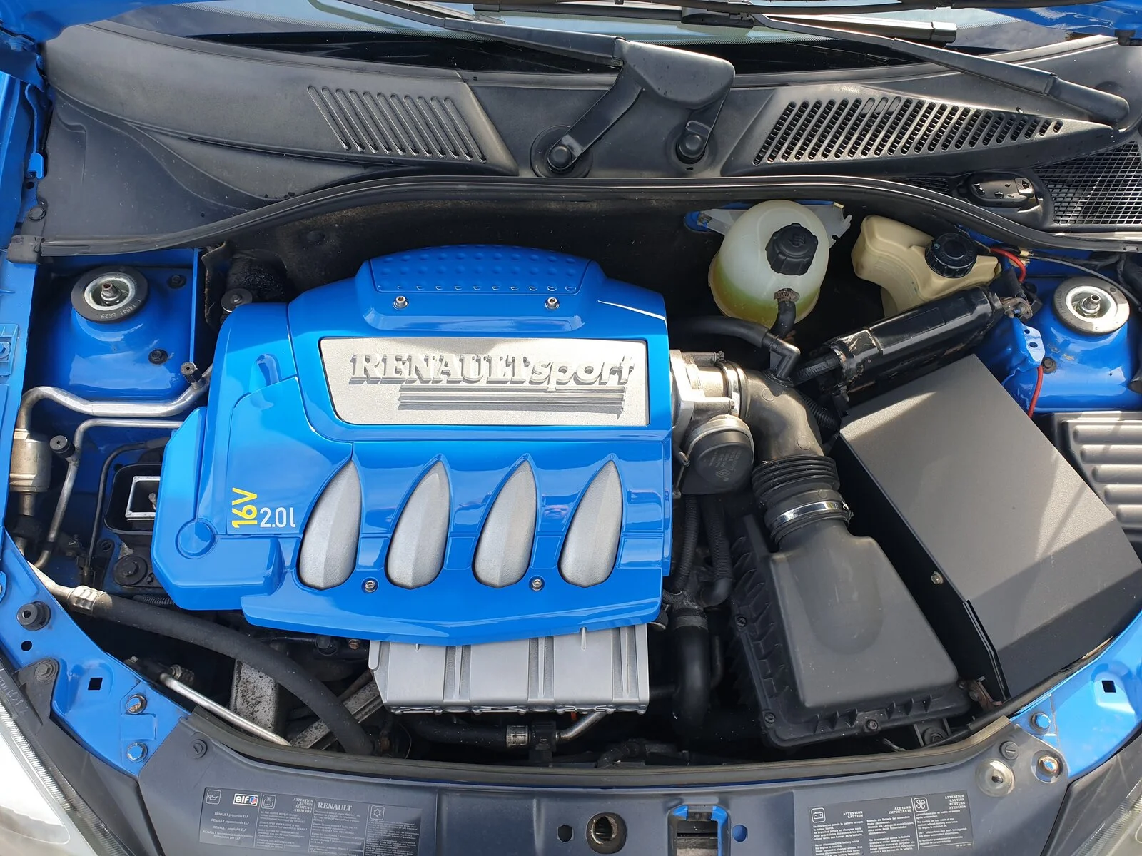

I'm in the process of refurbing the inlets, fuel guard, cam cover etc. Basically anything that's silver from factory. (see image)
I've heard Vapour Blasting is a good way to good, anyone have experience of this?
My question is, if I want to achieve a factory finish. Which method is best?
- Vapour Blasting.
- Powder coating.
- DIY Spray Painting.
Please advise if you have a company in mind from a good experience too.
Thanks,

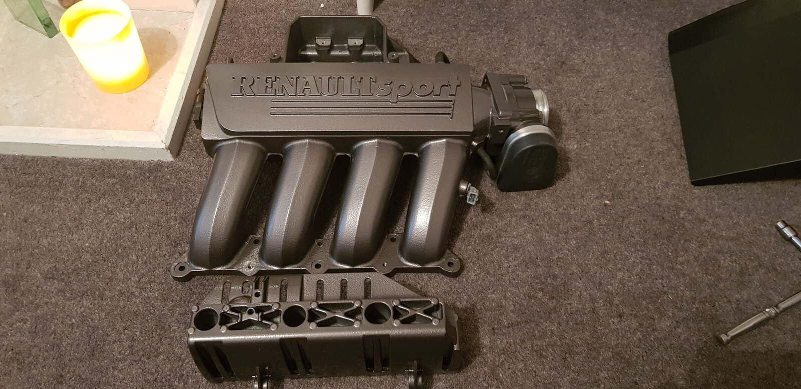

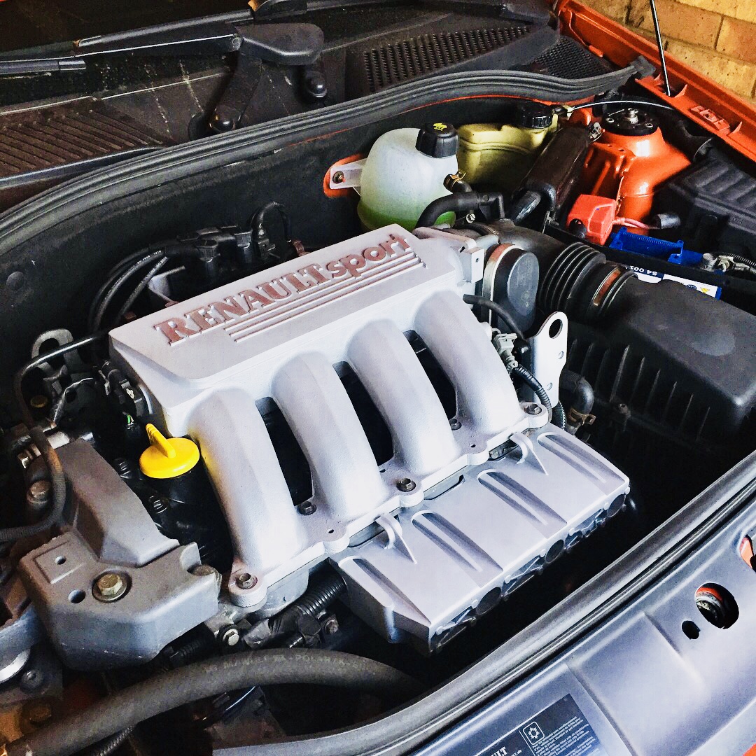

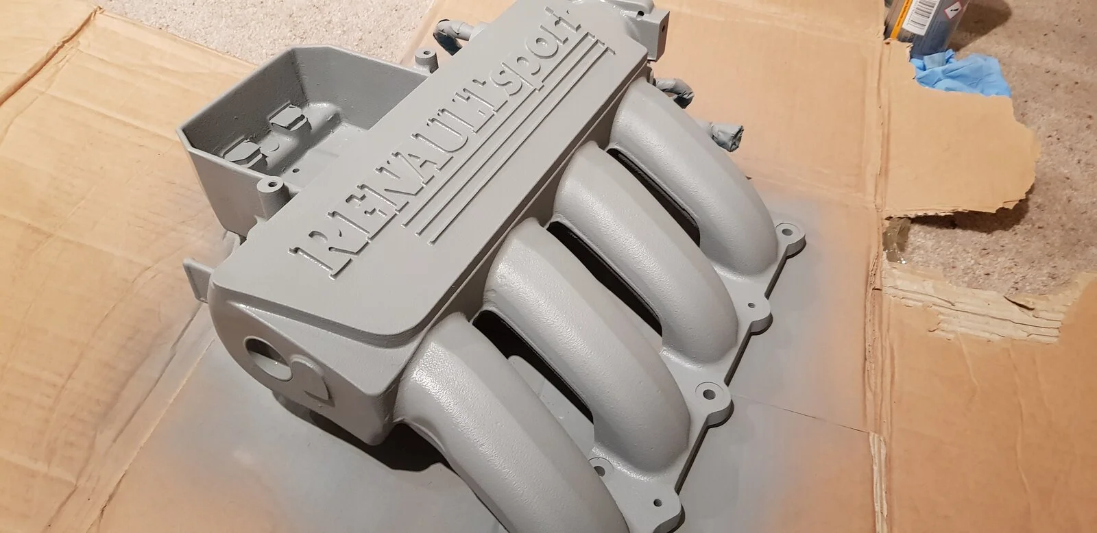

I used hammerite smoothrite rattle cans, 1 year on and alls good

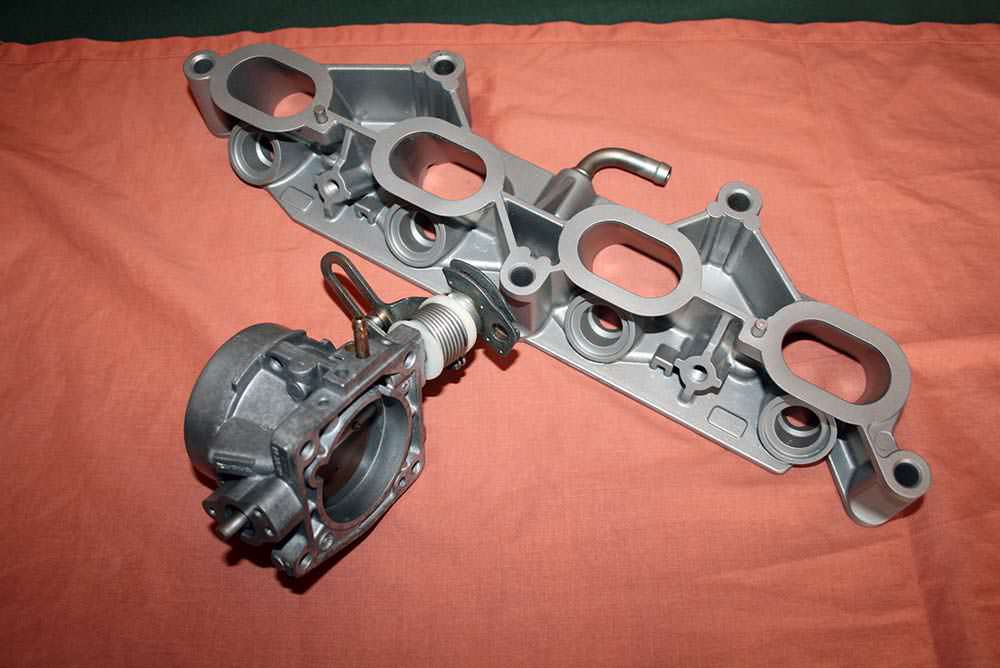

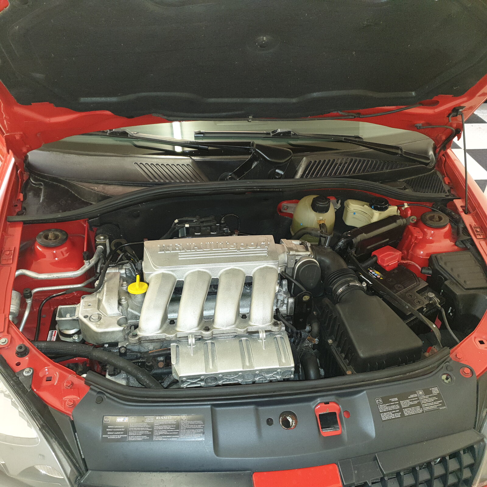

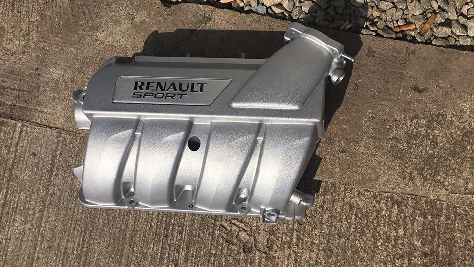

Vapour blasting gives the best OEM finish imo. Paint looks good at a distance but still looks like paint up close which isn't ideal imo if wanting standard silver look

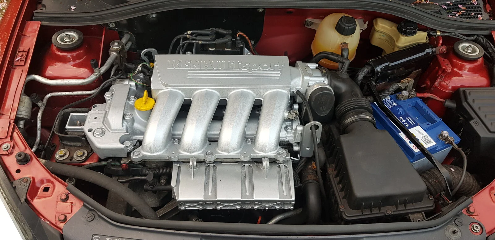

This is vapour

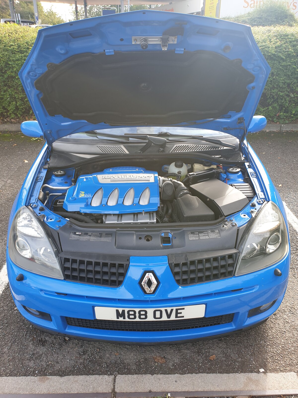

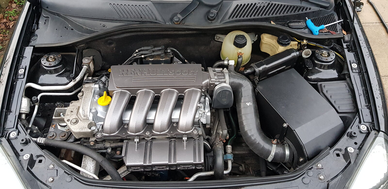

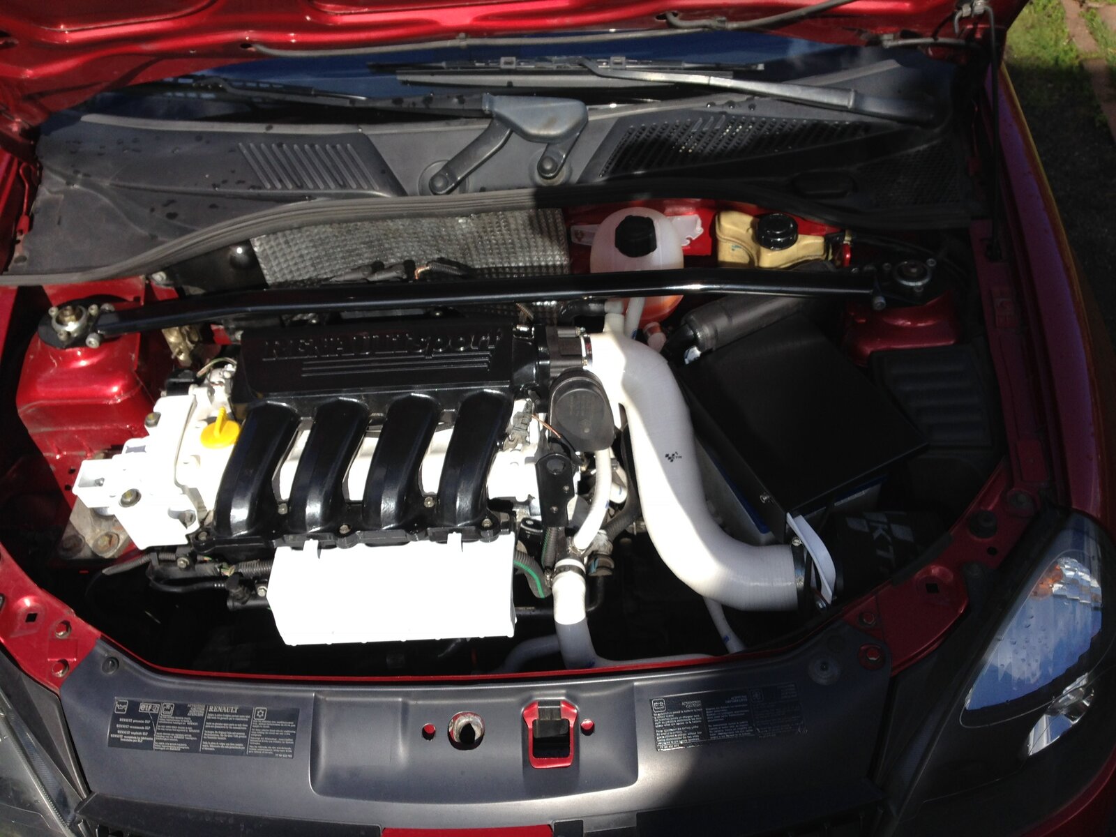

Another vote for vapour blasting. I painted mine and it was an absolute ball ache. Yeah, you can get it to look good, but for the hassle and effort, vapour blast by someone looks very good value for money to me. Here was mine pre and charger. My second piece of advice, don’t paint anything white;

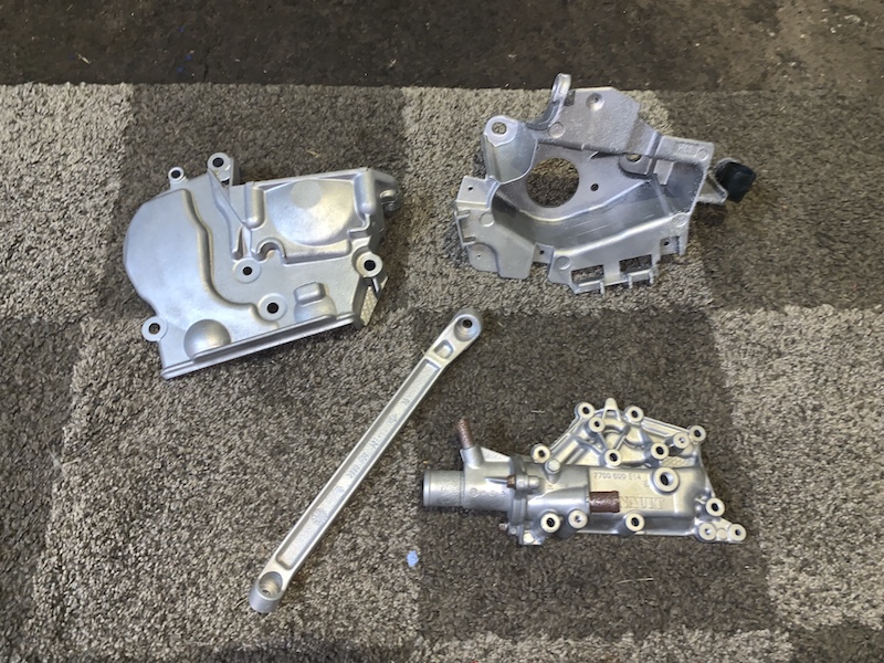

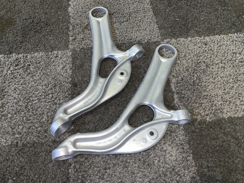

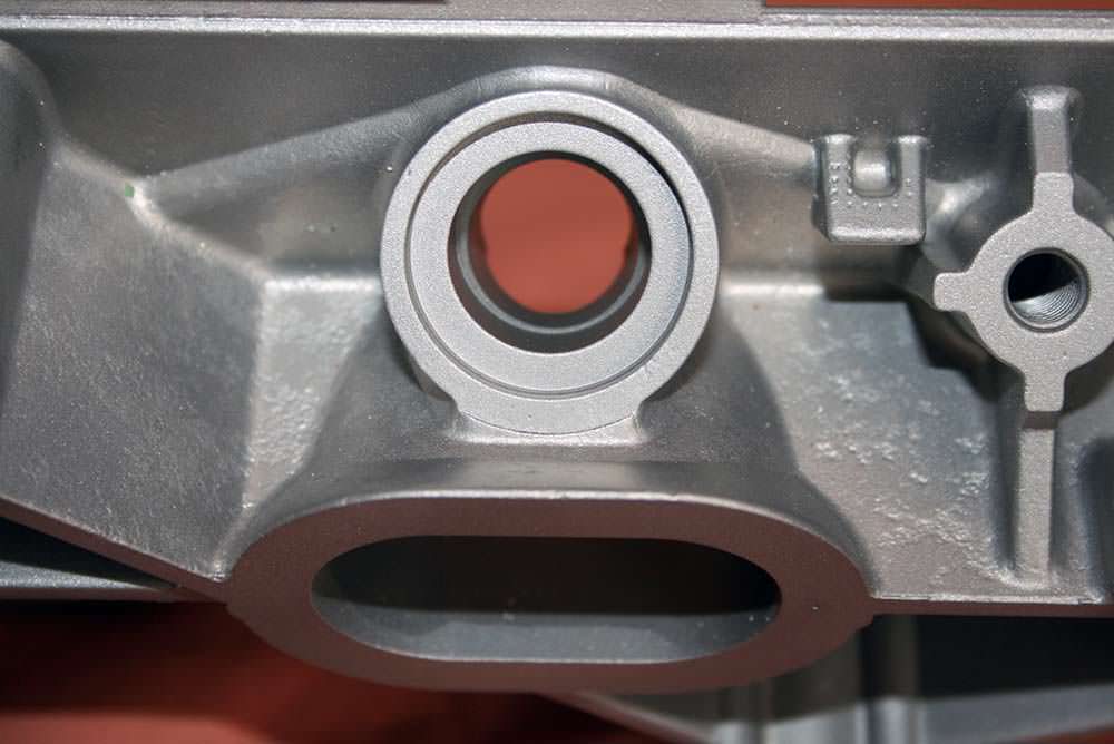

Vapour blasting gives a real nice finish and fetches off all the staining without removing much metal, close up below. (not clio parts though)
As a comparison, in the second pic shows the difference between Soda and Vapour, the TB was soda blasted, soda does not leave any sort of abrasive residue so is more suited to delicate parts (didn't destroy the plastics) - it gets rid of all dirt but may leave faint staining.

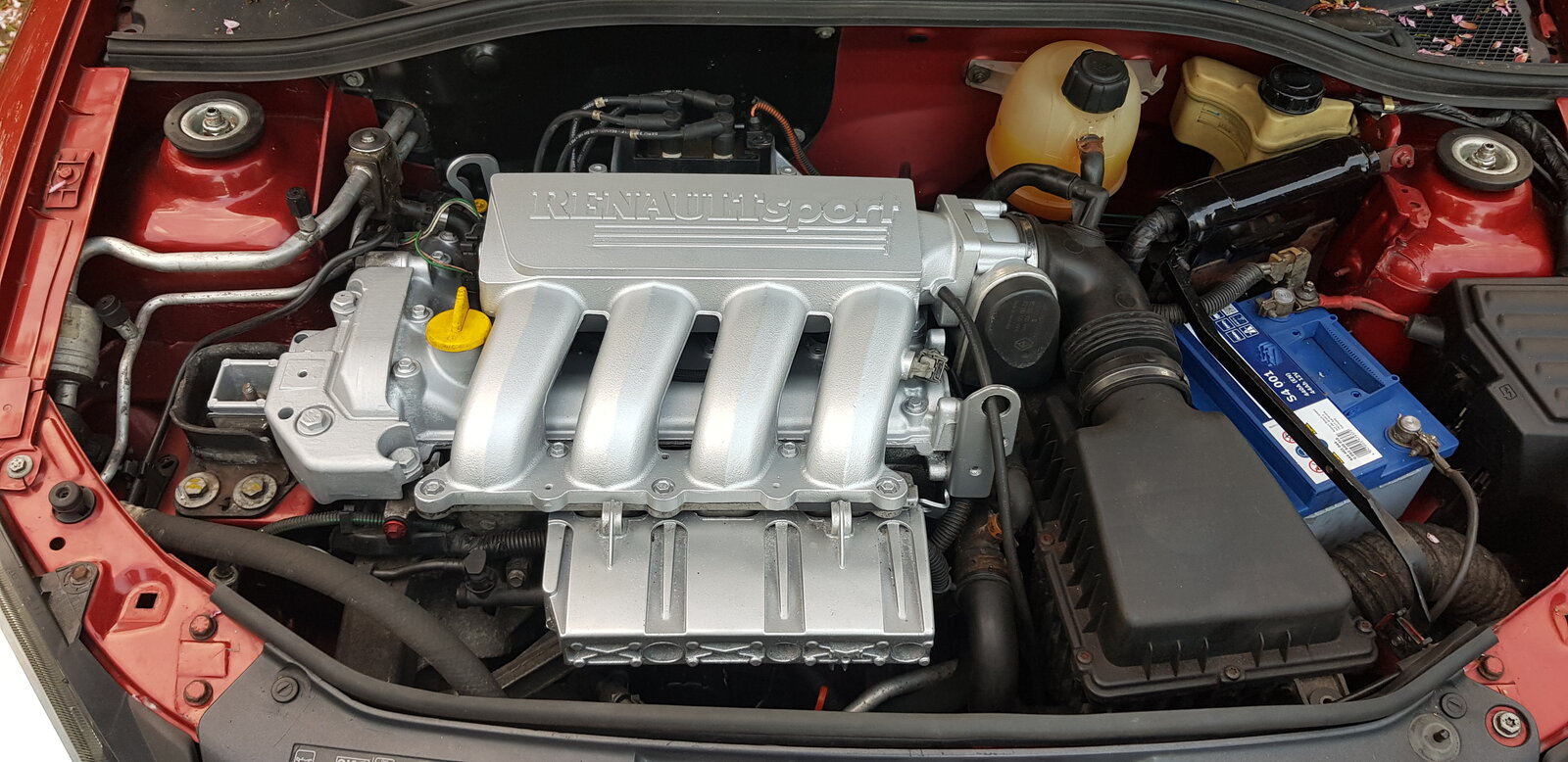

The ones on my trophy wern't too bad so i just cleaned them up and sprayed with alumablast which give a factory look.
