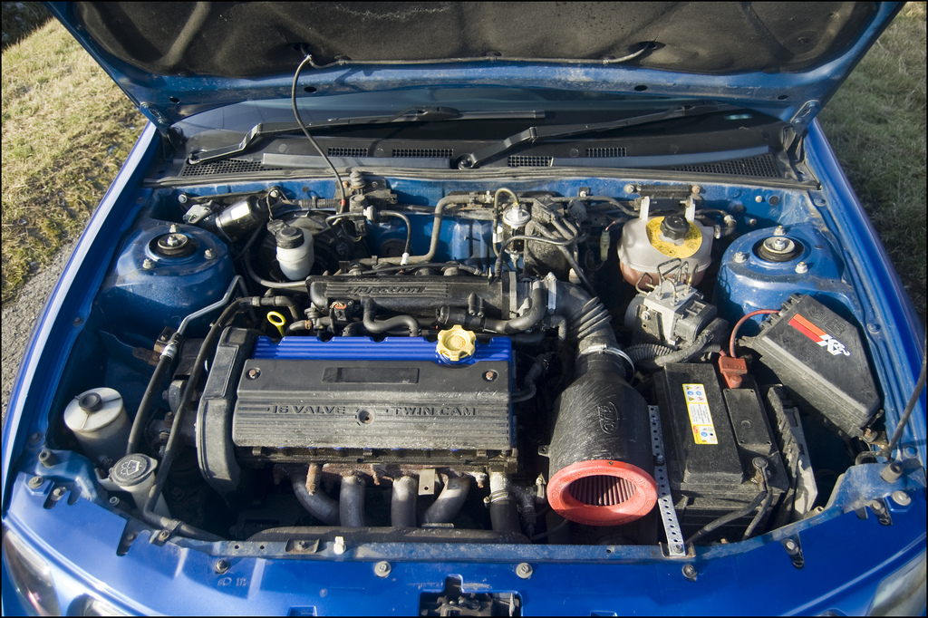

Mine's an absolute s**t tip...
Any recommended products/techniques. (I've seen that guide on polishedbliss)

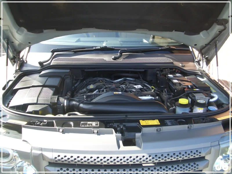

Megs APC sprayed on and agitated with a brush and microfibres is all you'll need, wipe off with a clean wet microfibre, then dressed with product of your choice.

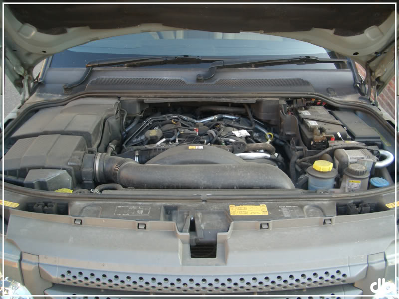

Here's the result from the above method:
From this:
To this:
