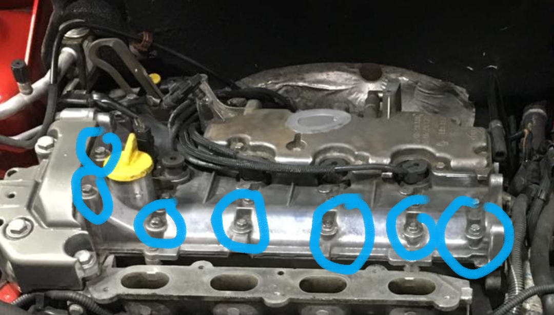

Does anyone know the exact bolt sizes for any of these that I have ringed :

I think the ones at the front might be M6 x 62 with the part number 77 00 106 428
and the left ones might be 77 00 106 429

  Mazda 2, Ph1 172
M6 x 30mm for the ones at the front.
The ones to the left by the oil filler cap i have no idea

Thank you guys. The part numbers @JamesBryan put up seem to be the right ones. I'm going to buy one of each to establish the pitch and then buy stainless equivalents .
