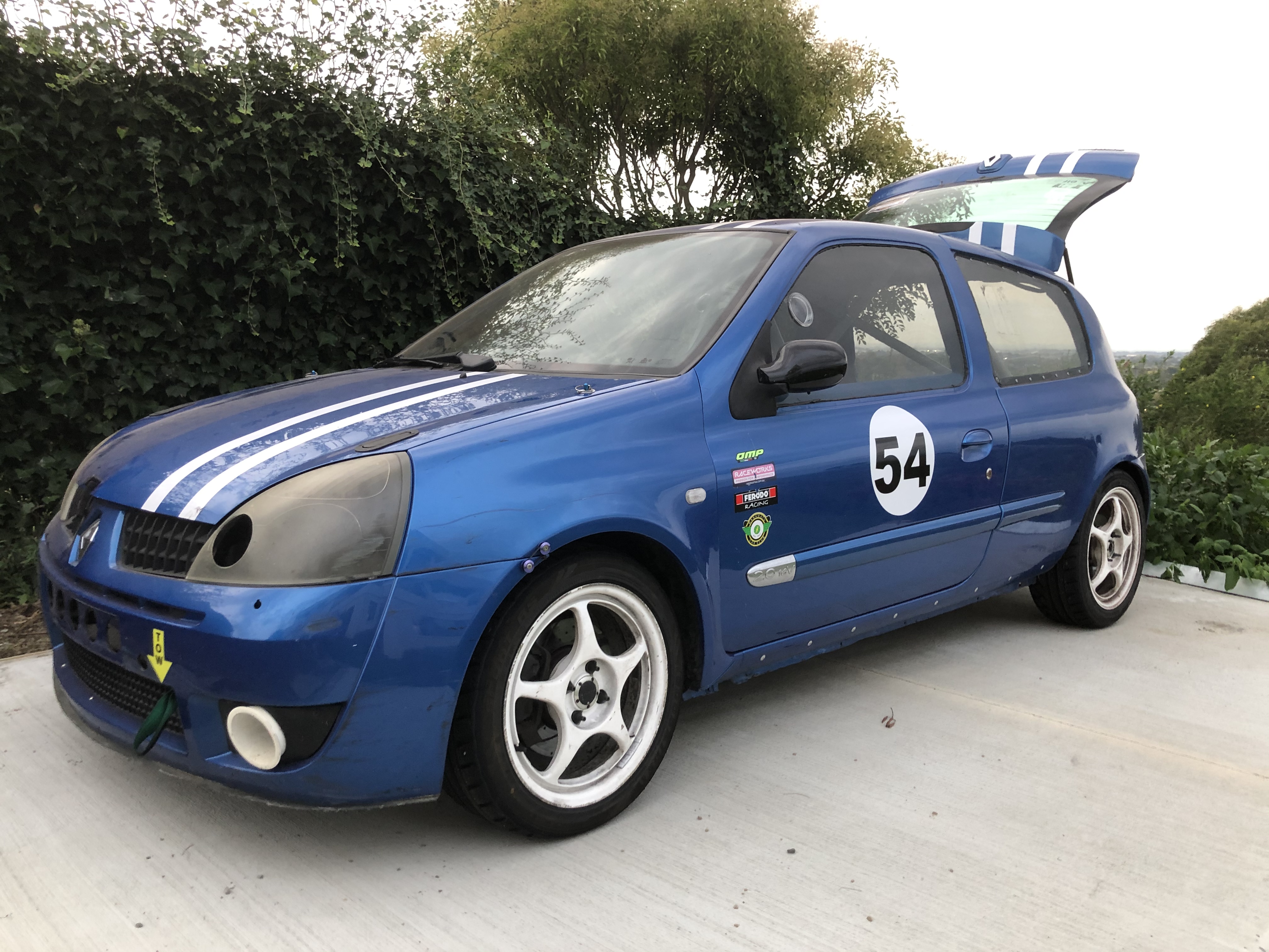

I have a fully stripped 182 track car. Last track day the car would go into a sort of limp mode after cornering exceptionally hard. I could coast, key off and crash start immediately tho.
Some sort of electrical sensor loose wiring??? Thoughts?? Aim to scan tool it soon.
pic for interest. NZ based. :)
