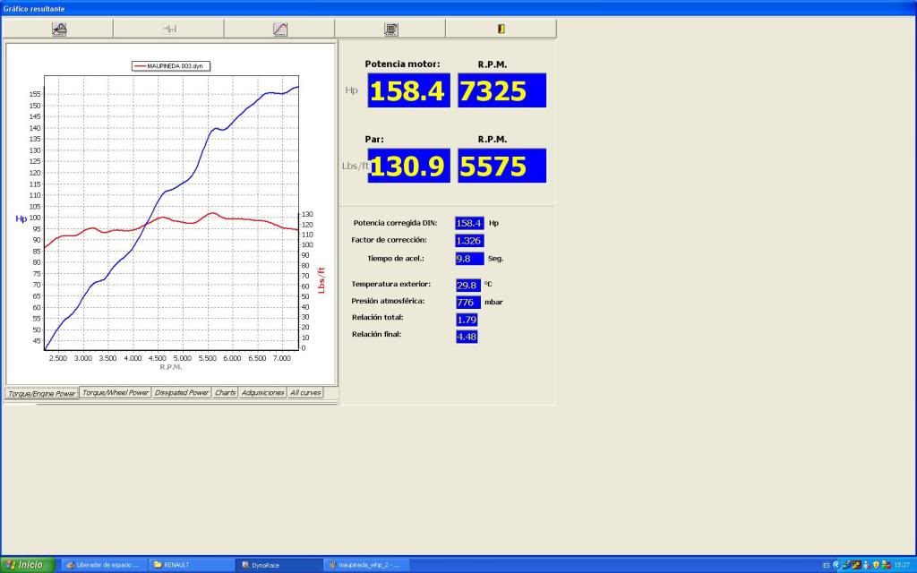

I gained about 12 bhp.
Bare in mind this measure is at 2400 meters above see level where cars lose around 22% of their power, plus the factors used for dyno correction are unknown, my car did more that all other clios, just one 182 that put 162 in the same roller and day, kind of a freak I guess.
One thing is for sure, my car is faster that any other 172 with known mass mods (remaps, exhausts, etc, etc, etc)
Look at the graph in the high end, power was still building up when the limiter kicked in and torque doesn't as much fall as with the stock's even after 7K, as said, once vvt engages at around 1800 it feels better than it ever did with stocks. Live mapping would be better, but there is no one I can trust this side of the antlantic. And it doesn't look too bad low down, does it?
Special thanks to Henk who mapped the car remotely and did quite a good job.

^^ your power seems allright, but your torque does'nt really add up to the equation . It's on the low side. Translating it to Newton meters it's 177 or so , but like you said the altitude and heat could be a prob.
My C&B cams have the same profile but it makes 200+NM torque and 174 hp at the wheels, mind you this was a couple of meters BELOW sealevel and mild temperature

It is torque that drops off with altitude, at just short of 1% per 100m
Also that power figure is engine power not wheel power but if you factor it for sealevel it equates to approx 203 hp at the fly so a very respectable effort
  172 Ph1, 1972 Mini 1
No its at the engine, if you look just beneath the graph theres tabs and the selected tab which is slightly raised above the rest is Torque / Engine Power. Torque / Wheel Power is the next tab and isnt raised.
Like i say adjusted for sealevel (1000mb pressure) its about 203hp so not that bad!
