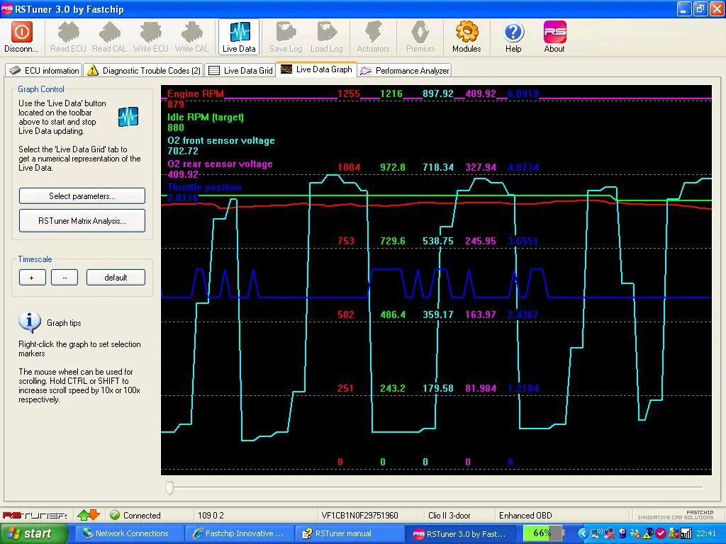

My front lambda does swing pretty well mind, so I'm not really too sure what to do. Might just bite the bullet and swap the lambda.
http://i3.photobucket.com/albums/y72/lagerlout1/untitled.jpg
