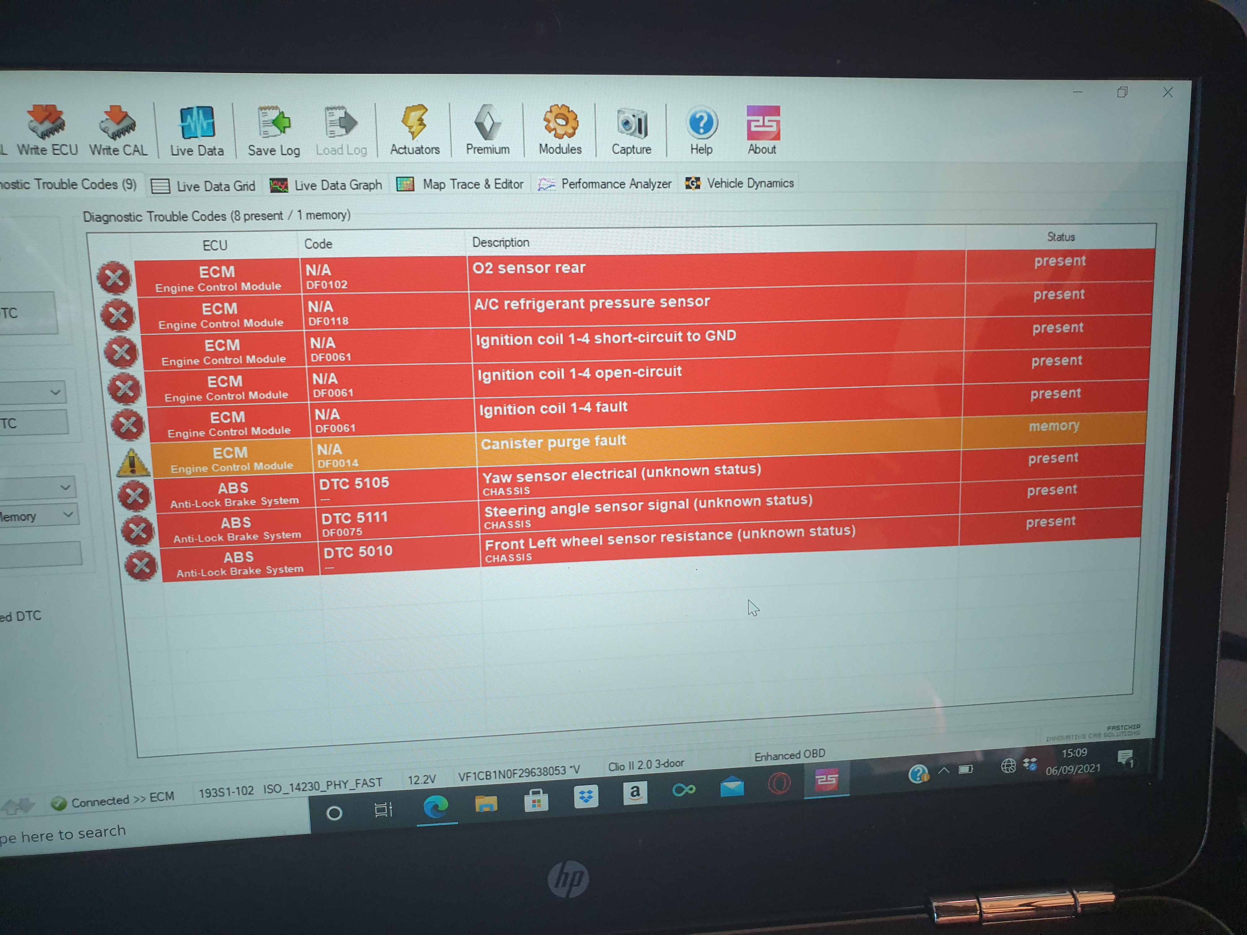

Dont appear to have any fault codes stored.

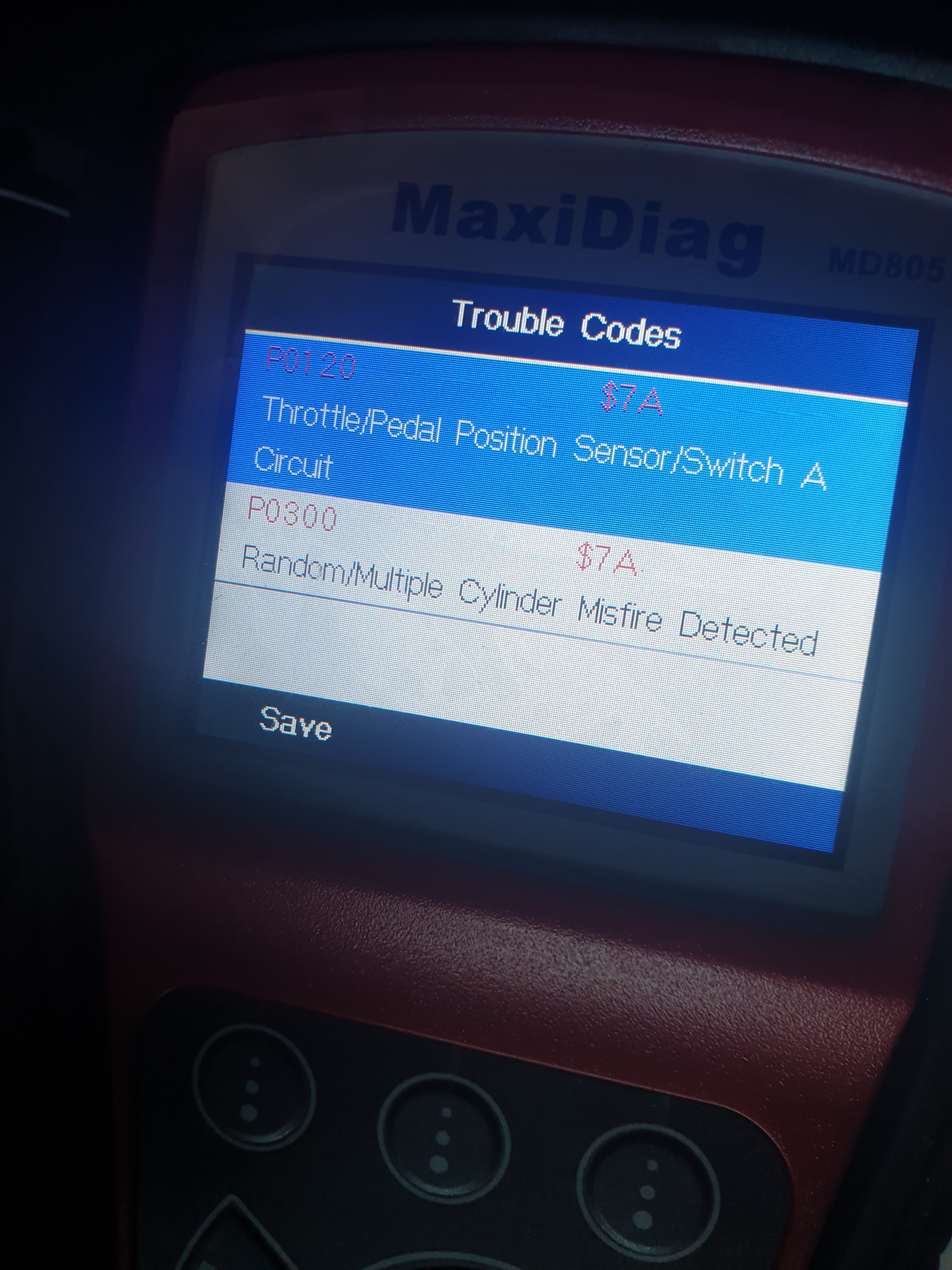

Swap inlet from my red clio , idle has dropped to just under 2000 rpm , got the dash light flashing in bottom right corner now and have 2 fault codes up ! Tried swapping over another pedal but still have same code coming up , will try swapping throttle body over.
  clio 172
Throttle sensor fault has gone with swapping pedal over.
Just nedd to figure the P0300 , swapped coil pack , will try spark plugs and leads
