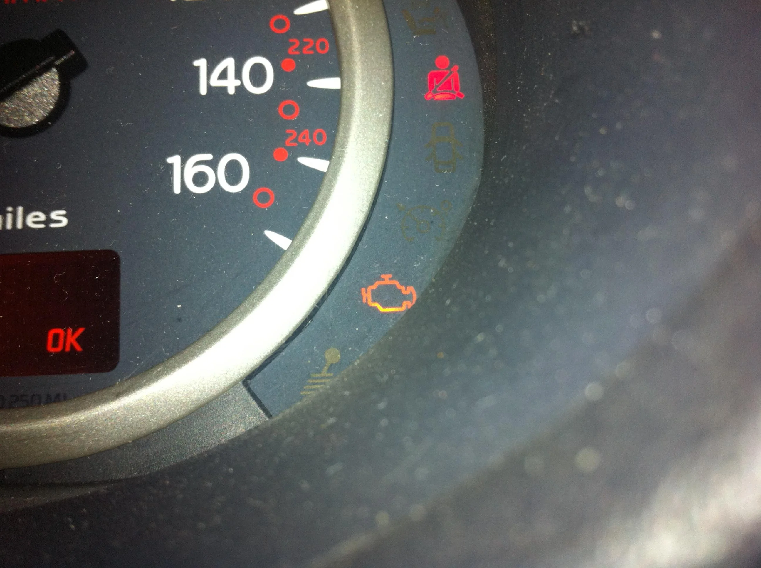

This warning light has just come on while I was going down the bypass.
I plugged my fault reader in and it said there was one fault but it just said N/A and didn't give the fault code.
Any ideas what it could be? The car was driving fine :S
Emissions light mate and yes your decat will have caused that. Some come on some don't.
Ah thanks. It did come on a few weeks ago but I cleared it and it was fine. For some reason I thought it was a different light :S
I'll clear it again :rasp:
Sorry to thread hijack but just wanted to check, my EM light has also come on but I'm running a cat with a standard exhaust, but it's very rusty and possibly blowing slightly. Would a blowing exhaust cause the EM light to come on? The car runs fine and starts 1st time everytime
@ Sam - This is the "MIL" or "Malfunction Indicator Light"... it can come on for a number of reasons including Post-CAT H02 sensor when people de-CAT but it can also come on for many different reasons. Yes, a blowing exhaust could trigger the MIL depending on the size and position of the leak as it will richen up the AFR which the Post-CAT H02 interpruts as a management/fuelling fault.
Your case will proberbly turn out to be something simple to fix but it really needs diagnostics to avoid wasting money on a new exhaust section or H02 sensor.
