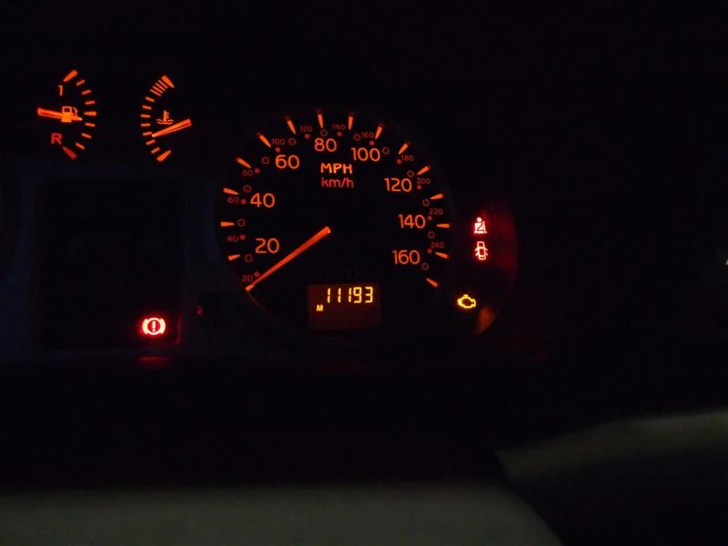

not used my car for the past few days...Just started her up in the garage and revved the engine after the car had been running for a few mins and now the engine managment lights come on.....on its own :mad:
Never had any problem before and just seems strange how its come on on its own from just revving the car?
Any ideas what this could be?
Thanks
J273
  RB 182
this is the light ...bottom right

Its the exhaust gas warning light will be the cat having a funny because its been stood for a bit. It might go off on it own but otherwise it'll need the fault codes reset to take it off, give me a shout if you want it doing i've got the diagnostic tackle to do it and i'm not far away.

Id ignore people who say its nothing to worry about, cars underfuelling or overfuelling can lead to a whole host of problems so its best not to just ignore it. Its not an immediate problem is probably the best description. The warning light as pointed out is an exhaust gas emmision warning light. Most likely it is a lambda sensor, which one (they have 2) is something only a diagnostic can tell you. My advice (and im currently doing this to mine) is to get the fault code and find which lamda, get the fault cleared. If it comes back on again, get a new Lamda, if not it then it should be ok.
