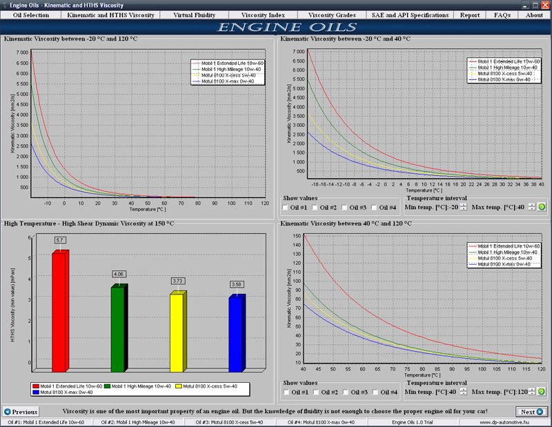

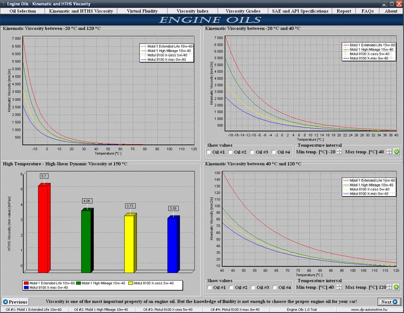

Engine Oils software can calculate the oil's viscosity at all temperature. Why is this so important? Because only the high temperature viscosity is defined clearly (SAE-20, -30, -40, SAE-50, -60 grades), the low temperature viscosity (which is marked "W" ) does not inform you punctually how the oil performs in cold. The winter grade defines only a maximum dynamic viscosity at given temperatures, therefore there may be significant viscosity differences between 2 identical winter grade oils. For example, here is a direct comparison of 4 different viscosity grade lubricants: 10w-60 (red), 10w-40 (green), 5w-40 (yellow), 0w-40 (blue):
An average car owner may think that 10w-60 (red) and 10w-40 (green) oils have similar viscosity properties in cold. But it's not true! Check the figure! Although 10w-60 lubricant meets the SAE 10w grade (the properties of the SAE 10w grade is defined by the SAE J300, this standard describes the characteristics of each viscosity grades), but it's significantly "thicker" in cold than the 10w-40, not only at high temperatures! This may cause higher engine wear during the 'oil starvation' period of the cold start.

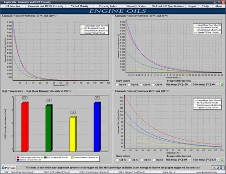

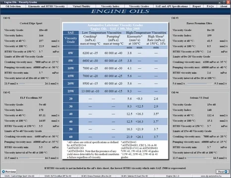

10w-40, 5w-40, 0w-40 grade oils have similar viscosity at high temperatures, they have the same SAE high temp grade (SAE 40). In other words they kinematic viscosity must be between 12.5-16.3 mm2/s at 100 C deg. But this means only that they flow similar at 100 C deg. There is an another type of viscosity which is not as widely known as the kinematic viscosity. It's the HTHS viscosity. High-temperature high-shear-rate (HTHS) viscosity is an indicator of a motor oil's resistance to flow in the narrow spaces between rapidly moving and highly stressed parts in fully warmed up engines. ASTM D 4683 is a standard method for measuring HTHS viscosity, this test simulates the conditions found in an engine's crankshaft and connecting rod bearings, as well as other narrow regions. This measurement has important implications for such factors as engine fuel economy, valvetrain wear and bearing protection. Higher HTHS value means better bearing, valvetrain protection against wear but indicates higher fuel consumption and vica versa. Each SAE multi-viscosity grade has a specific lower limit for the HTHS mPas value. If a multi-viscosity oil cannot achieve a mPas value above that limit, it cannot be classified under that viscosity grade. For instance, according to the SAE J300 specifications, an oil must achieve an HTHS mPas value of 2.9 or higher in order to be classified at the 5w-30 viscosity grade. Engine Oils 1.0 can directly compare the oils' HTHS viscosity (if it's included in the oil's technical data sheet, if it's not, the software uses the lowest HTHS viscosity which defined for the current grade in the SAE J300).

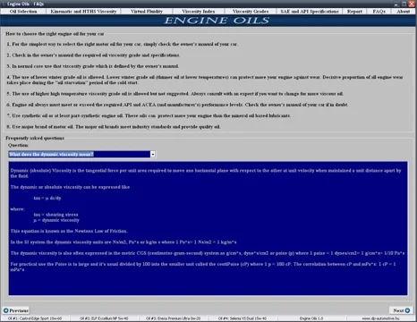

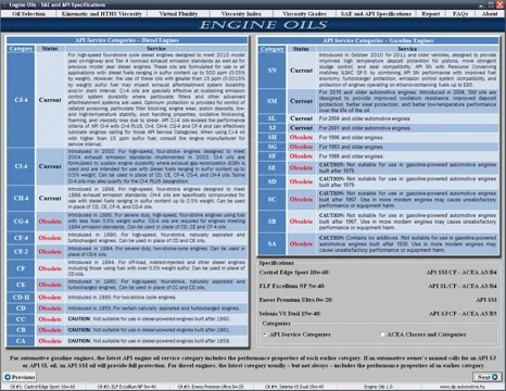

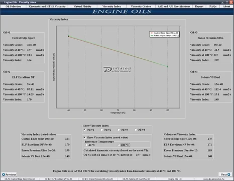

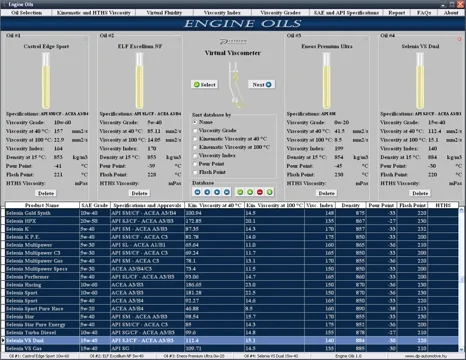

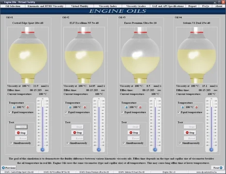

Besides these options, Engine Oils can recalculate and visualise the examined oils' viscosity index, analyse the oils by SAE J300 standard. Latest API and ACEA specifications are included in the software and a virtual fluidity test may be applied on the selected oils. In short: the software helps to choose the proper engine oil for your car.

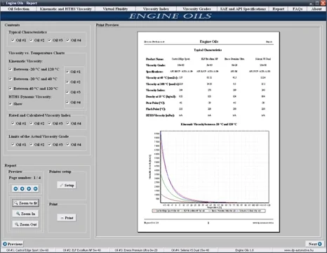

The following pics are taken from the full version:
