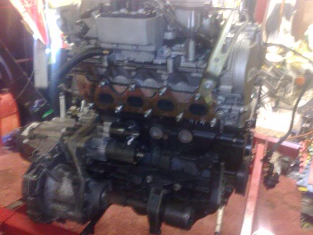

Some 172s and most 182s have it...
The driveshaft is two piece....comes off the box to this bearing in a straight line, then off to the hub. Bolts onto the 3 holes on the back of the block, not got a pic to hand unfortunately!
hmmm, equal length shafts? The normal shafts are almost this setup anyway, the part that sits on the sun wheel is a cup that the shaft spider bearing sits in, it's not bolted to the block but sounds like it does the same job
Crap pic but you can see the bracket/bearing and one part of the two piece shaft there, thats from a 182
