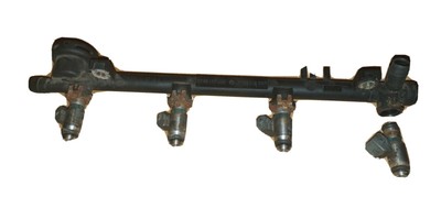

Ph1 uses a fuel return system and has a fuel pressure regulator on the fuel rail. Ph2 is a returnless system. Granted they do look the same.
Any way to tell the difference from the pic?
Just run the part number on the rail, and its coming up as a laguna II 2003 fuel rail....are the rails interchangeable?
