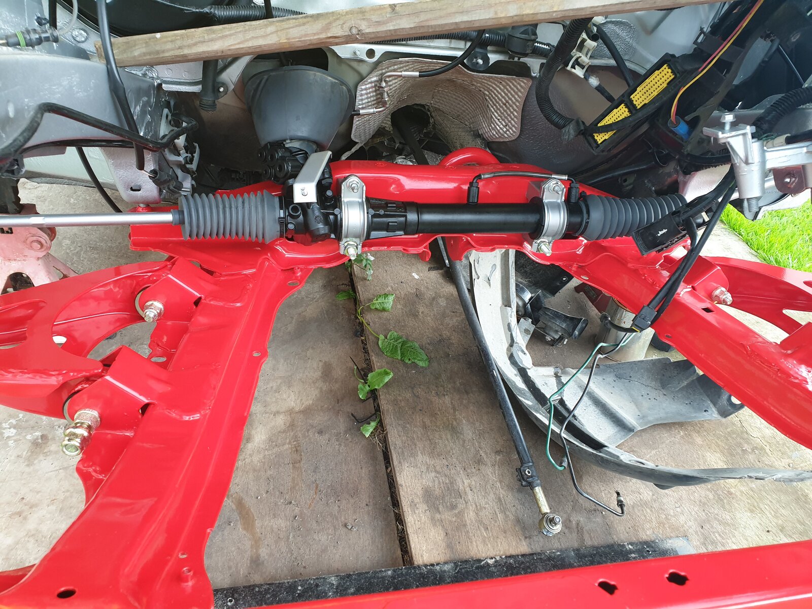

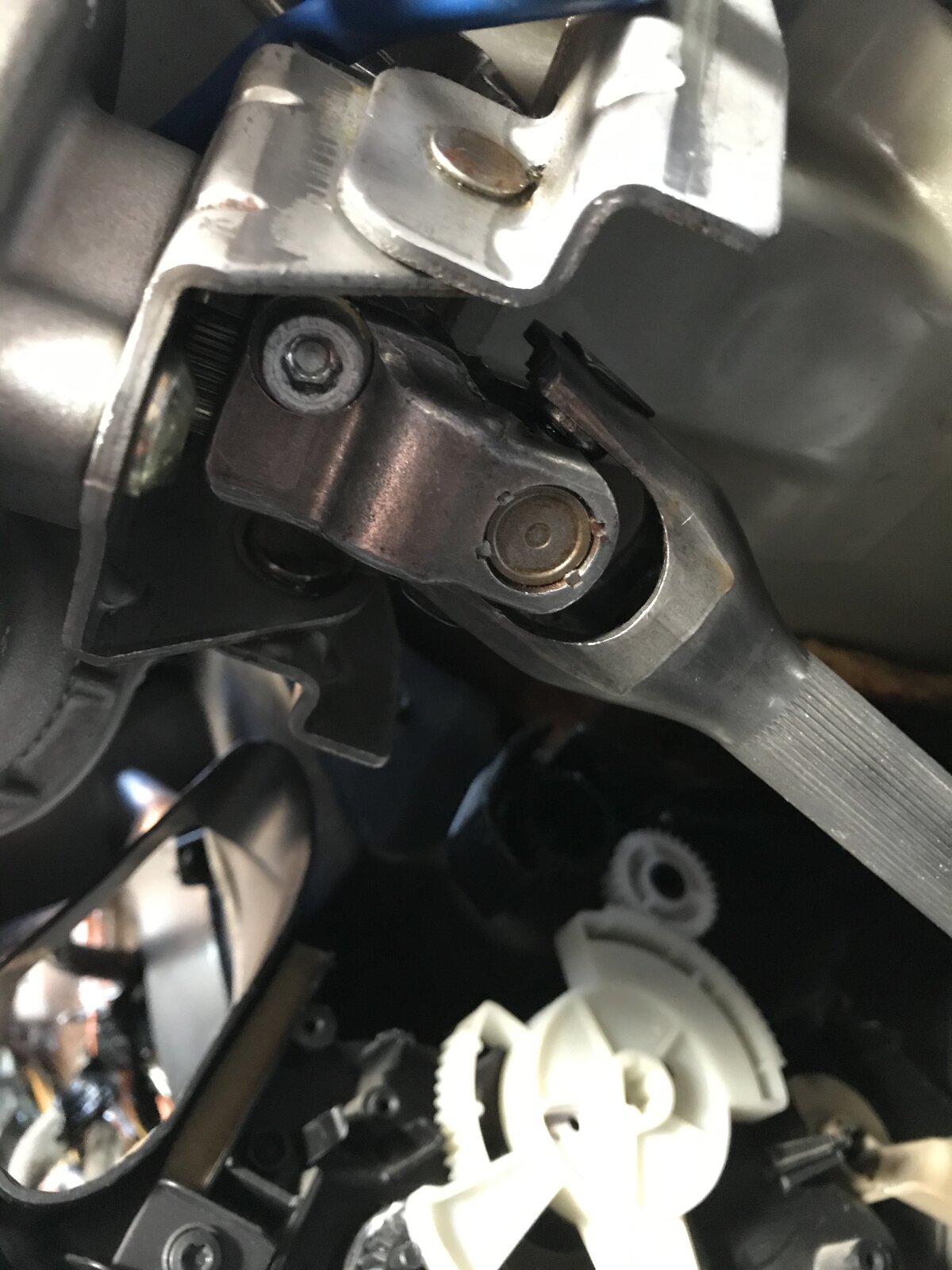

Hi guys, I am in the middle of the EPAS conversion and I have fitted the column but when I come to the rack it is mounted different. Can you advise please ?
1985michael182
The rack and the column will only mate one way as there is a notch for the bolt to pass through. Make sure your rack is centred so not steering left or right.
  Clio 182
If you've got a dCi rack then they bolt up differently
They dont have bushes and bolt directly to the subframe
Yes thats what I was struggling with, just found a picture that shows the mounts for the hydraulic rack removed and the DCI rack bolted onto the subframe. Do I have to swap over the Tie Rods to get the length ?

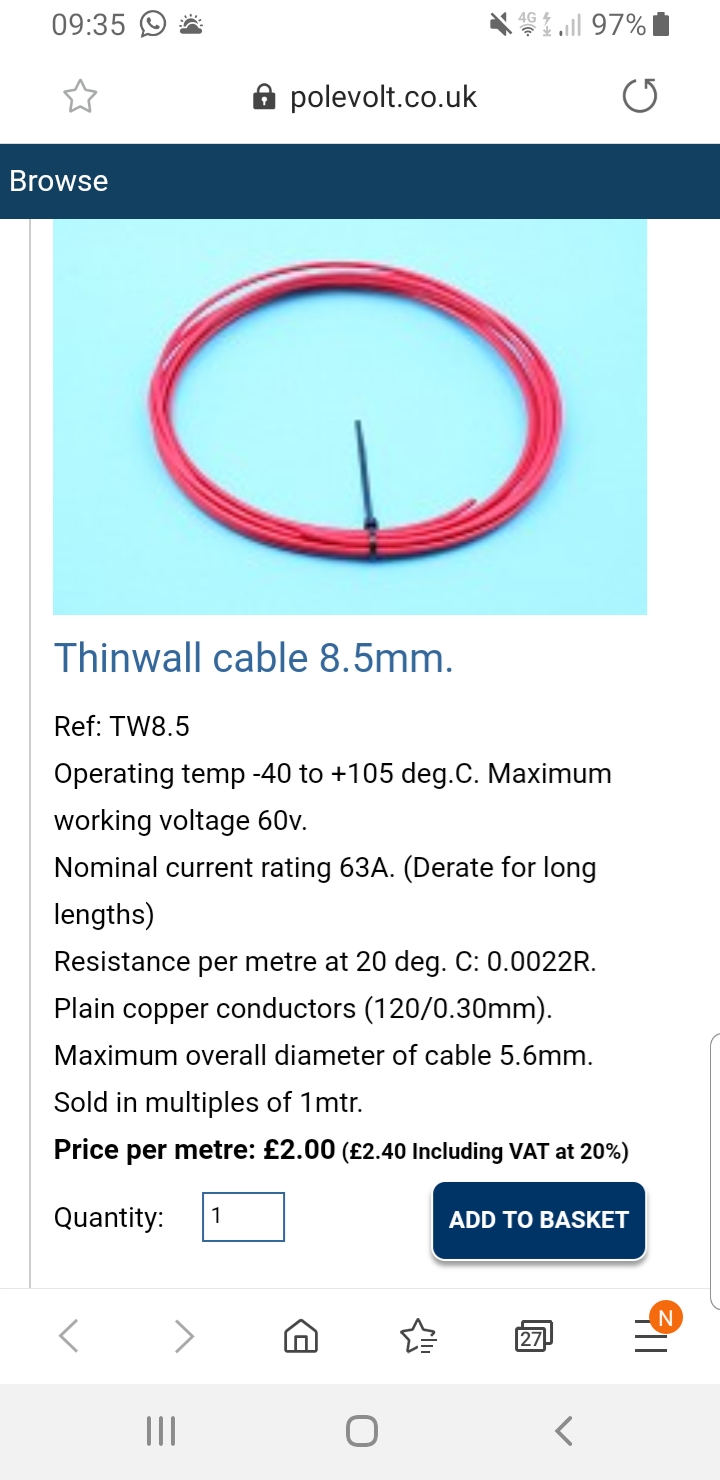

It's usually like a 50/60amp fuse. You want your cable to be higher rated for ampage than your fuse.
So for example 8.5 mm cable is rated for 63amps with your weak point being your fuse at 60amps

so left the DCI rack in place, its not been removed. Fitted brand new genuine Renault inner track rods and rod ends both from a 182.
if I centre the rack, the steering wheel is way out from centred, if I centre it either clockwise or anti clockwise then the rack isn't centred and I get more lock one way than the other.
what am I missing? has the car possibly had a new rack at some point and someone has fitted the pinch bolt 180 degree out!? if that's even possible.
I've been lying under it as I cant get access to a ramp for it currently so I'm pulling my hair out!
its got a genuine Renault SMI rack and im getting 2.75 turns lock to lock
