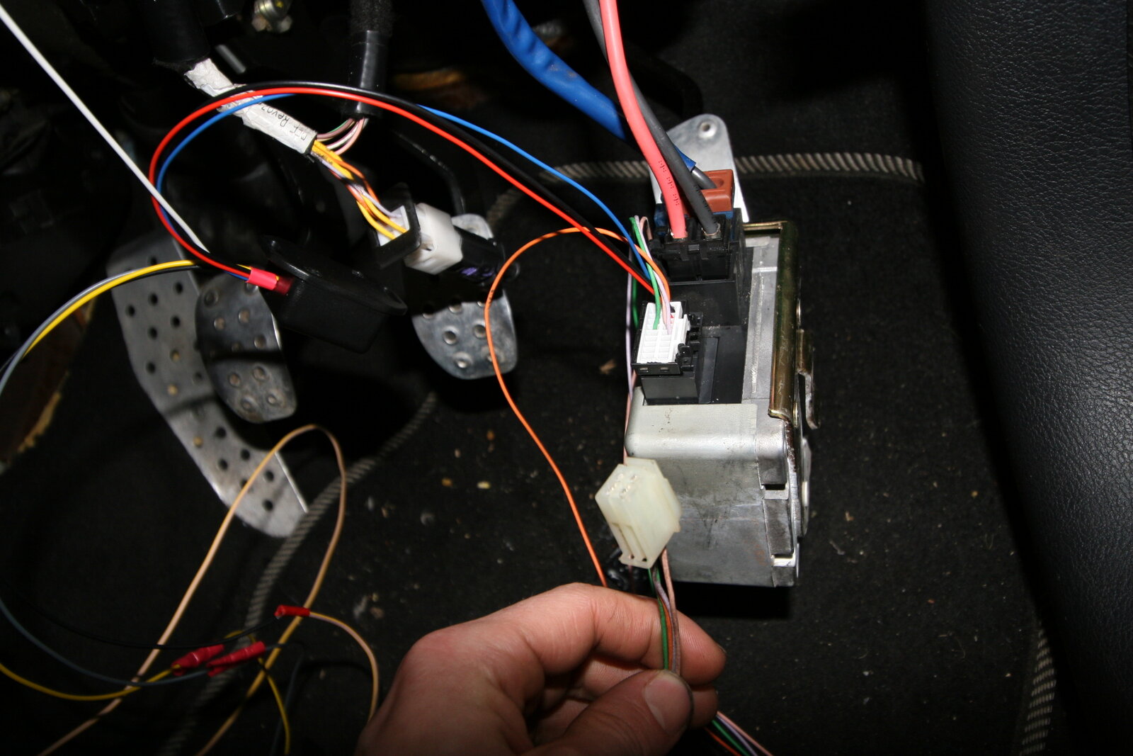

Wheels on the ground, 12v wired up to a different thicker wire (cig lighter wire) And nothing. Ive checked the power going to the epas ecu and I think its fine, I put the prongs in and out and it shoots up to 12v ish then back down. The epas ecu doesnt make any noise when you turn the ignition on though should it?
Im not sure what to check? The fuse isnt blown, the earth is built into the loom and bolted down. The multimeter picks up that theres power at the plug. White wire is earthed, black wire powered from cig lighter, other 4 wires are in and plugged into the column. Ill double check but dont know how I messed something up. o_O o_O
Im not sure if these are (bad) results Im looking for?

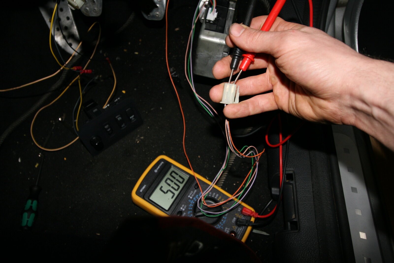

Just turned the ignition on and the ecu does infact make a big clunk. These are the wires that are having problem, 2 okay the other 2 (orange and green) nothing

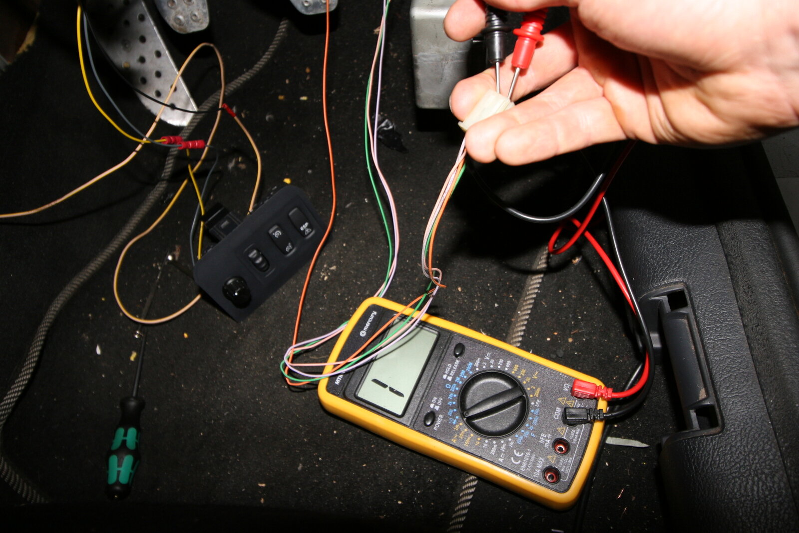

So pull the plug from the ECU with the four colour wires and check the continuity of each wire. Like in that video, if it beeps or says OL (open circuit) then theres a problem down the line. They are only tiny wires so it wont read much but it should read something!

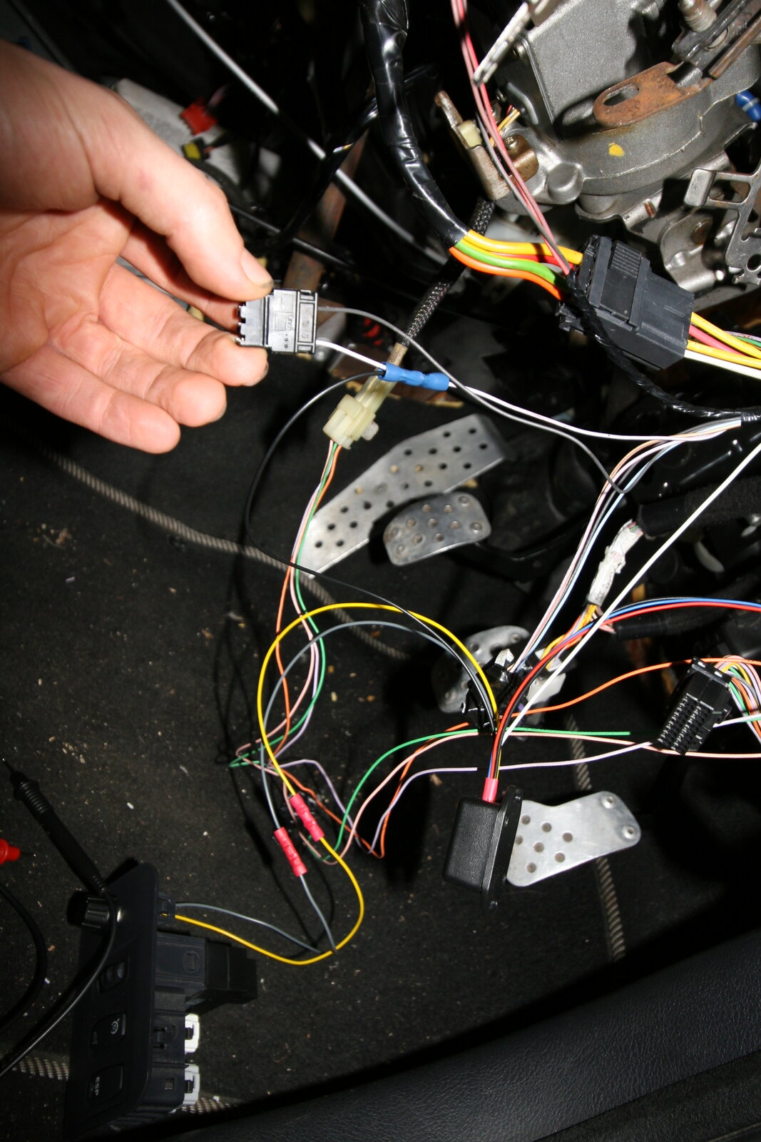

Although we did fix it temporarlily o_O I started it up and it worked, shut down and started back again and the ecu cut off and the steering wheel light on the dash came on and went out. Broke again, I checked the power cable fuse thats okay and the small 15amp fuse in the fusebox and both fine. Something relay uch Ive read before??
It works now pal. What I did was put the oem connector in the ecu with the neccessary wire swapped out for the black box, so the steering wheel light came on the dash, but it didnt like it and shut off so I removed them all to not confuse the system and it sorted it.
And thanks I just realised it comes on without needing engine on. The adjuster seems kinda slow to change but it seems to work.

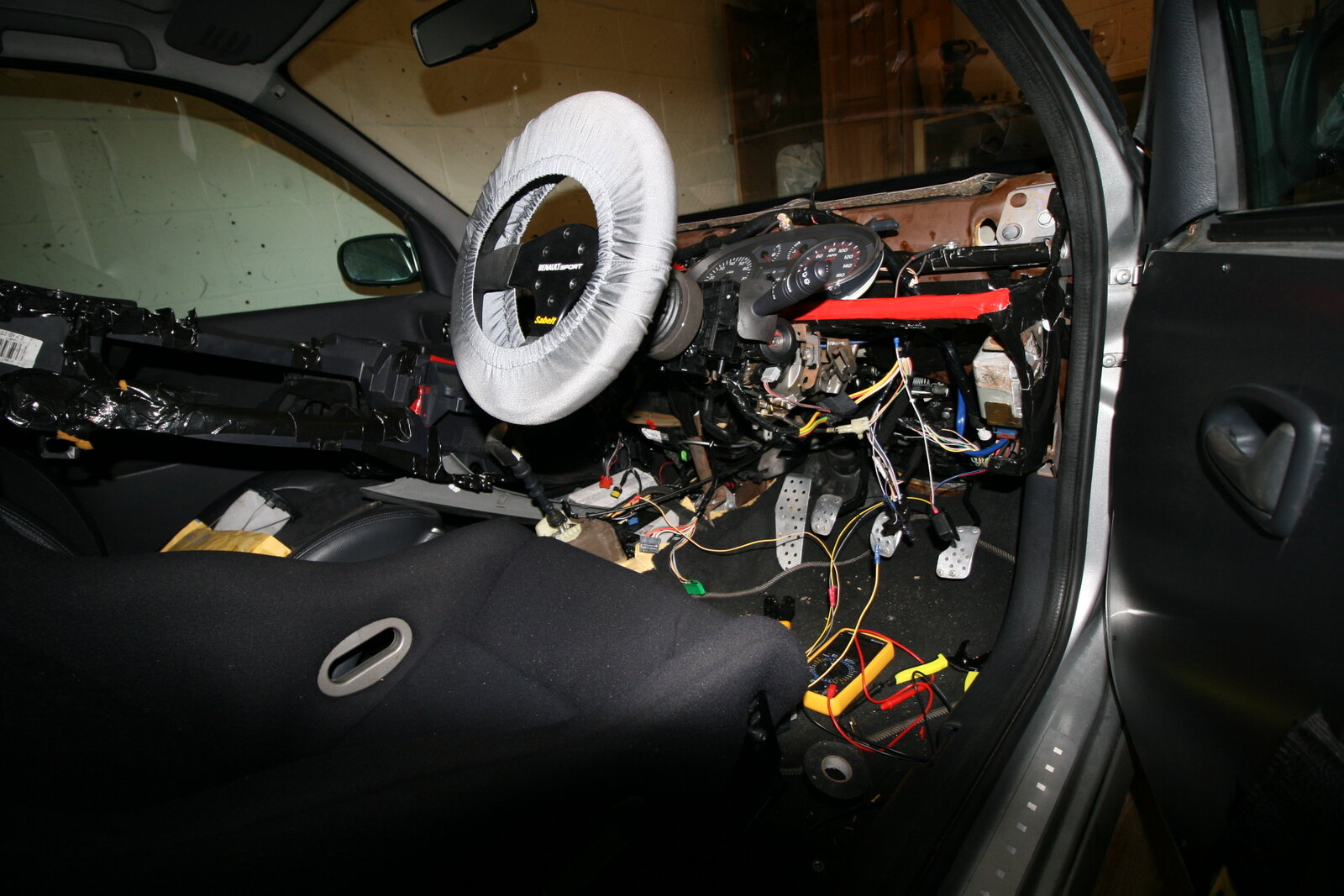

Its too late now to go out for a test as getting in/out the garage is a skits mission so will drive out tomorrow. Will now clean up the wiring and tuck it back.
@1985michael182 Went on its first test today, was rush hour, dark and raining so the best time to do it. All went well though, it steers smooth and drives straight which is the most important thing. I played around with the adjuster but Ive set it too max assistance for all speeds as theres this firmnmess in the first 20 deg of turning the wheel then it lightens up the more you turn, I can see why people complained about the self centering but for me its only the first part of turning and not while in a more sharper turn. Is it like this for you? Its not too bad and I have an aggresive alignment up front so will dial back the toe out a bit, Ive wanted to do this anyway..
