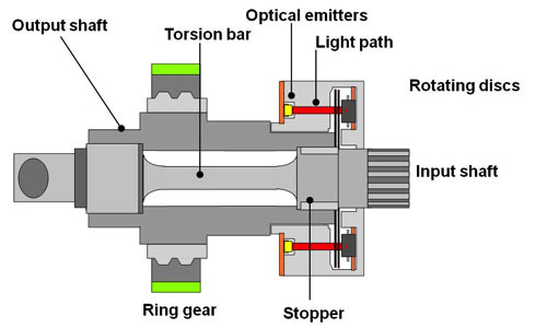

Where is this torsion bar?
Primary function of a column is to transmit torque from hand wheel to pinion. Makes sense & is common to have damping (typically with a rubber isolator) but makes no sense to nerf stiffness (which is what a torsion bar would do).

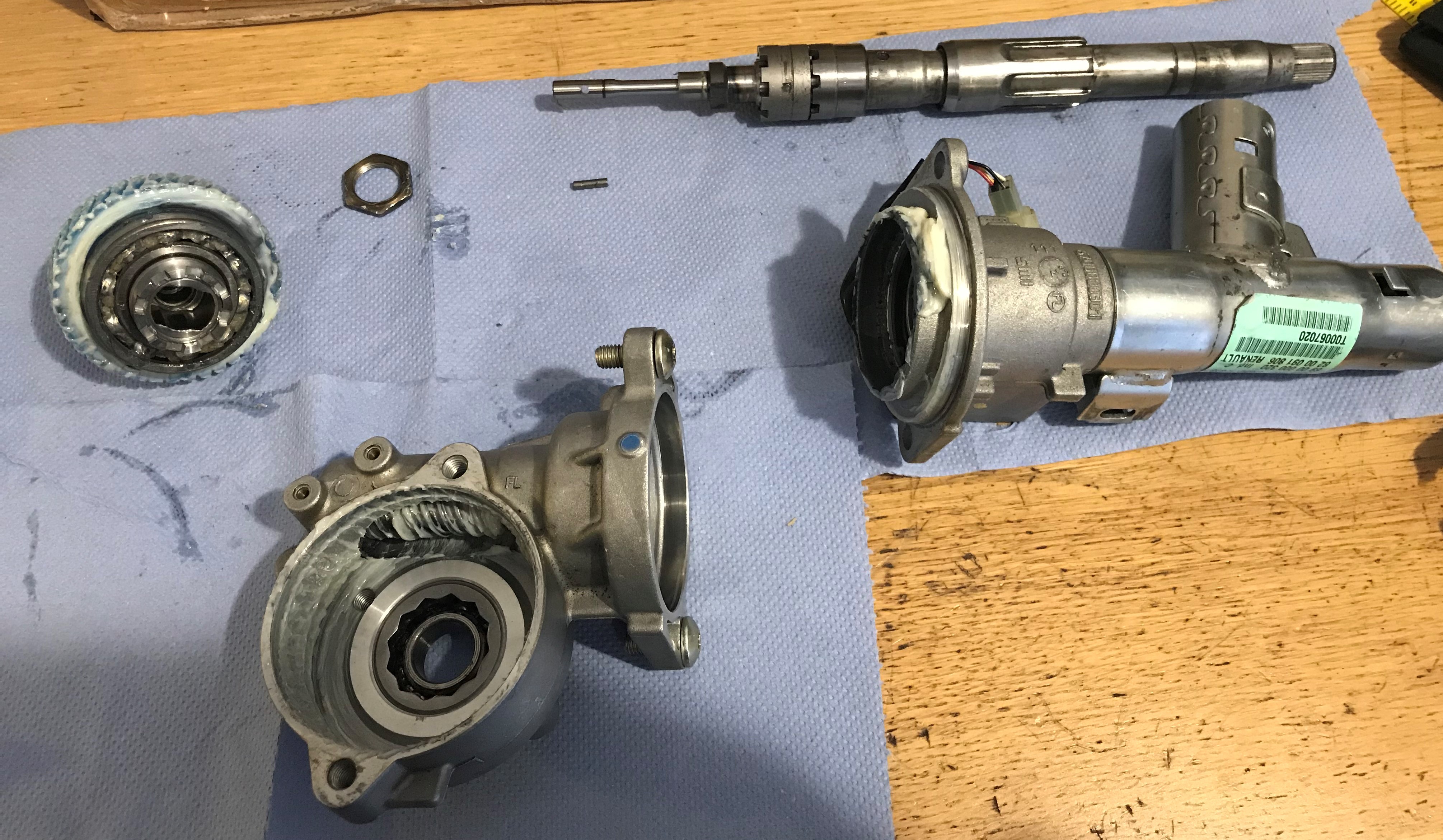

Internals of a electric steering rack

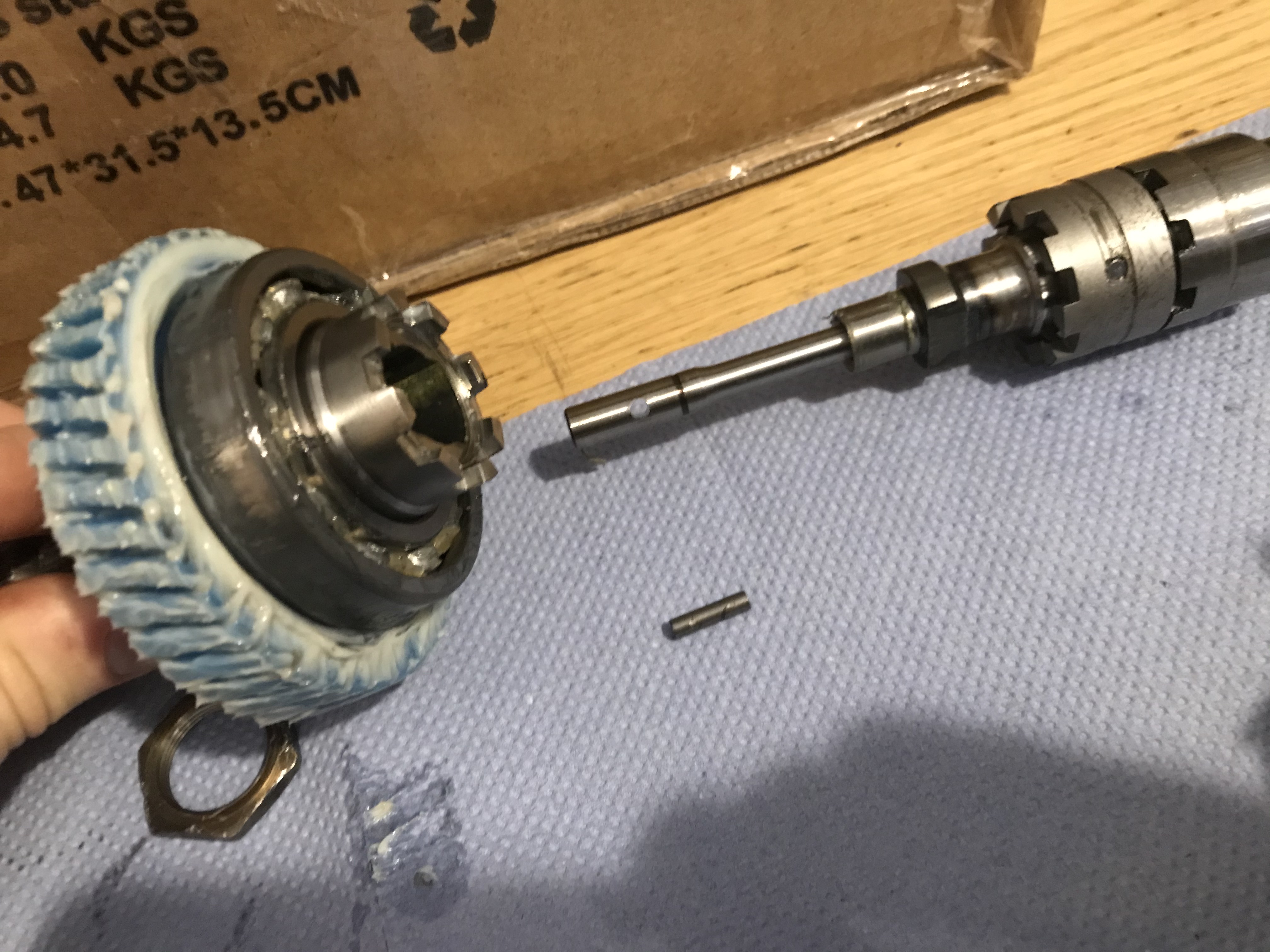

Anyone done surgery to it? Taken the torsion bar out and beefed it up?
I run a correction kit on mine, sticky tyres etc.. also a looped standard 182 rack.. feels pretty good, but can feel a sort of disconnected feeling if I’m throwing it hard into turns… it’s not that bad but different to the HPAS.

Ah I see, so you need to measure some displacement with a known torsional stiffness to calculate torque applied…
So if you beef up the torsion bar without changing the sensor then the torque sensor will under read and presumably give less assistance. Which presumably you can counter by winding the assistance back up.
Presumably more modern EPAS systems have a different sensor type, or just a more precise sensor that can detect small displacements and therefore work with a stiffer torsion bar.

This is the mk2 column.

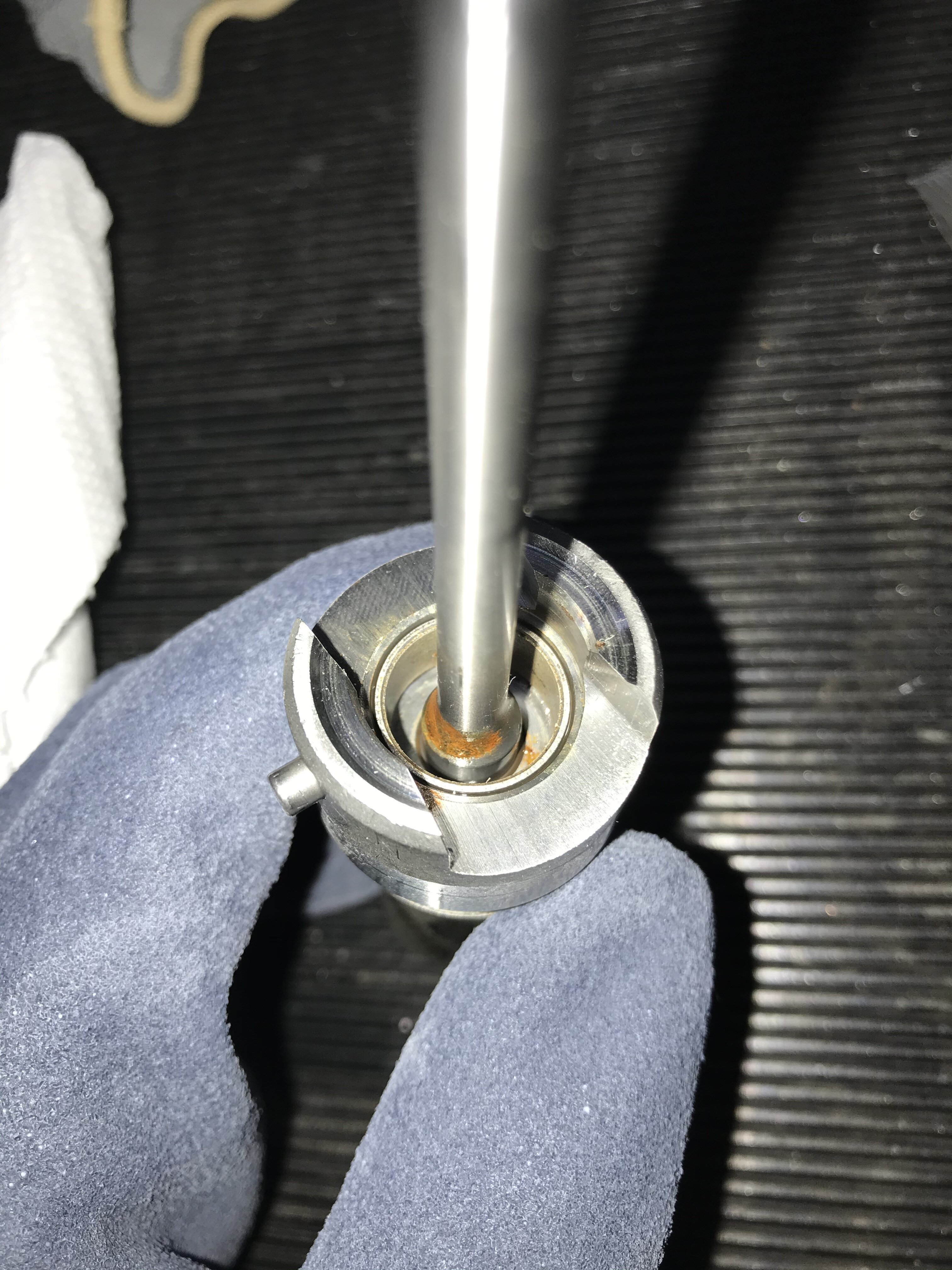

This is the hpas from the 182
This is the total amount that can be twisted, although they are disconnected and would obviously take a lot more force to twist. Under parking situations and heavy load it can twist that much.
