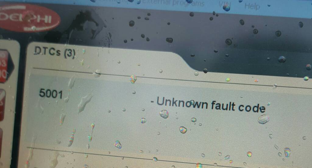

Hi.
@bashracing the legend he is put my car on the diagnostic machine and came up with this following issue.
Having some real problems finding out what this code means but it's the only one in the ABS side so the lights have to be to do with this.
Code is 5001 and attached is image showing why.
Any other codes were sorted so don't worry on those.
Cheers!
Sent from my SM-G928F using Tapatalk
To anyone interested, clip is saying that the fault is front right hand abs sensor. One is in the post so, should hopefully be it.
To anyone whoever finds this thread, I just stuck a new abs sensor on (30 quid from eBay) and it's fixed it. Happy days.
