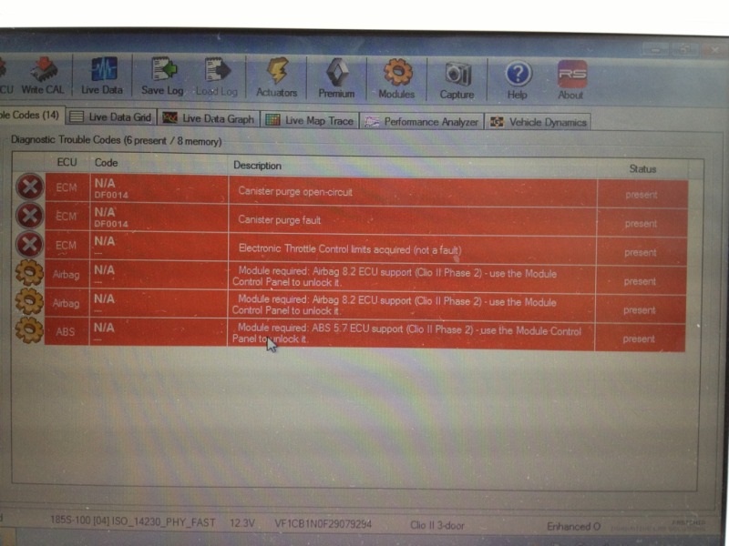

Ok so this problem is still persisting, got my self an RS Tuner so thought i'd make the most of the fault code reader this is what it has brought up as 'Present'
So it doesn't really help!? lol any idea's?
