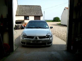

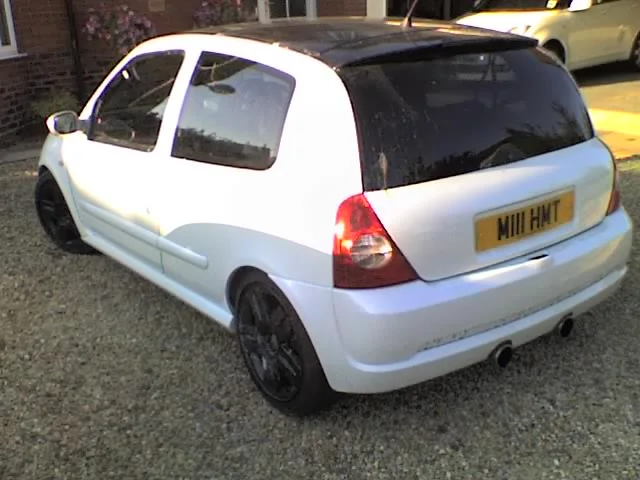

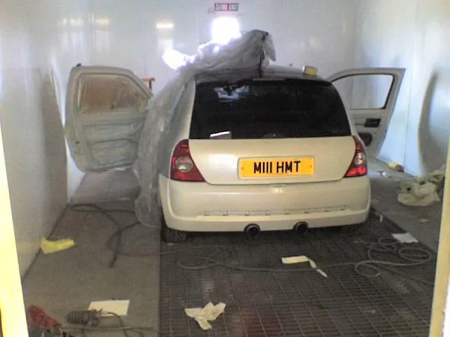

Oh and the pics dont do the colour any justice!!!! Respraying both sides this weekend, leaving just the bumper and bonnet and engine bay to do :)

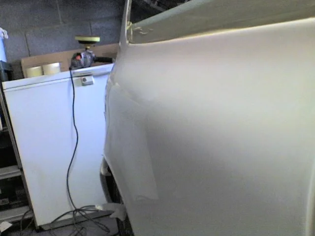

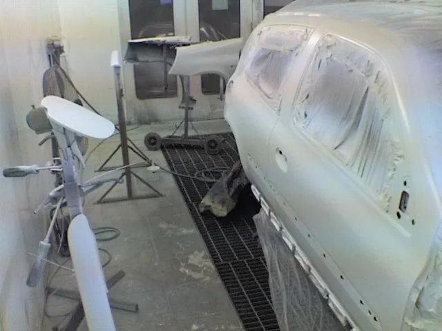

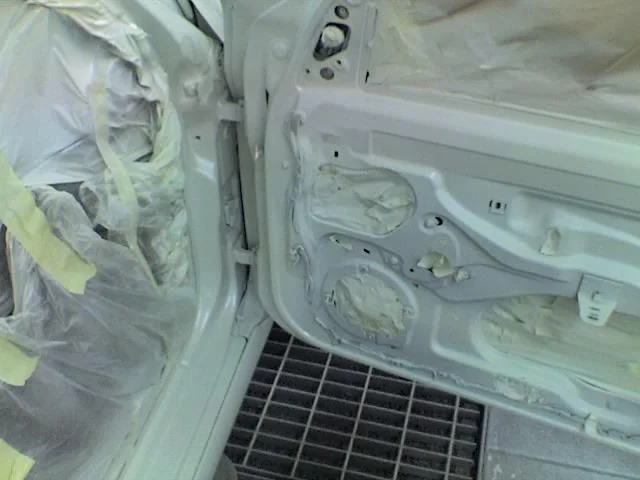

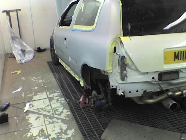

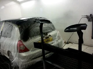

got the passenger side all masked up just need to take the drivers side wing of, bit of prepping and masking tmro morning then paint it :) hopefully il be uploading pics this time tmro of a mercedes white clio :p

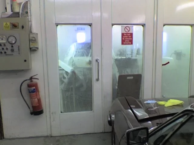

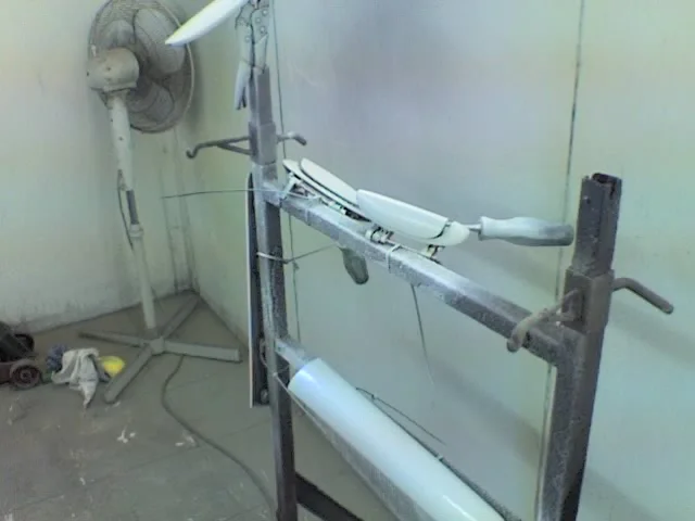

is this a 172 with 182 zorst rep, or a replica in general? Looks like a nice job. You've obviously got some fancy spray kit. Booth looks bang tidy :approve:

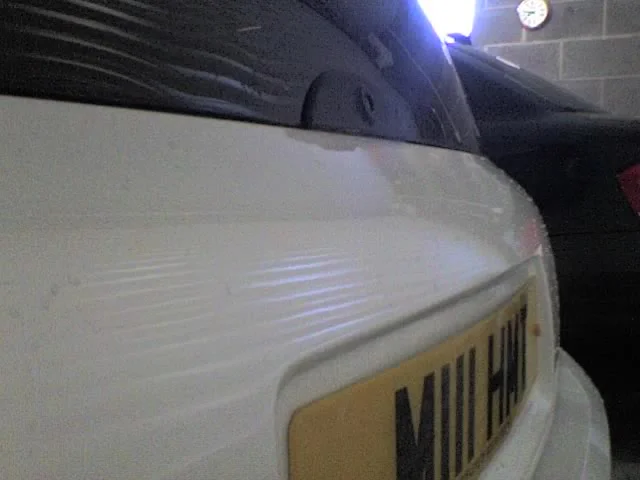

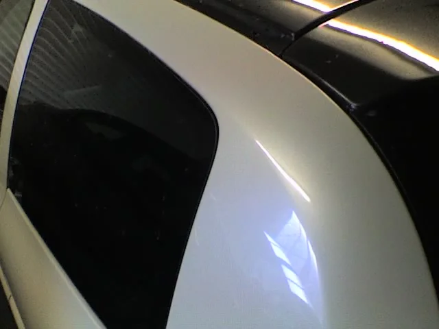

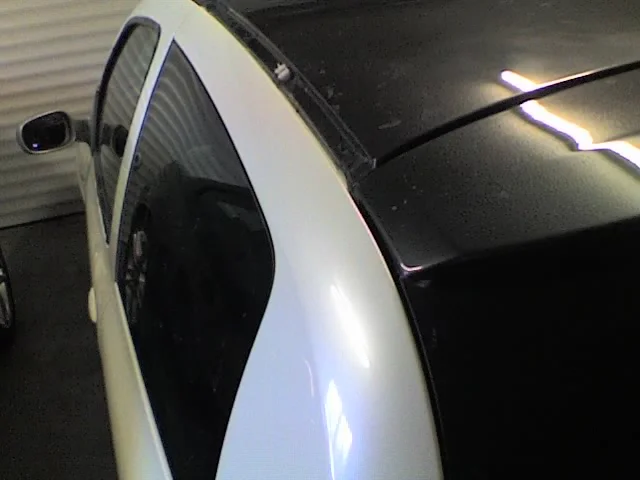

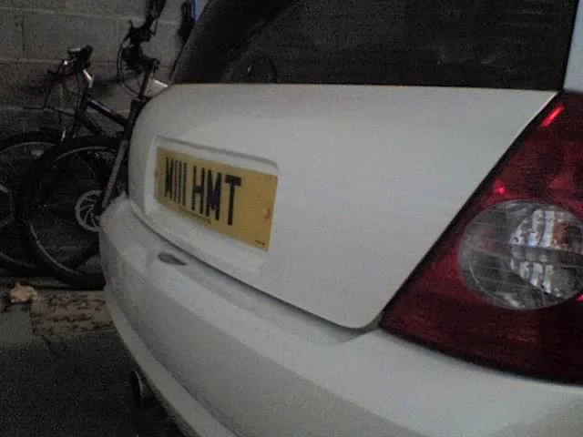

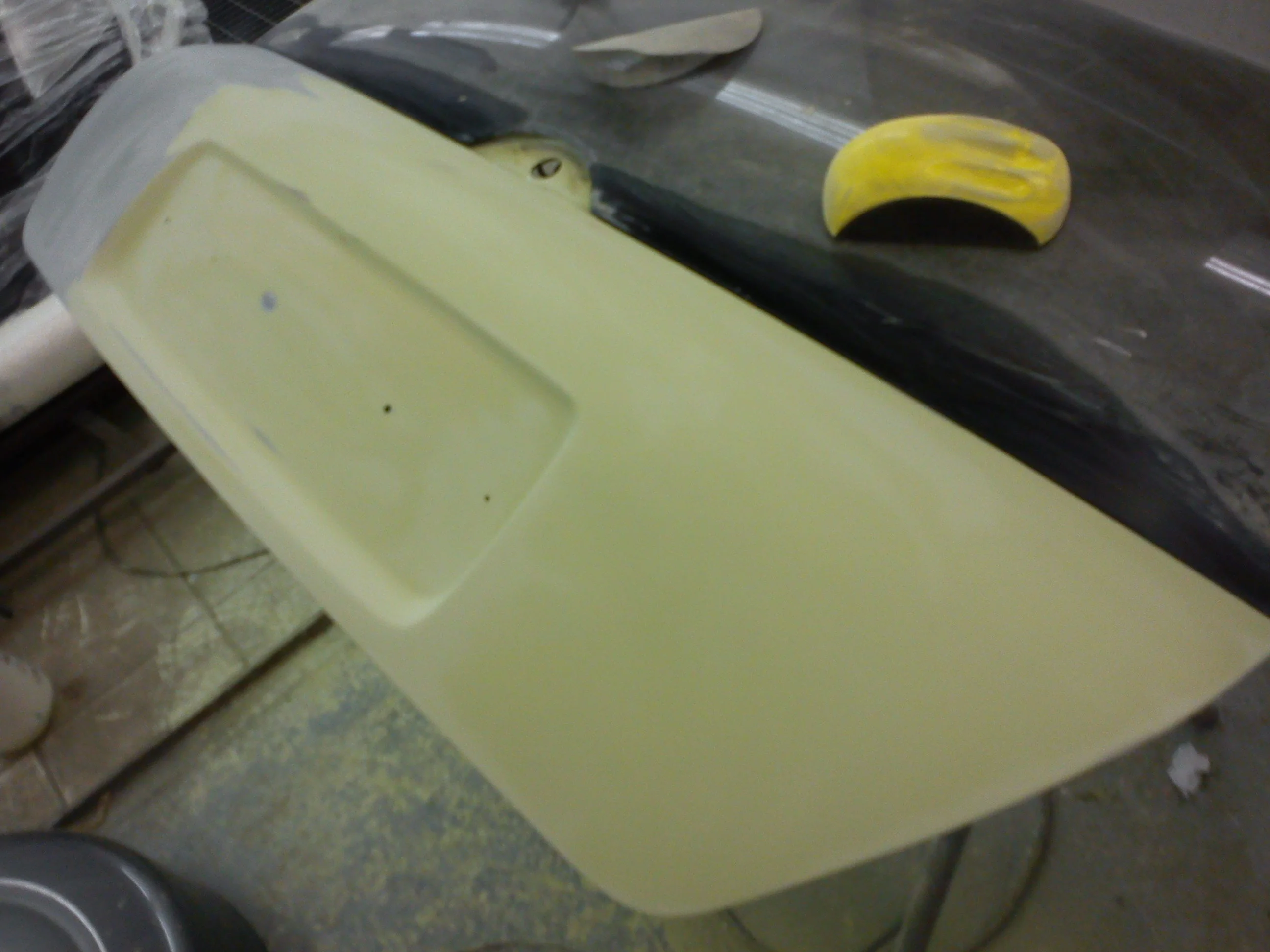

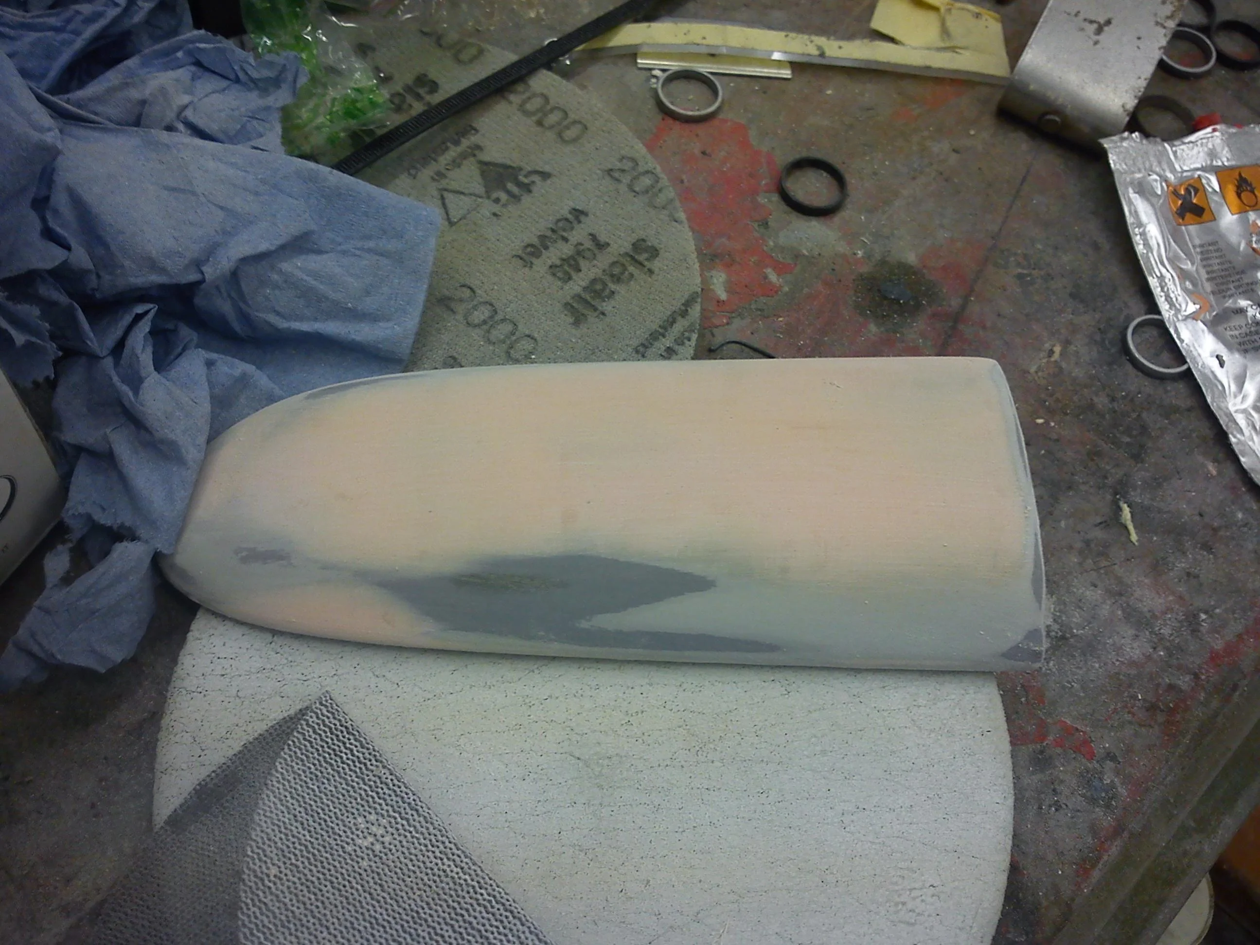

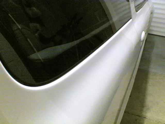

Just finished flatting the passenger rear wing and boot lid, 4 layers of laquer, flatted with 1000, 1500, 2000 then 3000..not that it need flatting!! no orange peel or crap wot so ever!! but now its just immensly smooth!! its unreal! its like glass and you can perfectly read my phone screen of it :)
Its a total rep hehe, it should be pics of an engine conversion but the doner car guy pissed me of, so I painted it instead, engine will go in one day just rather make it look fecking awesom in the meantime..yea the booth is good, best thing of all is its cost me the price of a night out to paint my car :D but the quality needs to be seen to beleive!!

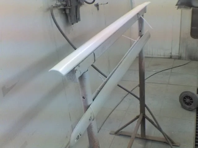

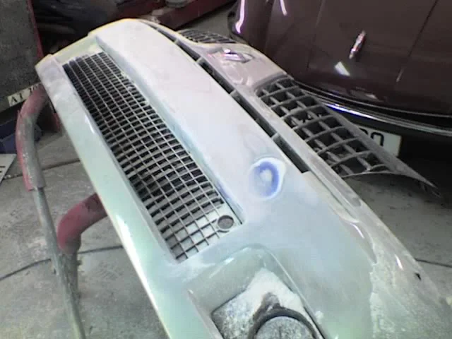

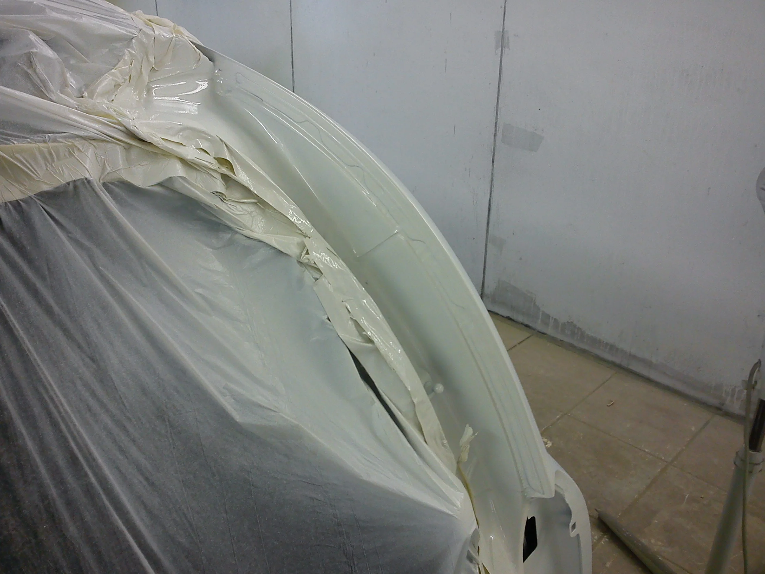

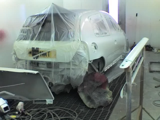

bonnets ready for painting tmro, bumpers almost ready for priming :)
almost finished :D

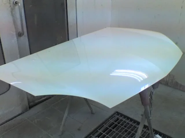

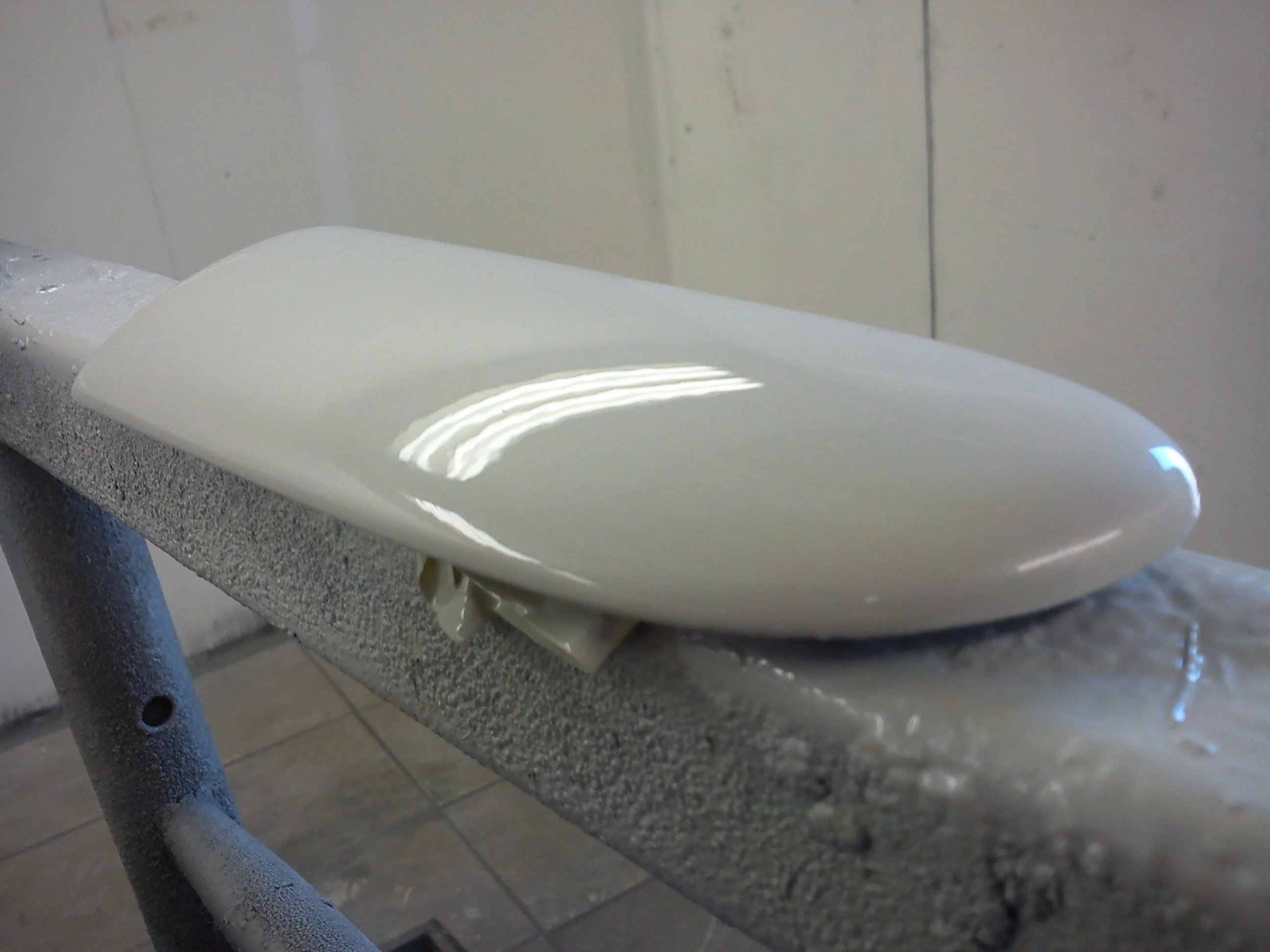

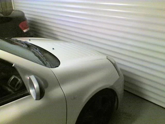

Just painted bonnet, looked really good, untill the paint reacted FFS :@ be re-doing that again in the week :( gonna go flat and polish the drivers side to cheer myself up lol,and polish and wax it with my new products :P il take some pics, front bumper still silver till next week
Bonnet looked awesome, wouldnt even need flatting, then during bakin it bubbled up grrr, I guess the pearl wasnt ready for the laquer yet :@ Oh well will be done in few days lol :(

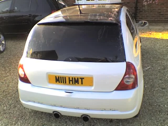

Need new roof bar thingys, slightly bent mine, want perfect ones tho, again the pics are crap quality! old phone :/
