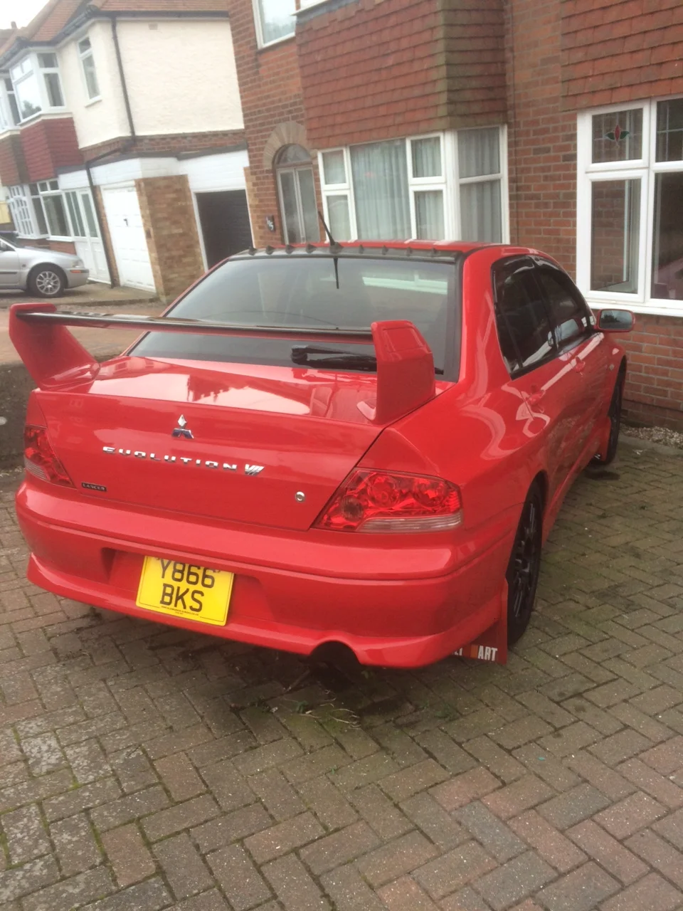

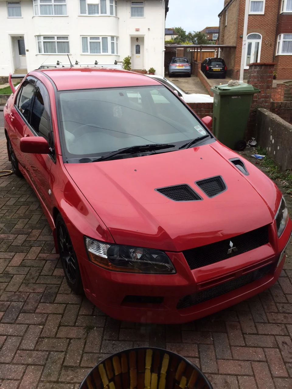

So After parting ways with my partner/wife of 11 years - I have some spare time on my hands!! only right I got an evo... Theres a list of cars I've always wanted to own e46 M3 which I ticked off last year and an evo. Not a great fan of 7's but nothing a pair of 9 bumpers wont sort out.
Its always good to hear opinions and views and maybe some guidance... plus everyone loves an evo
im new to evos, but haven't gone into this blind and know its going to cost me! I would like to run 500bhp as I believe the engine I have purchased is good for it. I don't really want to start upgrading the diff etc if its going to be silly money but we'll see.
Spec as it stands -
No engine - had a forged lump in it but a piston or 2 came out the side of the block.
3 inch exhaust and downpipe - custom
evo 9 headlights
carbon vortex
Some type of carbon rear spoiler - not sure whether its standard or not, only the horizontal part is carbon, unless the rest has been painted
samco hoses

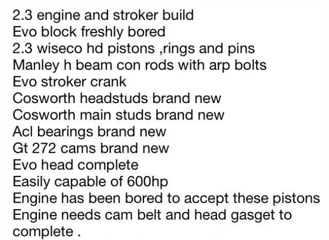

2.3 Stroker - purchased - awaiting collection as per pic below

Welcome back. The spoiler is standard btw.

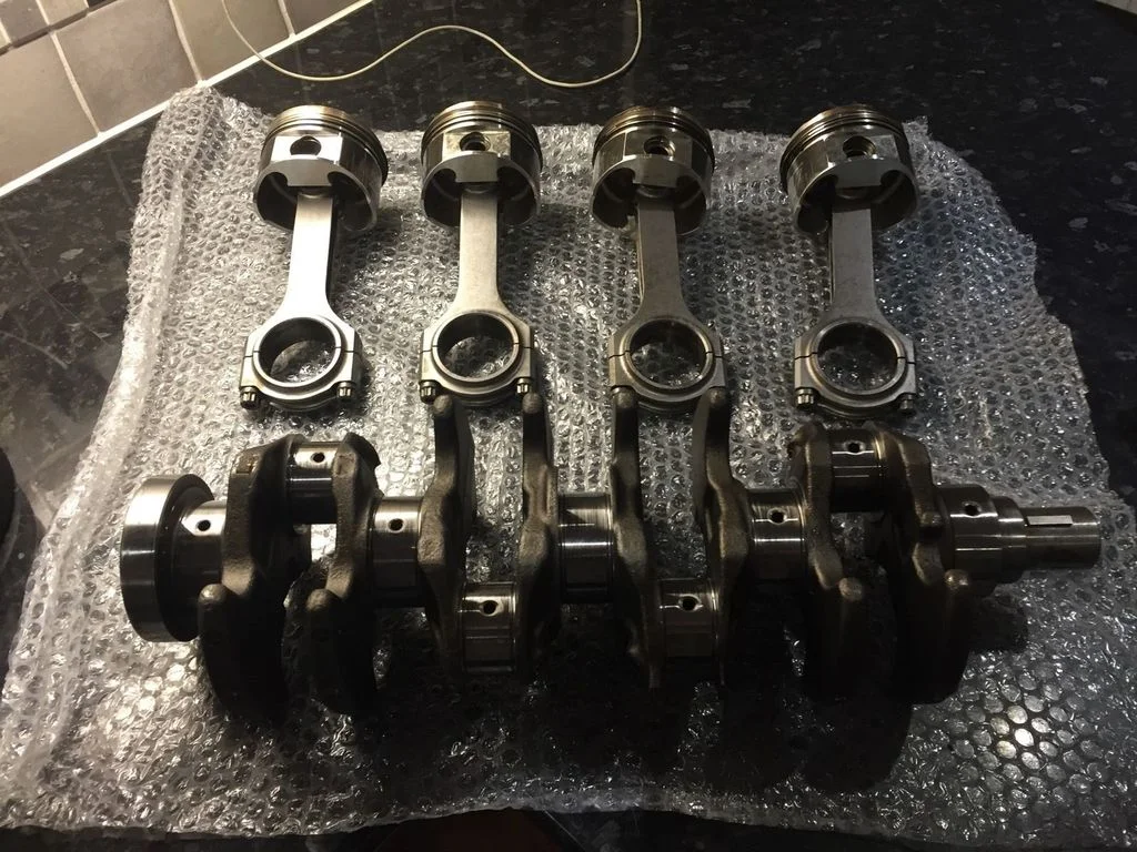

I took a 420mile round trip Thursday evening to collect my stroker engine...

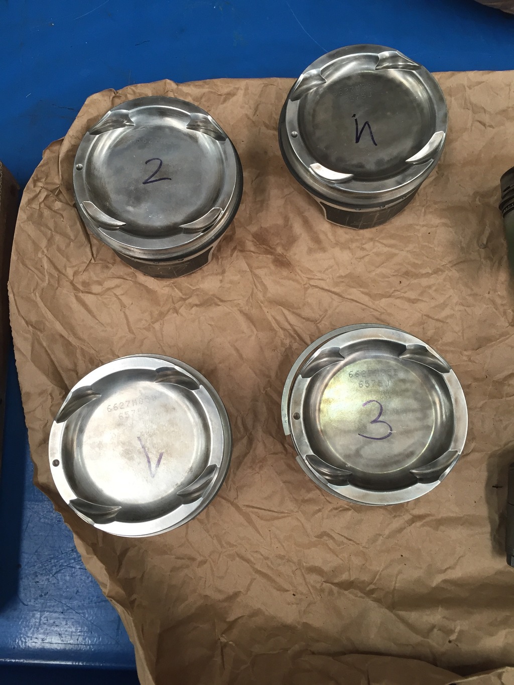

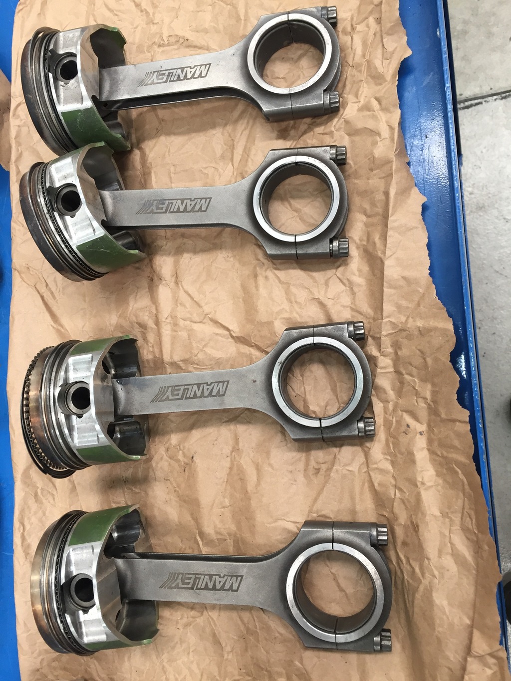

So this was the initial set of rods etc I bought for a 2.0 forged build....I have just taken deposit on these due to purchasing the above stroker kit

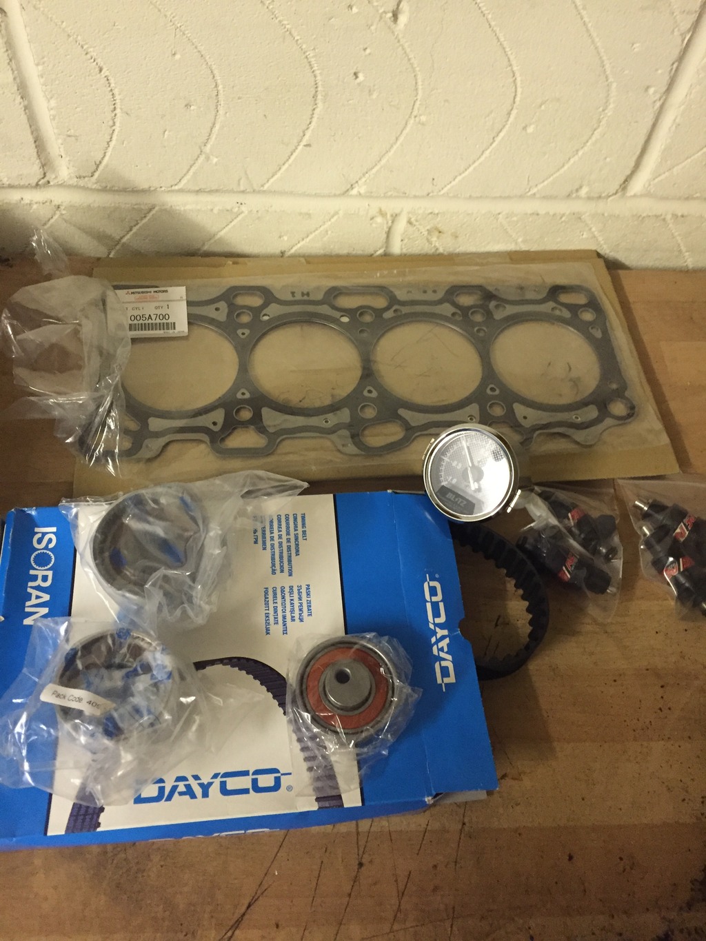

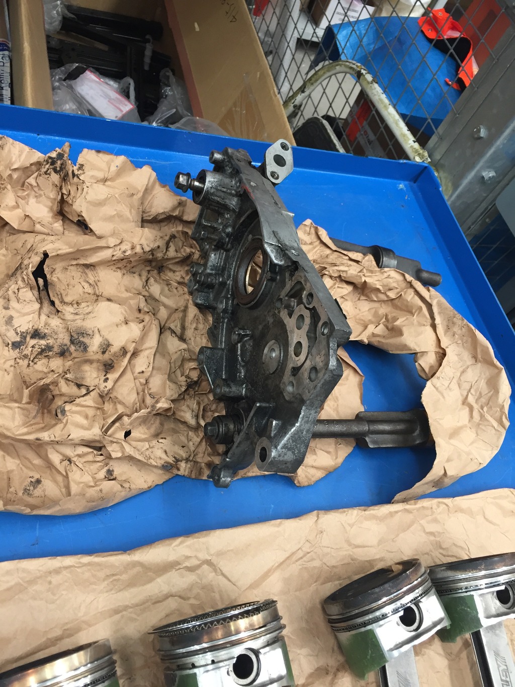

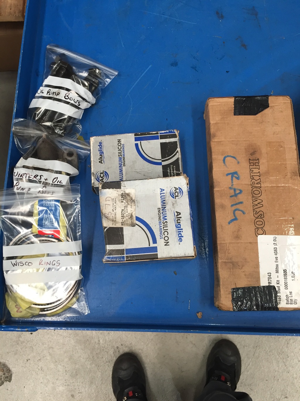

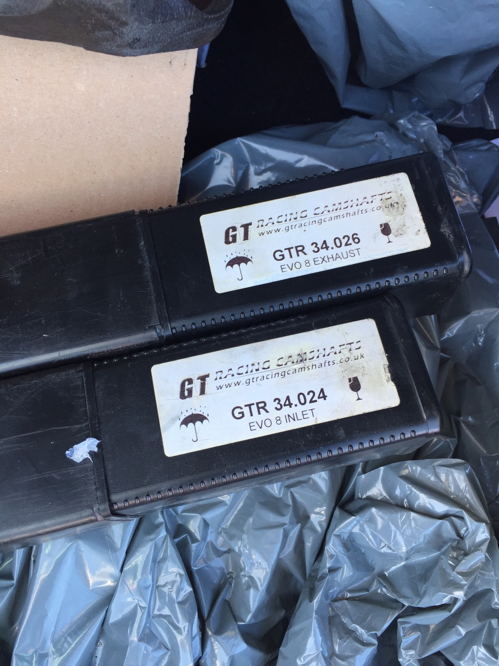

parts of the new stoker kit - Block, crank and head are in the car... just need to find someone to assemble it.
Oh and a set of 1200cc injectors.
