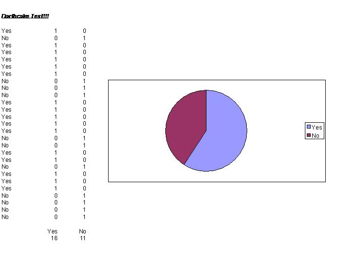

I am trying to create a graph from some verticle data.
In column 1 I have 1 answer on each row, either yes, or no, for 27 rows.
Looks like
Yes
No
Yes
Yes
Yes
No
No
Yes
etc... etc...
I'd like to do a pie chart to show all the Yes's and all the No's but I can't work out how to do it.
Help!
Thanks
There is a graph button on the toolbar, then it opens up a wizard for you, where it will ask you what are the values for the y and x axis, then input values. After you finish you can change to pie chart or whatever graph you want.
Vince
Playing about with the database functions in Excel is a pain in the a***...so try it this way...
In a 2nd column (cell B1) enter =IF(A1="YES",1,0)
In the 3rd column (cell C1) enter =IF(A1="NO",1,0)
At the bottom of these two columns, put a heading (Yes/No) and a total - that'll give you the graph number/ratio/data that you'll need for the chart wizard to take effect.
The reason it's greyed out is you're only selecting one set/column of data, and it doesn't know what you want to do with it.
Nice one Mark. How annoying is that! :) Have a nice fat pie chart now :) exactly what i needed for my report. ta bud - must catch up soon when I pick up the new beast.
