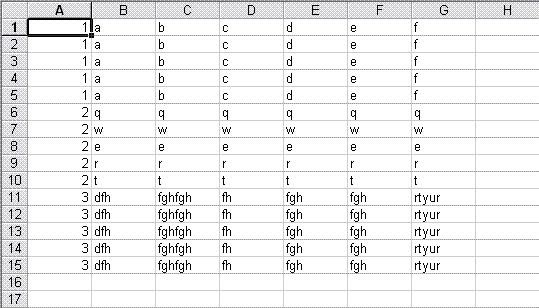

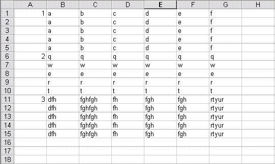

Before: how it is currently
After: how I want it
Look at column A, I need a formula that I can just paste in/fill down (not pasting into each cell as that would be no different from just copy/paster and take forever) that will populate the blank cells. Hopefully that will make it a bit clearer...

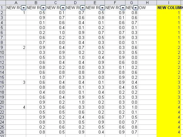

Type this in cell i2, then drag down:
=IF(ISNUMBER(A2),A2,I1)
There is no easy formula way to do it within the same column, unless you use visual basic.
