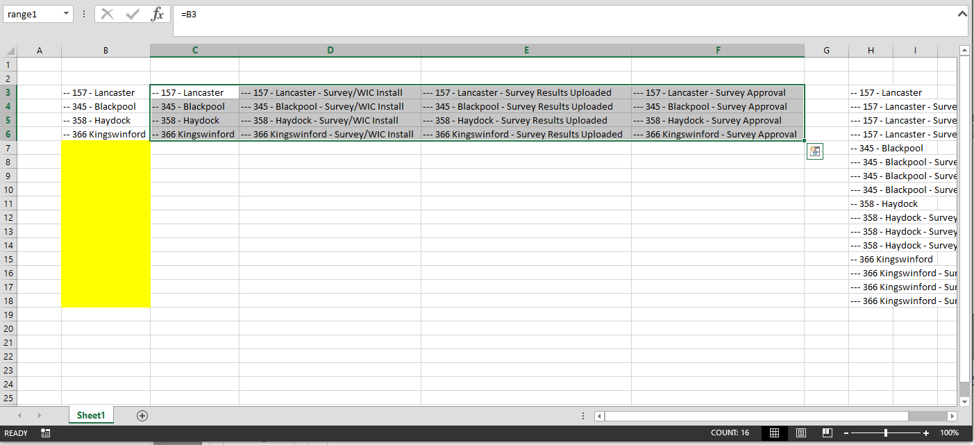

Try this, I've uploaded a spreadsheet with an example set, but what it does is use string manipulation to create a single row with 4 columns - one each for the survey bits and one header. We can then define it as a range, and use a transpose function to then convert that into a single column with multiple values.

What's going to be the easiest way to get the columns populated with the site name and code that changes each time?
If you copy+paste the site names into column B (yellow), then highlight the formulas which generate the sub-sections, and in the bottom-right corner hover over the square it'll change the mouse to the fill tool - this fills sites as you drag it (double-click for auto-fill) and changes the cell refs automatically.
Once that's done do the same highlight+fill on column H to convert the rest of the range to a column.
