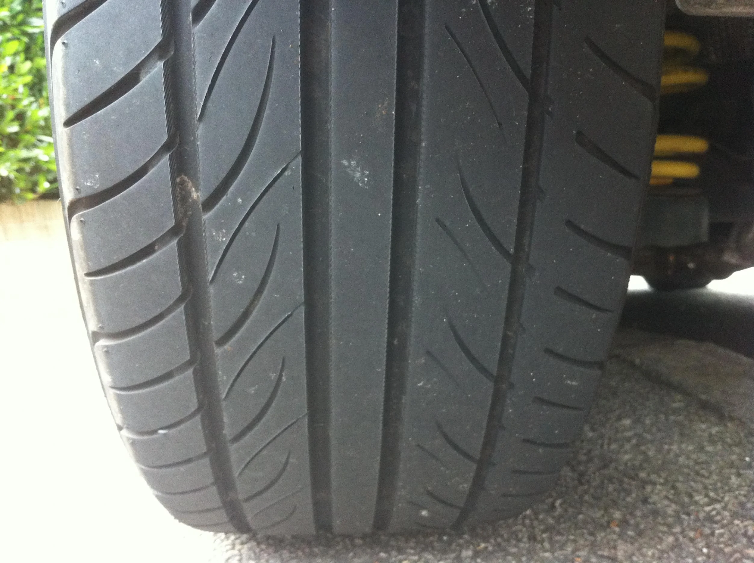

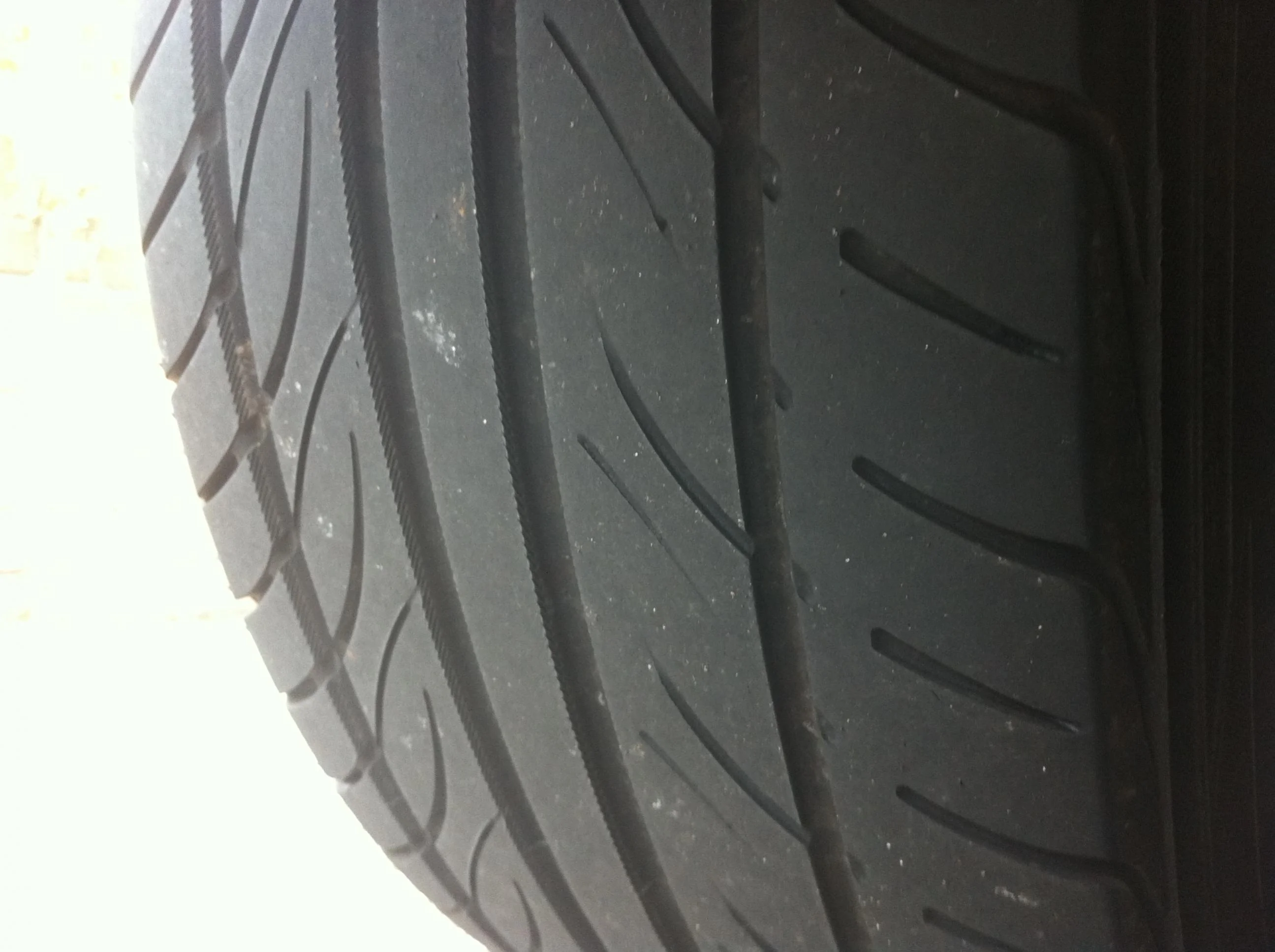

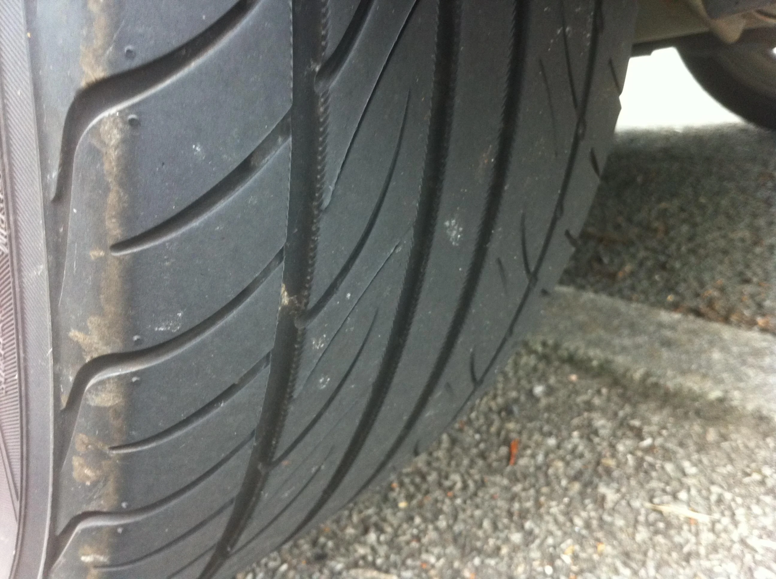

I had my car on a ramp and noticed the inner 2-3” of the rear n/s tyre is wearing really quickly... visually there seems to be more -ve camber on that side. Nothing seemed obviously bent, and no leaks on the shocks.
The tyres were new in Jan, when I fitted new wheels, and I do not remember there being uneven wear on the previous tyres.
I haven’t changed anything except the wheels, and am just wondering what the best course of action is...?!
The wheel bearing is making a very slight noise, but nothing major... and I have not hit any curbs etc. (plus it’s added –ve camber, so unlikely I would have thought?)!
The only thing I can think of is hitting a speed bump slightly too quickly with luggage in the back, and possibly 1 or 2 pot holes... could this have bent the stub axle or could it be more serious?
Thanks in advance
And here are some pics:

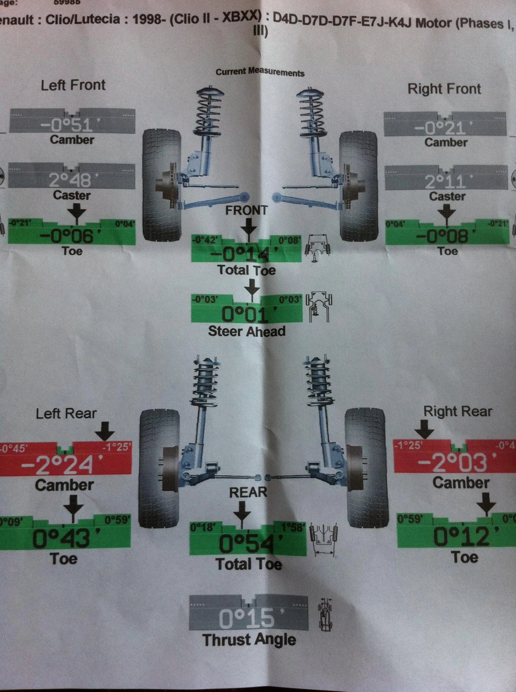

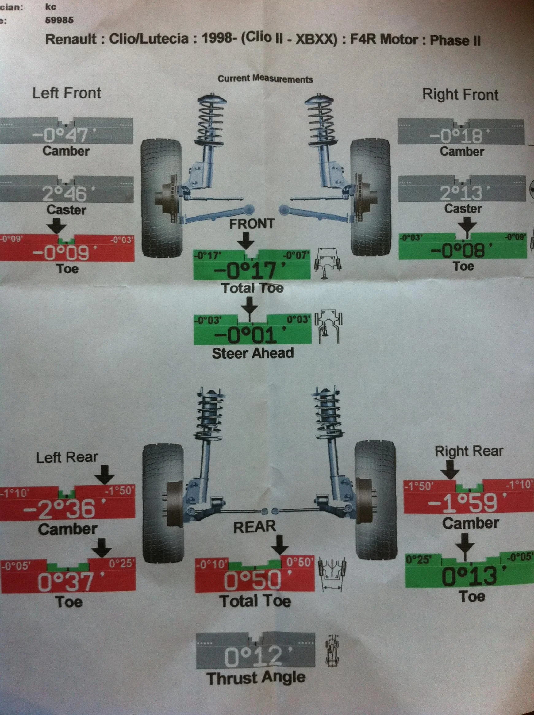

Right... Had the alignment checked (twice), and there is an average difference of 29 minutes more negative camber (on affected side), and 26.5 minutes more toe.
Here are the results:
So, I take it something is bent (although there was roughly the same additional camber on the front n/s)?!
The chap at ProTyre reckoned on the stub axle being more likely than the beam... does this sound right?
