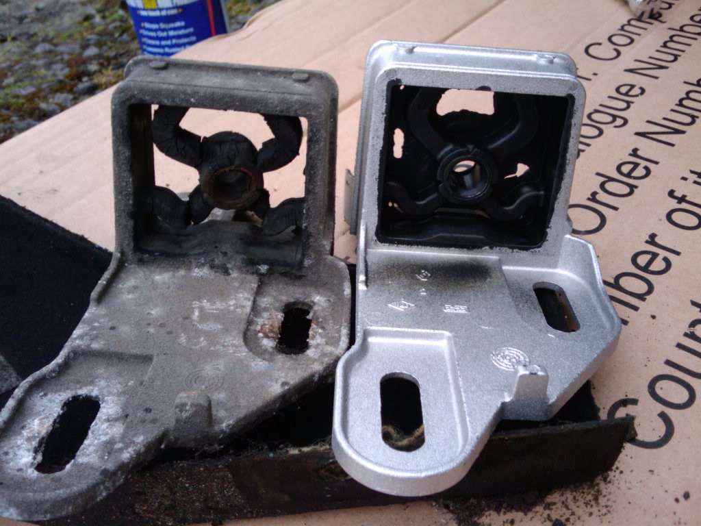

Hi, My exhaust has just started knocking tonight at low revs and setting off.
From in the car it sounds like its coming from the back box area
Could this be down to the cold weather or are the mounts knackered?
Cheers
It's this one at the back you might need to change. The rubber perishes and just falls to bits!
Nope. Been working on an insert for them though.. Found some polymer 2 part mix that could be added to the bush to man it up a bit! but its the vibration issue...
