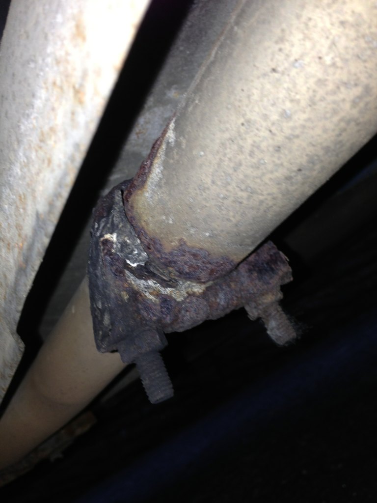

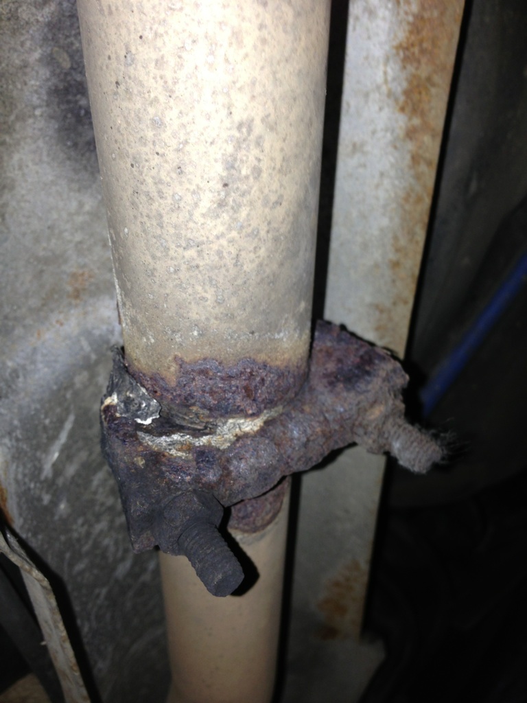

Just came home from a drive and checked under the car after a friend said my exhaust didn't sound too good, and this is what I see.

It's the connection before the backbox.
Guessing I should just get a new exhaust not just a backbox? :s

or cut the section out and fit a piece of pipe in with two clamps
You'll be chasing that forever and some anal Mot's will question it if's blowing slightly, just go for a new cat back, yes it's £400 tops but they normally come with a lifetime warranty for first owner, also it shouldn't have 2 sections already if it's standard they are always one piece out of the factory, brackets holding it just do not last, hence why I have a scorpion now.

My friend suggested using some gungum stuff to just plug the hole that it's blowing from, which just seems like a temporary fix to me but he's adamant that it will be fine.
