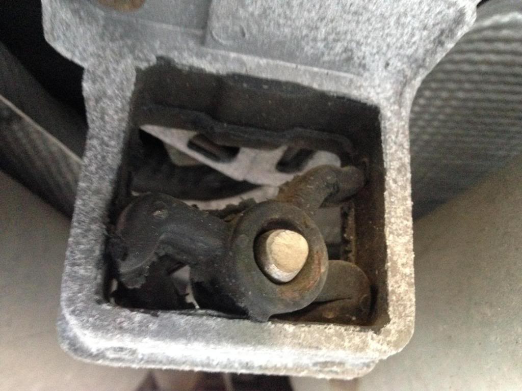

Noticed my RS192 had dropped at the back, im guessing this is the problem!
Anyone recommend the best way to sort this out?
Take your pick!
Theres a trick using an old socket, there's powerflex universal mounts that can be used and also prima racing do a cracking exhaust mount.
Get some Powerflex EXH008's. They will last and you can get the exhaust into exactly the right position. ECP's do them or eBay for around £6 each. I bought replacement genuine parts and they lasted about 4 months, don't even know why Renault bother making such garbage!
